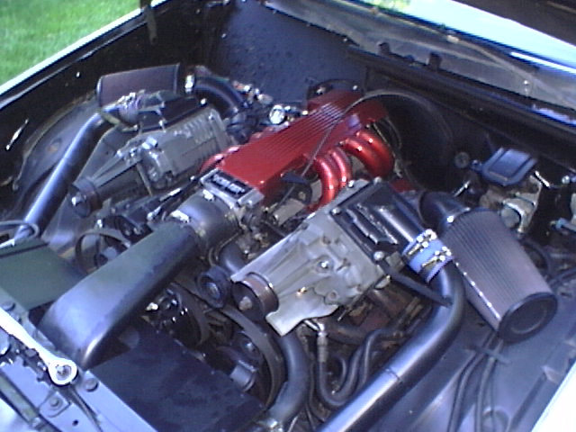

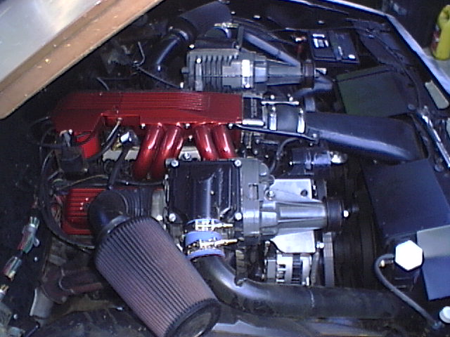

yeah how do saturn5's superchargers work. They look like they act as cylender heads. The pics of the engine bay on his site wern't working so i couldn't see very well.

I'm rearranging my site.. so most of its all wonky.
I finally toasted the 305 late summer, just getting a replacement together now. Some changes from last year.. TBA.
[img]
https://www.thirdgen.org/techbb2/att...postid=1382894[/img]
[img]
https://www.thirdgen.org/techbb2/att...postid=1382892[/img]
some old pics.. BW
