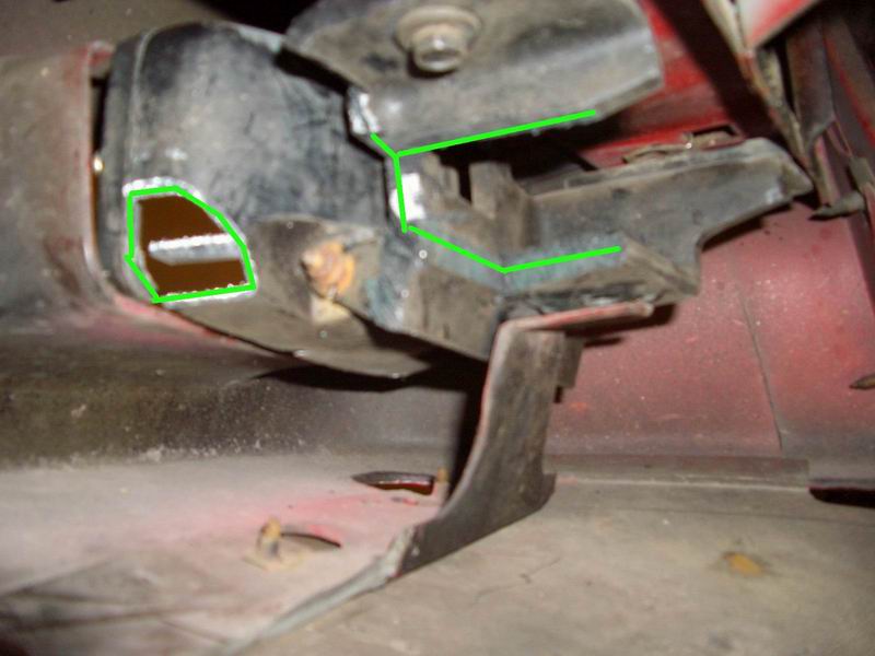

Alot of peolpe had/have trouble with installing a ATI 3core IC on TA's/firebird. This shows how I did my installation.
1. Not doing any mods my IC had to be mounted to the left and not centered.
2. The IC was to close to the radiator and was blocking of the air passage.
This was because the 2*45 deg pipe on the IC outlet was hitting the fog light.
1 picture showing how I grinded the foglight house and the fog light (plastic)bracket, I also had to cut some plastic below.
Attached Thumbnails Ati Procharger 3core install Firebird Trans Am-c-documents-settings-niklas

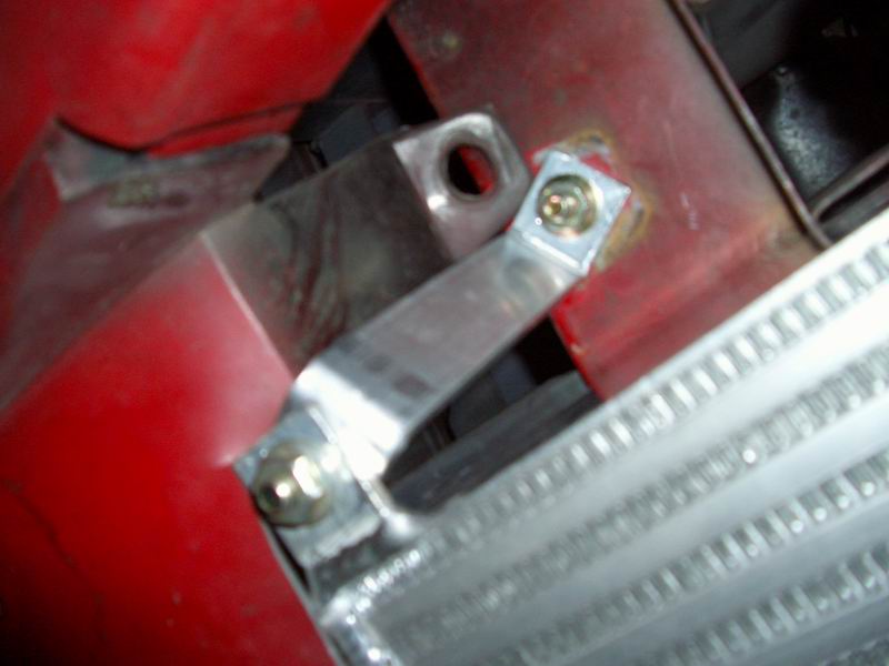

5. Center bracket.

6. the IC...........
I had to cut some plastic off the front along the IC that was in the way.......
/N.
