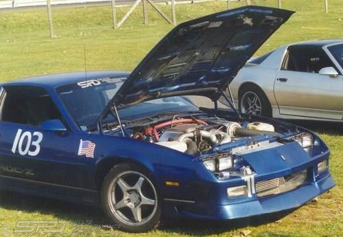

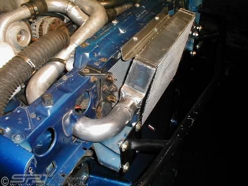

I've got mine in front of the radiator, tipped forward. The bottom edge is about an inch or two fwd, resting on the bottom of the frame opening, while the top has a good 8" clearance.

Just a nice open front-shot through the front valence. Too much air makes it through there, and makes the front of the car wander at high speeds. I no longer have a radiator lower air dam, either. On the list of things to do is modifying the hood to extract that air, possibly tilting the rad forward with the IC.
The lower valence supports are just along for the ride, but could be dzus'd to the radiator/IC shroud.

thanks man......i basically duplicated you're front bumper support this afternoon already and built a trick little set of intercooler mounts......i just painted the pieces and hopefully i'll assemble them and partiall put the nose back together tomorrow.
