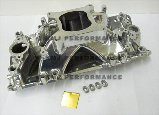

round 2 of mods begins, the tpi intake and 65# injectors are comming out and are being replaced with this
and 120# injectors
Old Jan 5, 2012 | 02:20 PM

how good is a 3500-75-- manifold for everyday driving ? do they drive horriable or are they just a slug unti 3500 ? mines a dd but i'm in the higher rpm's alot but my wife drives the car also so it has to be sumwhat easy to drive .
Old Jan 5, 2012 | 02:50 PM

how good is a 3500-75-- manifold for everyday driving ? do they drive horriable or are they just a slug unti 3500 ? mines a dd but i'm in the higher rpm's alot but my wife drives the car also so it has to be sumwhat easy to drive...
He'll definitely try to match that intake with the right camshaft and stall speed. Doing this, the car will essentially drive normally... until you stab it of course.
it wont be bad at all, basicly with port injection u can get away with the low velocity at low rpms because the manifold is only flowing air, so there is no fuel to drop out of suspension and puddle on the intake floor.
so the intake will have a wider powerband then if it had a carb ontop of it

Send me over that lower TPI intake Dave, and I'll open it up for you. Save your money bro...
lol i could do that myself im just tierd of the tpi intake, though we will see how good it does on the 27th
im heading to vegas on the 27th for dyno and to hit las vegas speedway, the 27th is there first midnight opening for the track

Axle/Gears: MWC 9” 3.00
Re: 89 Iroc - 355,twin gt35's,megasquirt
See I was reading about them on another forum and some of the "top" guys talked alot of crap on them. I've never seen them or what not, and remain skeptical until I do see setups using them. I always liked the idea just not the price tag Good luck with your setup, i'd be very interested in seeing how that turns out.
