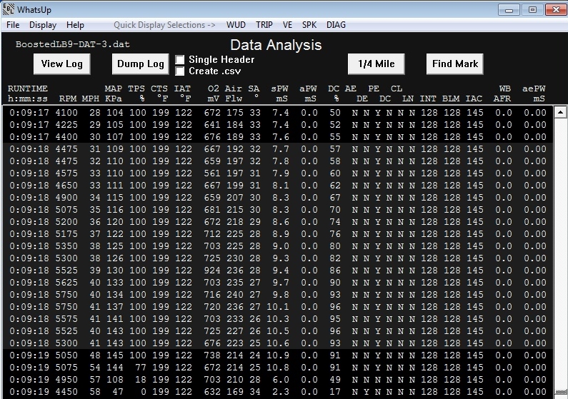

Today I had some time in between BBQ's and figured let me get a datalog. Not even thinking straight, as the SA table was off in the 100-KPa area, and timing was pulled down way before hand. Lost another check valve in the process, damn thing went flying about two blocks once I was about to hit 2-psi, so I just let off the throttle. You can see where the SA is hovering right around 113-KPa (1.95-psi), it is way too low for not even two pounds of boost, should be right at around 30 degrees at that point, instead its at freaking 18 degrees. Just went into the boost tables and corrected that, but I won't go for another datalog until later tonight though. IAT's are high because I had the engine idling for awhile before driving, and it's freaking in the 90's today...

You can see where the SA is hovering right around 113-KPa (1.95-psi), it is way too low for not even two pounds of boost, should be right at around 30 degrees at that point, instead its at freaking 18 degrees. Just went into the boost tables and corrected that, but I won't go for another datalog until later tonight though...

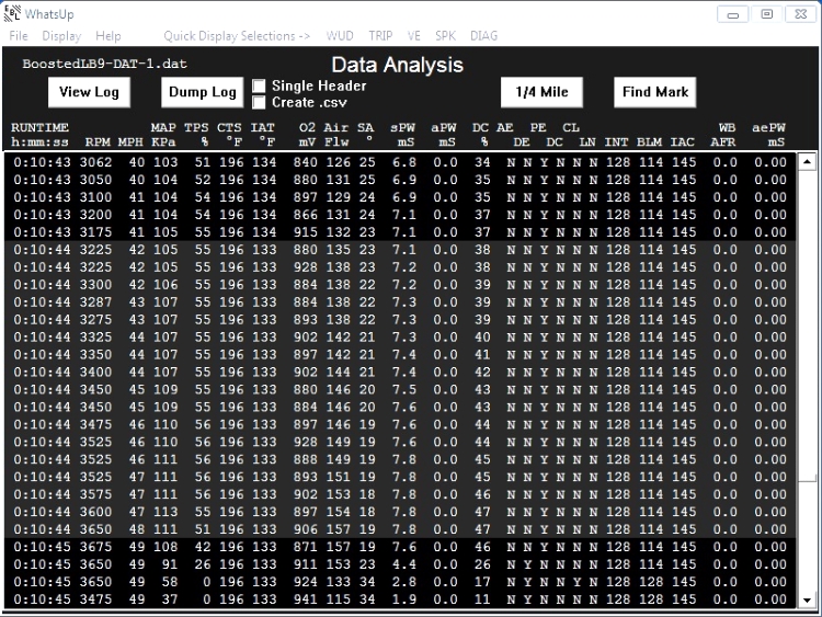

Fixed...

145-KPa (6.75-psi), O2's too low, Injectors almost pegged. Need to put those larger injectors back in, and to raise the VE a tad. Spark advance seems better now in boost. Disregard the battery up front, having minor issues finding an area in the back that I can agree with. Don't wanna put a kill switch back there either, but I have to, eventually. Traction is not there, brakes don't hold for anything. Video and datalog below, IAT's are high because idling for awhile...

I'll put things into perspective for those who don't know what they are looking at. At 143-KPa (6.45 pounds of boost), the duty cycle was at 96% (with lean O2 reading as well), just about max capacity for these 30-lb injectors I am playing with. This puts FWHP at approximately 385 at 6.5psi, but I can't raise the boost because the injectors are too small and are pegged. Now, I have another set of injectors that are rated at 60-lb's which are going in next, and at 80% duty cycle, this should net me around 650-FWHP, and if I max them closer to 100%, they will put me closer to 800-FWHP with boost pressure being somewhere between 15-20psi. Not bad for an anemic TPI-305. Nine second time slip will be here in the next month or so...

My 36lb injectors started to max out when I had that 15psi boost spike, duty cycle at 9.5psi is now at a max of 44% on my duty cycle, though I think it was the fuel pump and not the injectors. Fuel pump will be the next thing getting upgraded.
Looking good though, sounds like you'll make some pretty killer power with that 305. Sounds pretty good too, I like it. Ill have mine tuned soon, just gotta renew my license so I can drive and tune though.

My old turbo 305 setup pegged the injectors at around 12-psi, 28-lb injectors, with bigger valves (1.96), 218/218 cam, and similar TPI setup. Now I am pegging larger 30-lb injectors at half that boost pressure thanks to an even bigger cam and lot of head work (smaller 1.86 valves). Also, the GTA should weigh closer to 3000 pounds (w/out driver) when all is said and done, so if Justin keeps that Iroc of his at that 3700-3800 pound mark, I just may call him out for some fun runs...

It shows 240 gm/sec which is 31.7 lb/min. 31.7*10 = 317 FWHP.
Your injector DC probably takes into account open/close time. If so, that means you are assuming full fuel flow at those points which is in correct. The track will give you real HP numbers. Taking a long time to get that ECM tuned though. Why did you undersize the injectors when you had better ones to put in?

Grams per second? Am I running a MAF sensor? I am well aware of my wideband readings despite not being embellished in the EBL WUD, so I know exactly how much fuel I am burning in conjunction with where my KPa is reading at that exact moment, and MAP readings and fuel consumption do not lie. Appreciate the response though...

Your ECM is measuring airflow. No need to install a MAF too.
What it the equation you are using to convert WBO2 AFR to FWHP? Maybe some parameters are estimated different and that is why your AFR HP estimate doesn't match your ECM Airflow HP estimate. Best to use the track in the end.

Junk, I appreciate your thoughts, but I know all this already. I mentioned above I will have my slip to my goal in the next month or so, and I am periodically keeping this thread updated to let everyone know where I am with it. Patience...
