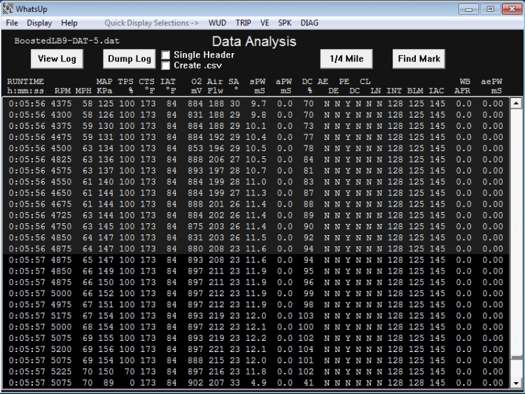

Took it for a quick blast down Route 9, running an 8 pound spring by the way. Was cruising in overdrive, floored it, trans downshifted of course, and it felt very very good, pulled extremely well. Duty cycle is down of course at 8-psi, whereas it gets pegged in first and second gear. IAT's again high because she was idling for awhile before this datalog, not to mention 90+ degree day...

What iat you using and where is it located?
I have two, the stock one (CTS) is still underneath the plenum and is hooked up, but I also have the birdcage IAT before the throttle body under the tube, not hooked up yet because I still have to extend the wires to reach it. A few inches before that birdcage IAT is the alky injection fitting. By the way, post up some pics of your new toy. Gonna be sweet to have another boosted 305 on here, as Dave (TwinTurboRoc) is missing in action...

Get the bird cage one running! Its ten times better than the stocker. Stock one gets heat soaked and doesnt react fast.

I am surprised that 700R4 isn't junk yet. I ballooned two stock converters at 10 PSI with a bone stock 150K mile 1986 305ci TPI at 10 PSI (daily driver). One converter lasted 300 miles at 10 PSI.
Since ya are running on the street, what does the 1/4 mile button in the WUD report?
Yes, stock IAT is way too slow. Install it in a place where it makes sense relative to your ECM tuned IAT tables.

Injectors are in as of last night. Changes to the bin have been made immediately after, and the VE continues to make changes while in Learn Mode. I know you guys wanna see a 1/4 mile blast in the WUD, but I have to make sure the fueling at 100-kpa is dead on first before I make changes to the BST tables...

Stock setting in the LB9 bin for IAC - Gain is 12.55% for both Park and Gear. Was getting some hesitation in the idle for about a second or two when switching from Gear back to Park , not Park to Gear, when the larger injectors went in. Went in and raised that 12.55% value 30% more, just under 17.00% for both Park and Gear. The hesitation from Gear to Park is gone, but then the RPM was overshooting (not oscillating, but hanging too long, not settling down fast enough), so I lowered those two values down to 14.00%, and now all is good with the idle transition both to and from Park/Gear. Not sure if I should touch the IAC - Gain Breakpoints, though...
Transmission seems fine. Not saying it will last forever, as it will give up the ghost whenever it decides to, but stop saying that its going to for crying out loud already, I know that it will lol...
yes it is and the funny thing is its nicer then the holley , out of the box both are the same , but the procomp one can be ported further, and the fabbed plenum is nicer then the holley cast plenum
