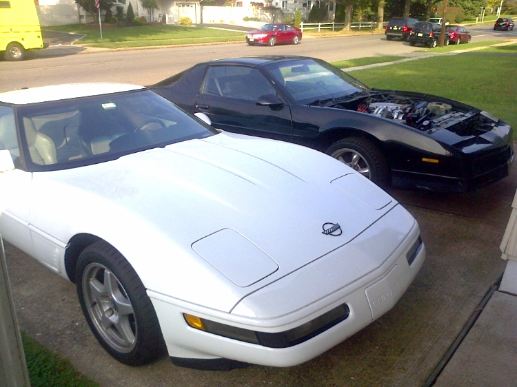

So much for my ThirdGen.org brethren giving me a push, had to get the needed incentive from my Grand National brethren instead lol. Went to the track late last Wednesday night and met up with some buddies, and one of them ran his first 9 second pass with a much smaller turbo than I am running, not to mention two less cylinders, and much more vehicle weight (see below for the video I took of it). That was the push I needed to bang out the GTA, cuz its time to show those Buick guys how its really done...
Downpipe is done, Wideband O2 sensor bung is in, time to get this fawker finished...

Bout dang time lol ....is that o2 sensor not gonna ge a bit warm right after the turbo like that? I always heard to keep the WB a couple feet from the heads ... Idk much about turbo setups tho ... Jw I'd hate for u to burn up that high $ sensor lol
Edit: next time someone asks "damn what u got under the hood " b like " just a little 305 with a really big air conditioner" lol

Good eyes! We'll see what happens, as I was having this debate with the XFI guys as well. They're (XFI) O2 sensors are made to withstand the excessive heat, whereas the Bosch sensor type are recommended to be at least 30" - 36" away from the turbo. If the sensor goes, I'll slap the NB in that spot because the EBL-P4 can switch back and forth, as well as relocate a new wideband down by the catalytic converter location. Converter is hallowed btw. Agreed about the big AC compressor, as my neighbor who is into muscle cars has no idea what she is looking at when she wanders over to look, and that is exactly what I tell her, it's the air conditioning lol...

Got a few PM's about the Corvette, asking about some details and if its for sale. Rather than start a whole new thread on another forum, I'll just answer them here. 90,000 miles, bone stock engine, 17" ZR1 rims, MT 315 ET Streets out back, 275 G-Force up front (all brand new). Looks like it has a catback, but not too sure. Sounds sweet as hell though. D1SC is going in as I write this, and will be tuned by Brian from PCMforless as that is the only option other than installing an entirely different PCM, which I will not do. Only other mod will be a stall speed converter. Will not let go for anything under fifteen grand with the D1SC, Rims w/tires and stall.
Thanks...
