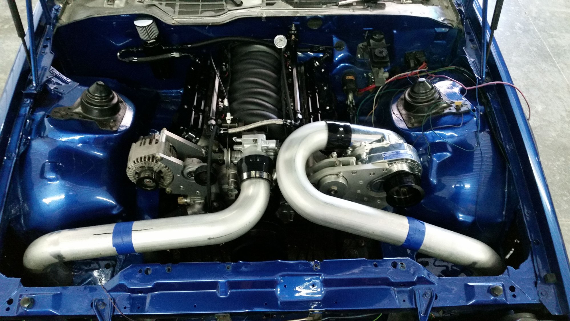

Finally .... got my intermittent belt squeal sorted out! Do you know how troublesome and irritating something so small to fix is .... when you can't find it?! There have been more belt and pulley alignment checks and adjustments then I wish to ever dream of. LOL The issue... two piece alternator bracket. When I first installed, with all bolts in place, each bracket was pushed towards the engine centerline to take up bolt slack, one bracket bottomed out slightly before the other and put the alternator at just enough angle it would intermittently squeal. Holy $817, was I happy when this was resolved!
Now getting to a point where I can see my end goal. WILL be on the road next summer! Going to spend the winter cleaning up odds and ends; then in the spring, a four wheel alignment and then onto the dyno. This last engine build has been a 3+ year journey, I can't wait to heat these up!
Even the 32 year old custom subwoofer project is done!
