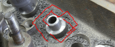

Hi, I've been reading lots of forum for that last few years and I think I have a question that nobody asked yet! I have a set of 062 vortec heads that I what to swap in the 355 sbc.
My friend is teaching a CNC class at the local trade school and he can machine my heads for free! I'm not looking for anything crazy powerwise... I only need to satisfy my power need for a few years before I build a turbo 5.3 L33.
Heads are already magnafluxed. They will be also milled for straightness. I want to run a 0.500''-ish lift cam and not going to rev past 5800 RPM (Stock bottom 2bolt main).
0.500'' cam (Flat tappet)
PRW 1.5 self aligning rockers
Incognito studs
LS6 BeeHive spring
Lap the valves
Push rods (if the length is no longer good)
I know I can get away with some special retainer that I dont have to machine anything (w/ beehives) but I can for free.
Question!! If I simply mill down the valve guide boss to clear 0.500 lift with regular retainers, will the new valve seal fit?
Will there be enough exposed valve guide left to seat the new seals?

If you want to use conventional .550" lift stock diameter 1.26" ish high perf valve springs
EG Isky 235D or like (Howards, Summit, Elgin etc). you have to buy and use a special valve guide boss cutter machine tool. (Comp cams)
It has to match the new valve seals diameter and also cut the valve guide top shorter.
Then you need another cutter to cut the major diameter of the valve seat ID so that the damper in the stock diameter springs fits the spring seat.
Otherwise you have to remove the damper..
Why not just buy the Comp cams 787-16 special beehive size spring retainer.? and the beehive springs.
Now you are good to about 530" valve lift depending on (beehive) spring (1.80" default height) final installed height
eg 1.75" ish. No machining.

Just be aware that cutting the valve guide boss shorter ith stock length valves does increase max valve lift clearance. it also reduces the amount of valve stem SUPPORT by the shorter guide boss.
Just be aware of that.
When I cut mine I did it with the medium diameter cutter set to be ready for the medium size diameter 1.46" ish dual valve springs. (future dual spring upgrade ready)
I run the stock 1.26" diameter .550" springs /retainers on this fine.
Yiu don't need a machine shop. you can cut the guides with the cutter tool in a decent 3/8 drill.
But the Beehive spring/ comp 787-16 retainer method works great for most all hyd and moderate solid flst tappet cams and most all hyd rollers without any guide machining.
.530" range lift. Shim the beehive springs for seat and open pressure as required . leave .030" max lift coil bind height clearance.

let me answer some of your questions.
'' you have to buy and use a special valve guide boss cutter machine tool. (Comp cams)
I have a friend who teach CNC machining, so I could get everything done for free. So if I have the final specs of the boss (width/height) and the spring pad dimension I can get him to do it while teaching students.
''Why not just buy the Comp cams 787-16 special beehive size spring retainer.? and the beehive springs.
eg 1.75" ish. No machining.''
I was thinking of going with the ls6 springs (cheaper than the Comp #787-16) Any reason not to?
''Full length valve guide height stem support vs cut down guide boss''
Is this a common failure point of cut down Vortec bosses?
For running a 0.500'' lift cam... I've seen no machining, ls6 spring (w/ matching retainers), 0.050'' offset keepers (w/ self aligning rockers grind down for cleareance on the retainers). But I dont like grinding away some of the ''self aligning'' part of the rockers...
Would you have the dimensions of the finish product? i.e.
1. Valve guide O.D. (for valve seal)
2. Valve guide Height from spring pdad)
3. Boss OD for clearing ls6 (dont think its needed)
4. Spring pad width
Thank you

Well I'm going to go the 0.050'' offset keeper(crane #99095-1), comp retainer (787-16) route and ls6 spring for Hyd flat tappet with 0.500 lift. I like the idea of having more meat in the boss. Thanks!!

I have never had any issue with Machining down the Original Valve Guides...
(This was a common procedure for older OEM Iron Heads).
The ONLY time I have had an issue, is if the Valve Guide is worn...
In that situation, I remove all of the Original Valve Guide, and Install new shorter Guides for 8mm Stem Valves.

I'm going to try to salvage the oem valves, But I'm getting new guides no matter what.
