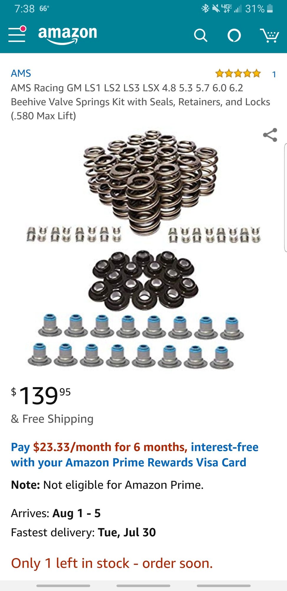

Would these be the same, but all in one package?
Old Jul 27, 2019 | 07:51 PM
Posts: 28,027
Likes: 2,498
Re: Modifying vortec heads
Won't fit your heads.
The retainers, keepers, seal, and guides are for LS valves, which are different from SBC ones..
