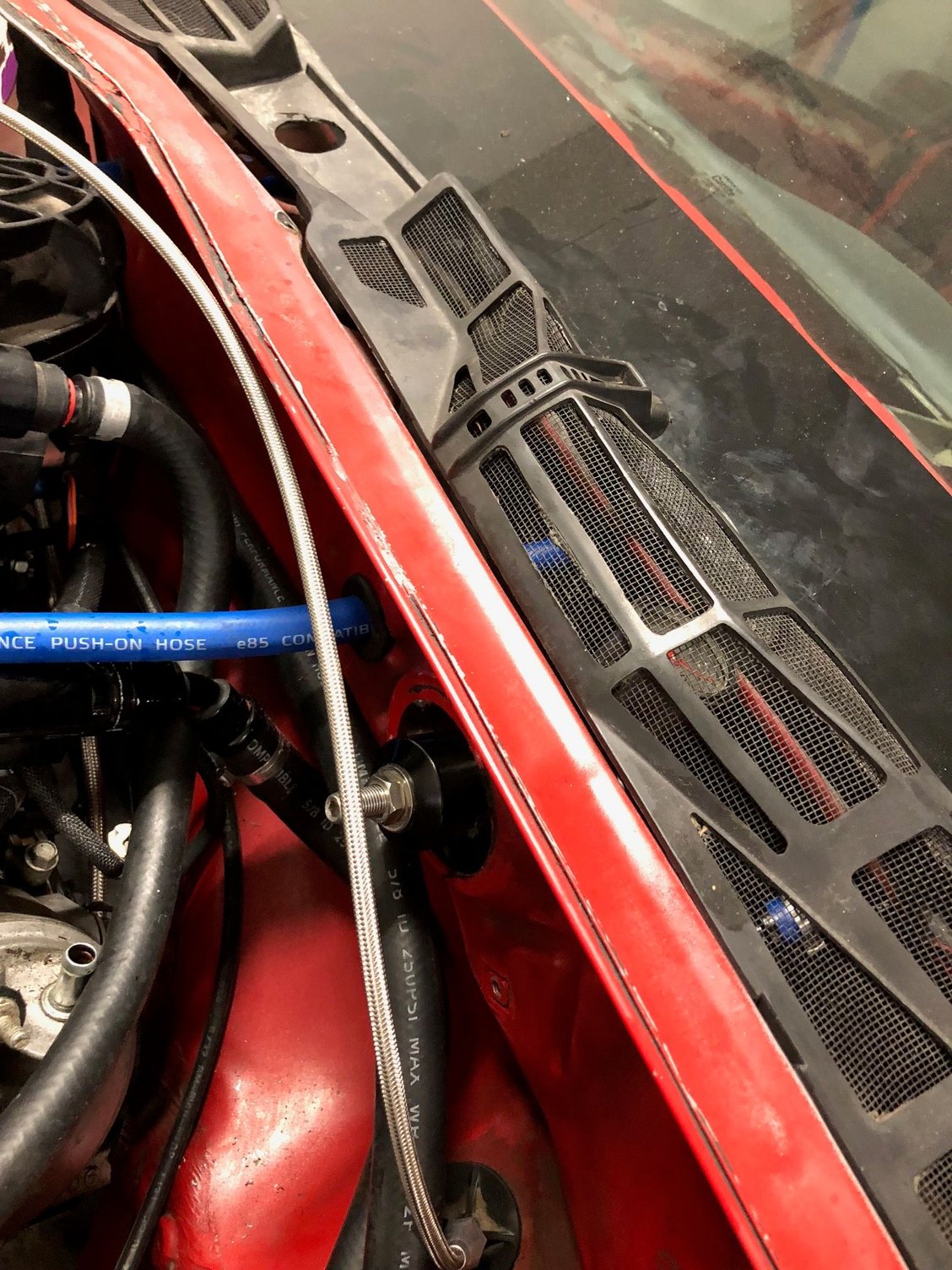

After buying and installing the cx racing ls thirdgen kit I realized the amount of tubing and 3" hotside were not ideal for an s480 that I planned to install... Switched to hooker LS manifolds and fabricated up the hotside, and used the cx racing coldside that comes with thier kit as the intercooler has a great core and it was all 3" piping.
Here are some pictures to give you guys an idea of how I did my kit, with the thirdgen there isnt a lot of room for the turbo to be up very high. I ended up using mostly a 3" 304 ss donut and hacked it up.... Flange is an open t6 from ebay with cnc transition.
VS racing 60mm wastegate and S480 96/88 1.32ar. Setup should be good for 800 tire and mid 4000 full spool. I also re did my fuel system, tucked the regulator up in the cowl and ran lines through the fender well... Not pictured but I did make a shield that covers the lines in the fender from rocks and debris.
The whole front end of the car is hacked up because I will be doing tubular shock towers and front bars when I start installing the cage... the rest of the radiator support will be cut out and the rad/intercooler will be all mounted to 1" and 1 5/8" tubes

Wicked man!! How do those manifolds fit?? Does the cross over pipe fit good to? I'm kinda wanting to get the same thing for my 91. Are you doing a 5" DP or a 4"?

How does downpipe clearance look if you wanted to exit to the stock location without cutting anything? And with the AC box in place. Any room by cyl #8?
You won’t have room to run the downpipe back down on the passengers side above the manifold. It’s a little too tight back there. Car is a 5.3, downpipe is 4”, I would have done 5” but the turbo came with the reducer flange, my exhaust is about 1.75’ long so doesn’t really matter

I am interested to know what that water outlet is on the water pump and part number

Thanks for the info.. Does your exhaust turn out and dump behind the front tire? Always a challenge to run a downpipe on these cars.
Yep it just dumps about 1/4” into the fender
89Formula, do you think the downpipe could be run in the stock location IF the A/C box was not used?

I dont have an ac box and no way you could fit even a 2" pipe down there unless you chopped up the firewall

Could you possibly get a picrure of how close it is to the tire. I want to use this similar setup as a daily driver and I'm wondering if it will heat up the tire. Also do you think theres any way that the pipe could be continued to run under the car?
no problem, Ill post up a few pictures tomorrow. Ive got skinnies on the front but have some stock wheels I need to put back on.

Whelp my garage has turned into a fab shop. Started on cage and front end.
Some me pictures of turbo, exhaust and room behind
