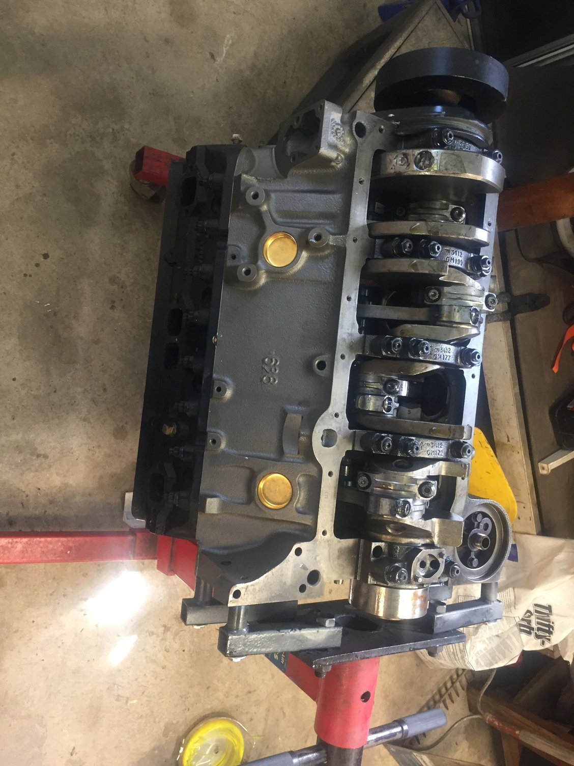

Old Oct 1, 2018 | 06:47 PM
scamaro355's Avatar
Joined: Dec 2003
Posts: 489
From: wv
Car: 92 rs
Engine: 355 stealth ram, dart heads, S480
Transmission: 4L80E
Re: Fuel system
