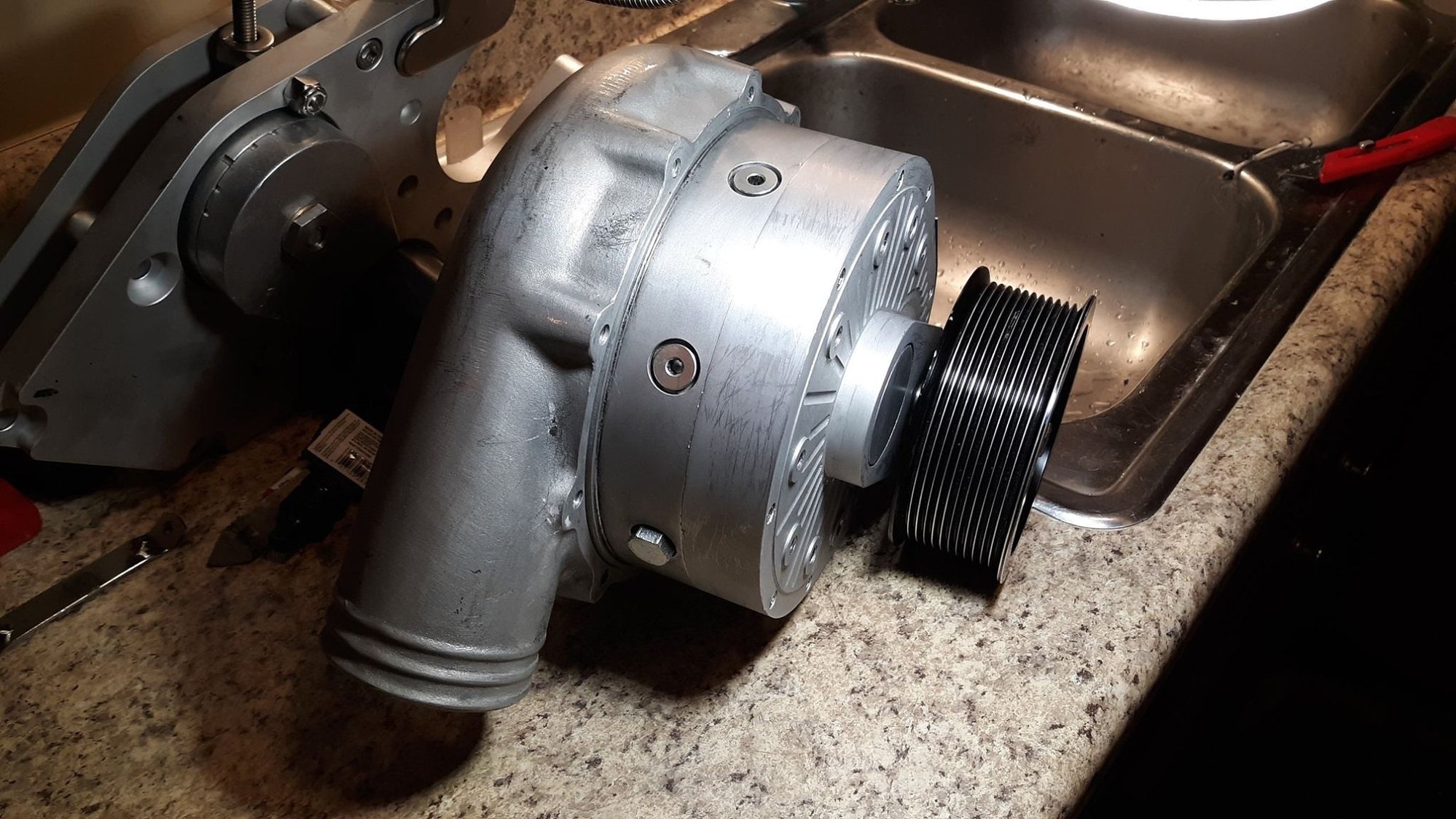

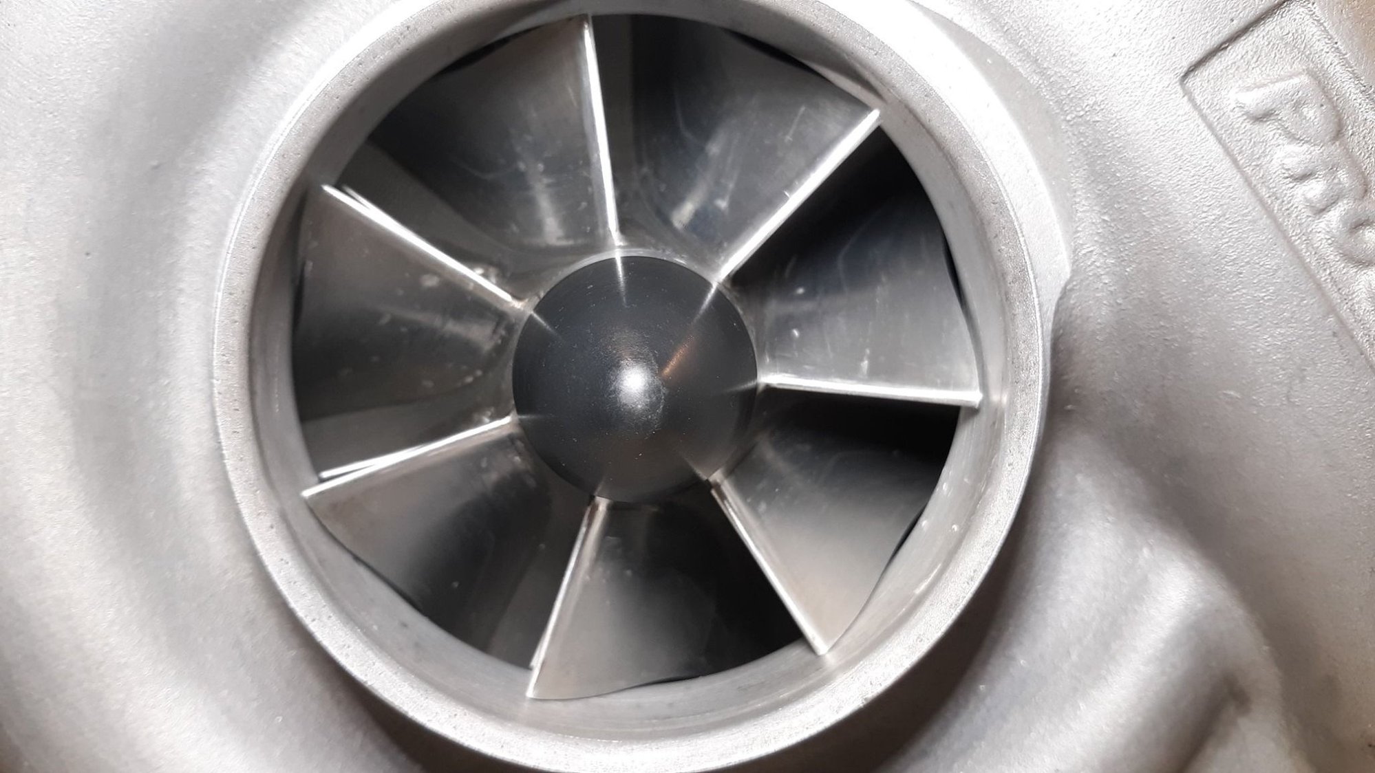

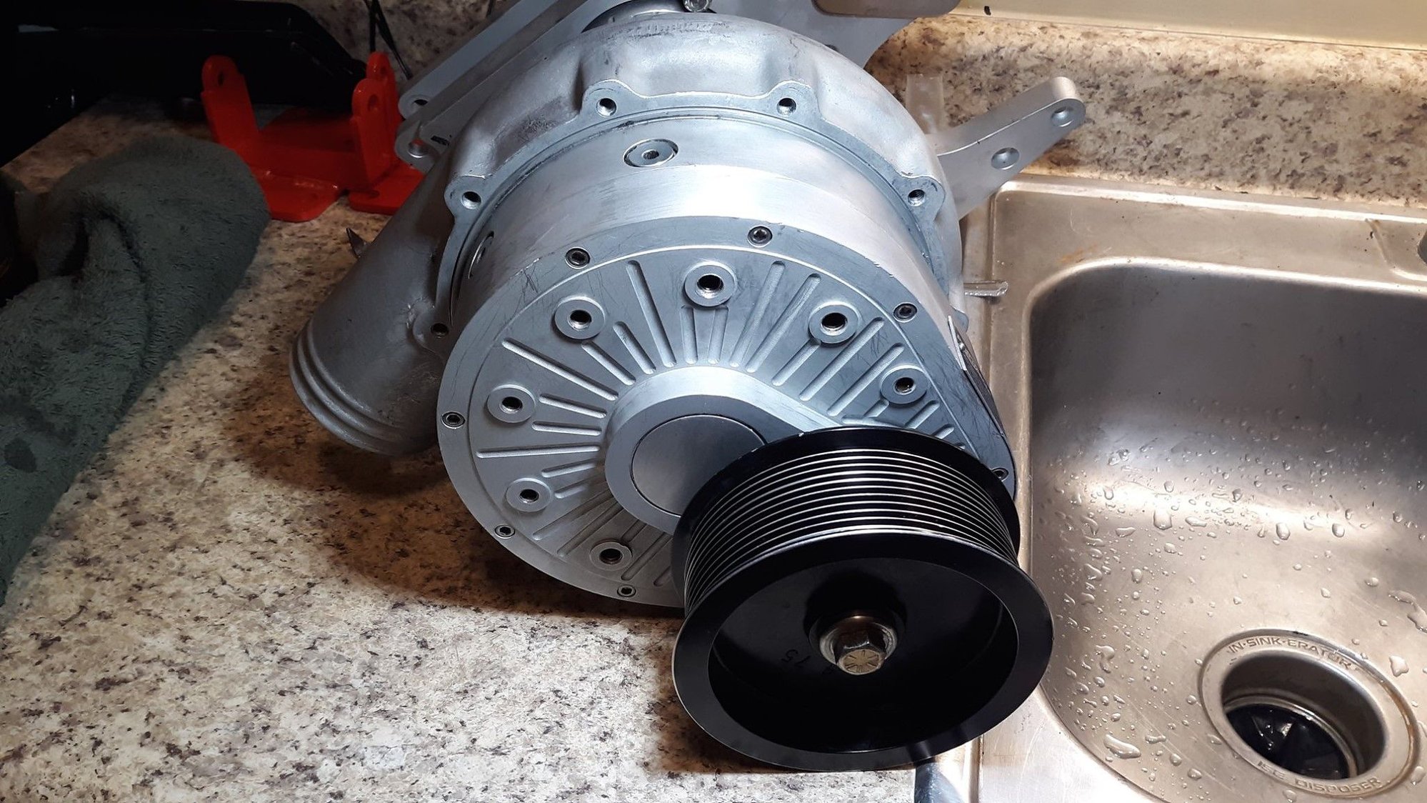

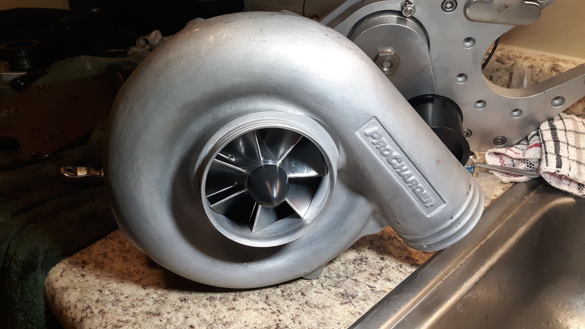

(I can add pics in a pm )-
-edit- I found some of my missing pics-
No cog stuff stuff just the head unit only.
Im missing some of my pics so Ill just give you the few good 1s (I can take more tonight after I get home). Aslo it USE to have that black coating from Procharger be iv taken it off.
2. I also, have a 3 core 1000hp Procharger race intercooler if your looking to upgrade intercoolers (going from a p1/d1 to an F1 is the perfect and best time for an upgrade since youll be taxing your current intercooler.)
$400 shipped for you - or I can meet you half way if you want to buy this stuff in person, if you want.
lmk-

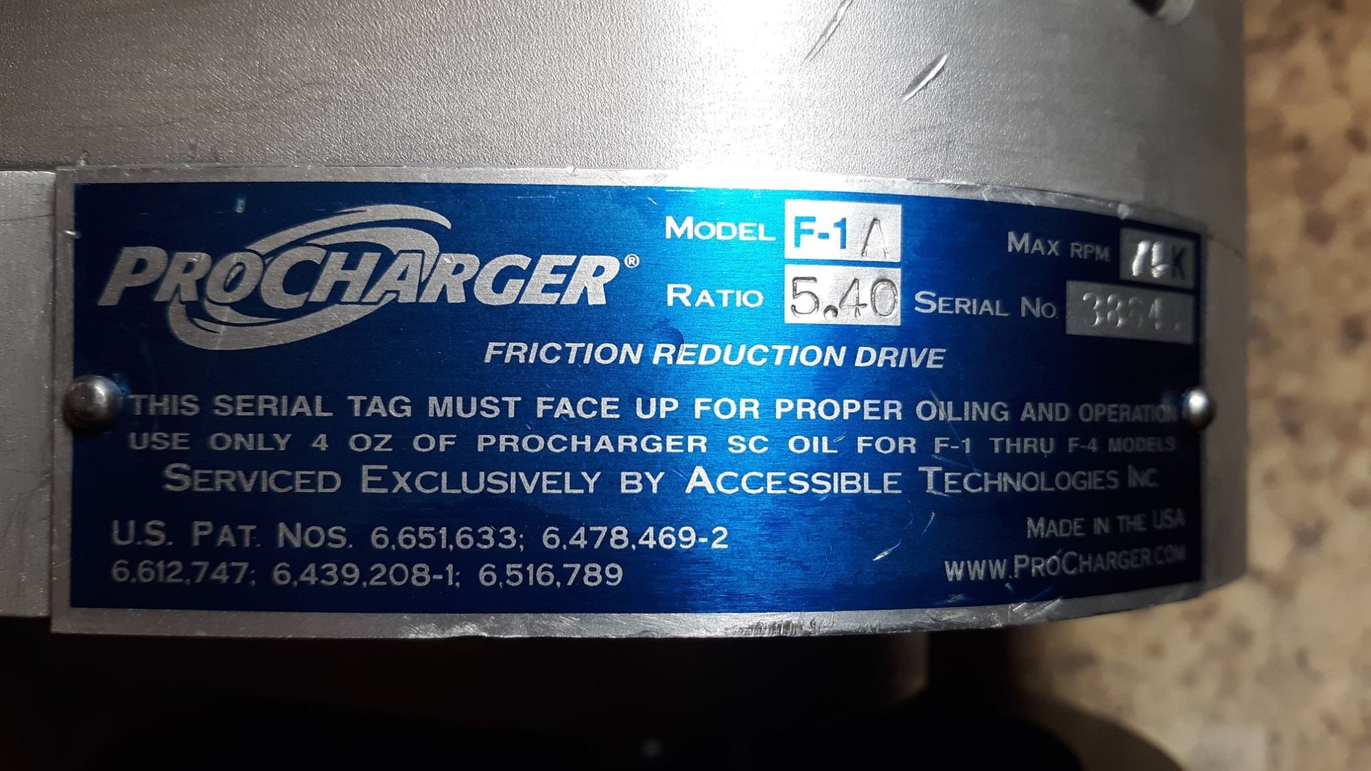

Am still still at work - I'll post a good tag pic when I get home.

This blower was made a few years ago, and sold in a 2013 Camaro kit. (I still have the 12 rib bracket that came with the blower)
