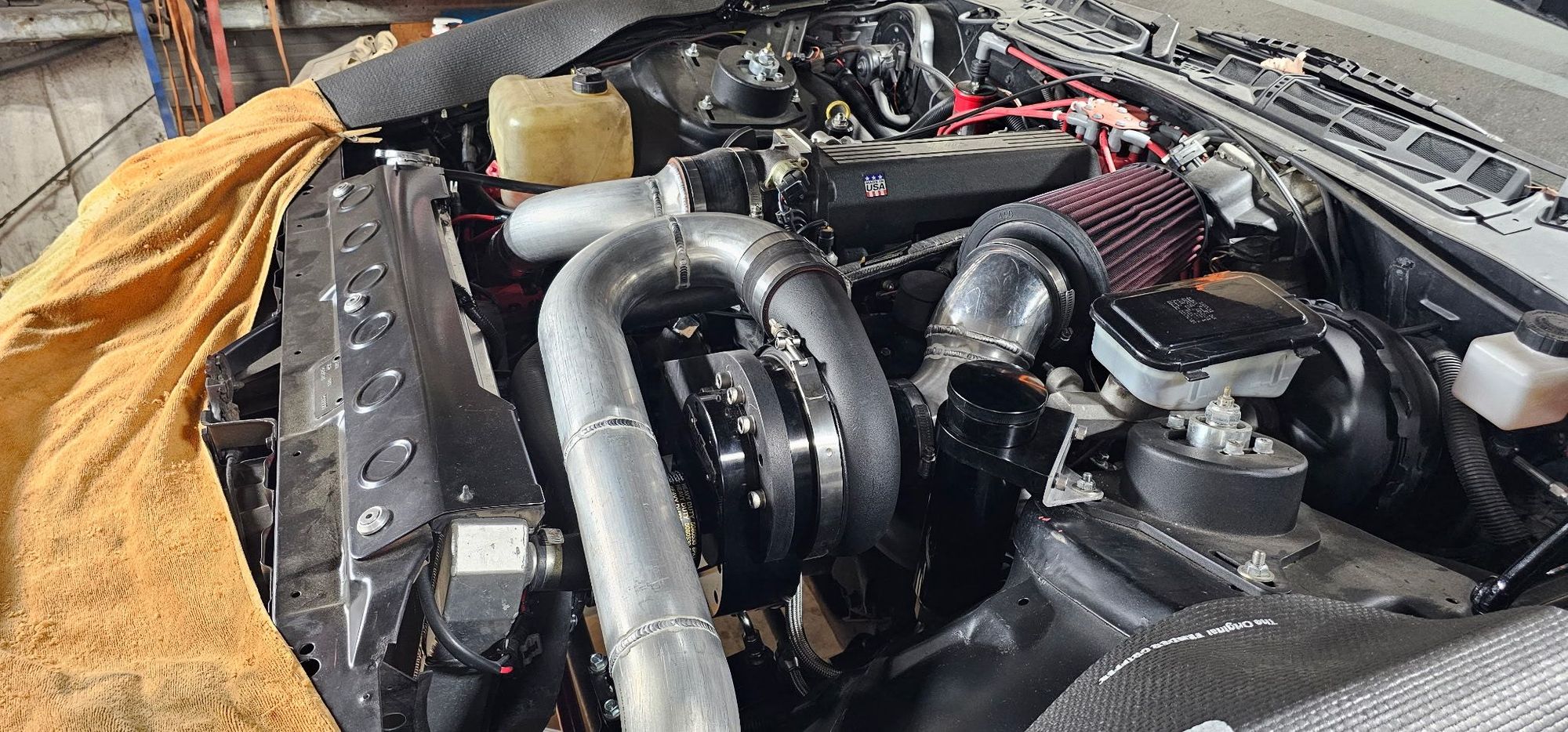

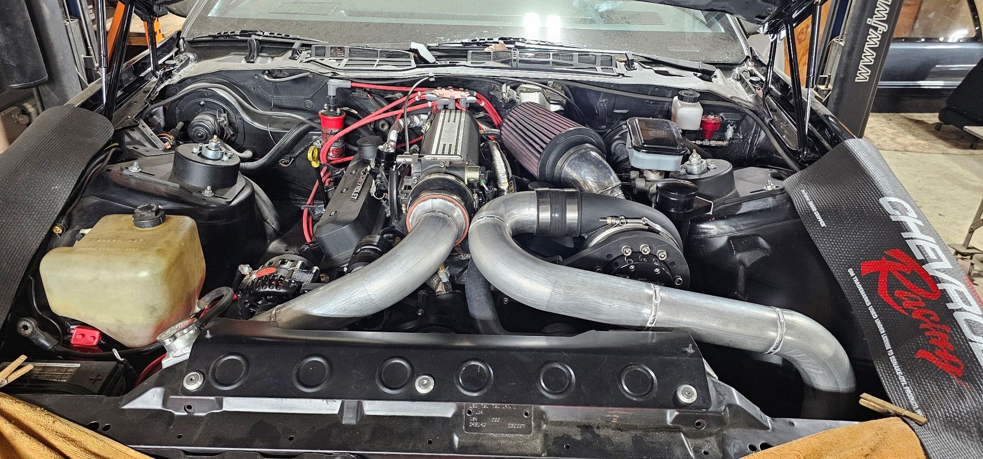

I don't really know where to post all of this but here it goes. While I was working on this I had a hard time finding info on these blowers fitting in these cars.
82 trans am w a zz430 clone, edelbrock pro Flo xt and a torque storm blower.
Hyper pistons
pm rods
forged crank
lt4 hot cam kit/roller rockers
fast burn heads w 9.6 cr
pro Flo 60lb injectors
aeromotive 340 l/hr 6an feed/return
ram concept 10.5 dual disk
magnum f close ratio
moser 9 w 4.11

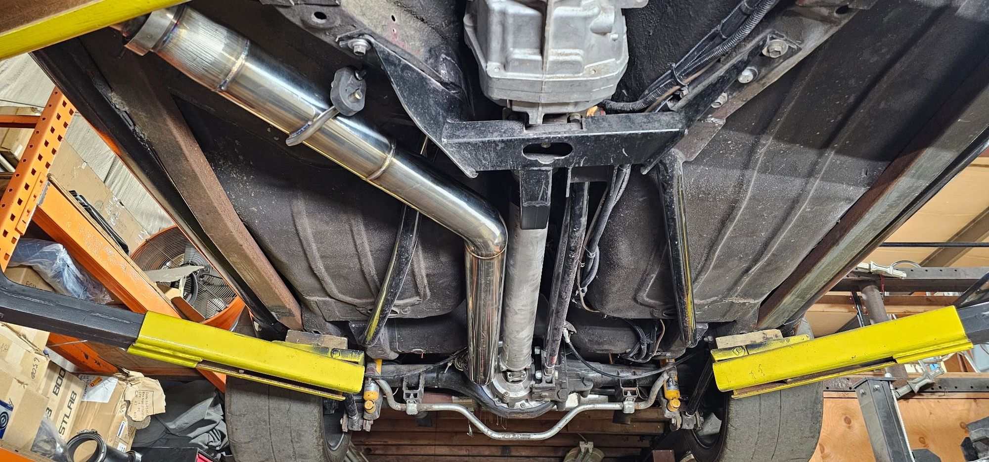

dons header to a 3.5 exhaust.
The blower was putting out 8lbs of boost, and the custom IC kept my IATs @93 deg and it was 98 deg outside.
468hp/467tq to the wheels. The tuners and guys running the shop estimated 18 loss w my drivetrain. So all in all I'm really happy. The car rips! Driving around backroads moderately aggressively in 95 deg weather the hottest the engine got was 200 deg. This is w a bunch of tire roasting burnouts.
PS: it all fits under the stock TA hood. The blower sits up in the power bulge.

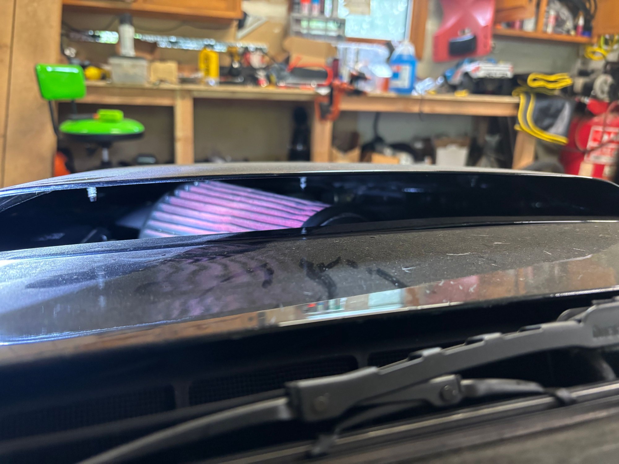

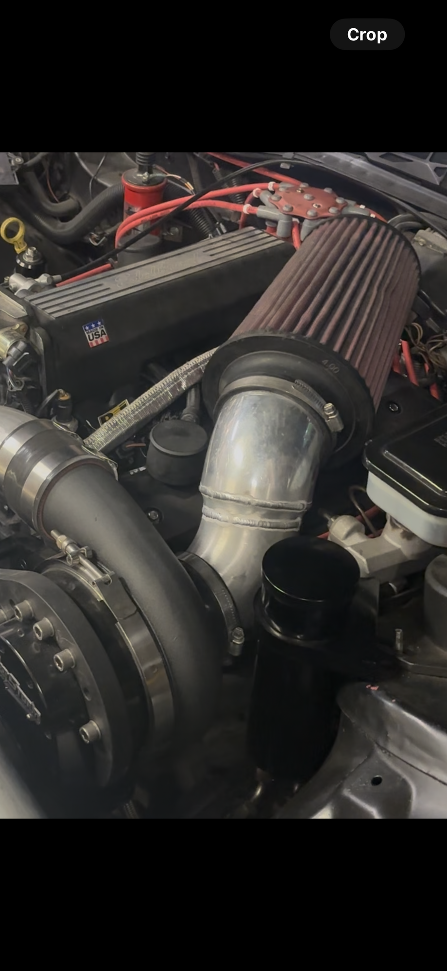

air filter sits right up in the cowl.
This is a spintech 3.5 to dual 3

Very nice setup. I'm impressed that you were able to get the air filter up into a constructive place.
The Procharger setup pulls air from right above the header. And with the master cylinder right in the way, I don't know that it would be possible to get to the cowl opening.

I have a friend who's a brilliant fabricator. He made the intake and all the piping as well as the IC. The air filter has pretty good clearance from the engine and is far away from the headers.

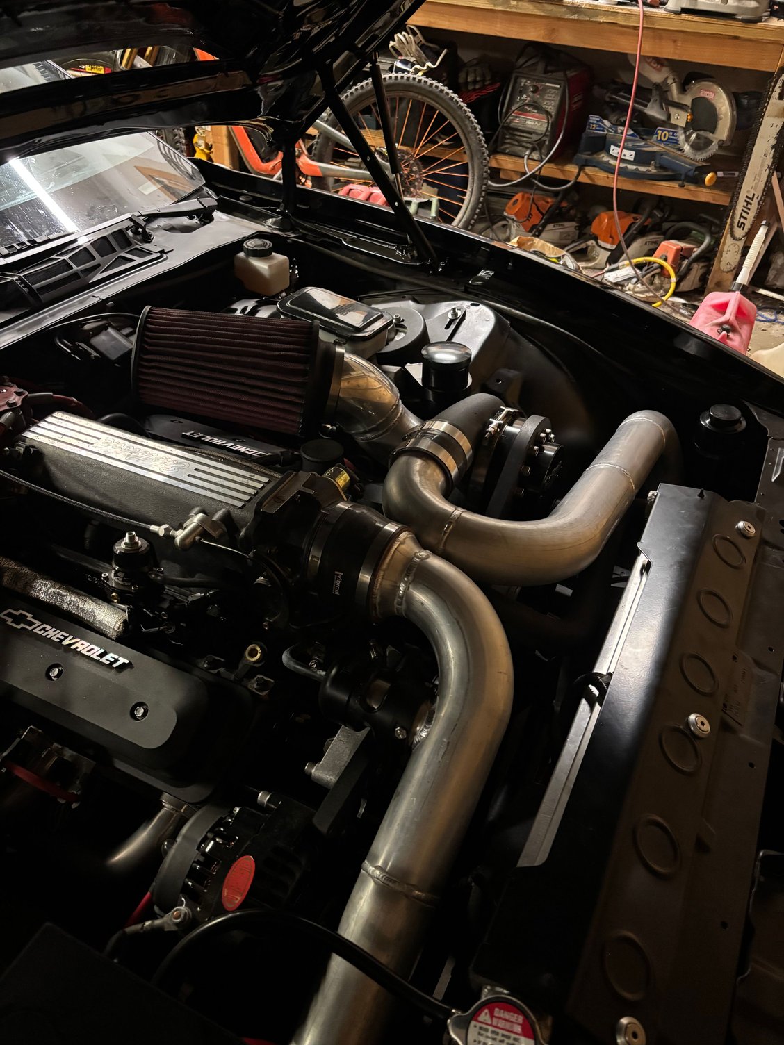

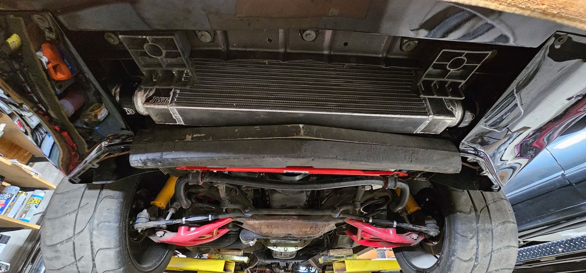

Love that setup. How is lag with that long of intercooler piping? Any more detailed pics of intercooler setup? I'd love to see you toss that spin tech muffler. I switched from. Spin tech to dynatech and had big gains NA. I wanted to do air yo water to limit pipe length (vortech t trim) but if yours works good,maybe ill go air to air.
Great build

here's an ic pic. It goes up to the hood latch almost. The fabricator made the ic the new support for that area vs the little stamped triangular piece. I re-did the lower air dam so it sits under the radiator now. The way it was in the pic my coolant temps were hitting 200. Now they bounce between 185-190. If I'm on it a little my IATs are 91-93 deg. Just cruising w no boost they sit at 95-97. There's really no lag. The engine made a ton of power pre blower. The lt4 cam likes to rev so it's never been an off idle beast. I have a close ratio t56 and 4:10s, it's just rips. It's harder to build boost in the lower gears, it just takes off. There's a balance between reckless driving and seeing what it can do! Once I'm in higher gears it's really pulls hard. It's a total blast. I only have 500 miles on it at this point. At some point I feel like I feel like I'll need to get it on a track to really open it up. It's just fast as hell.

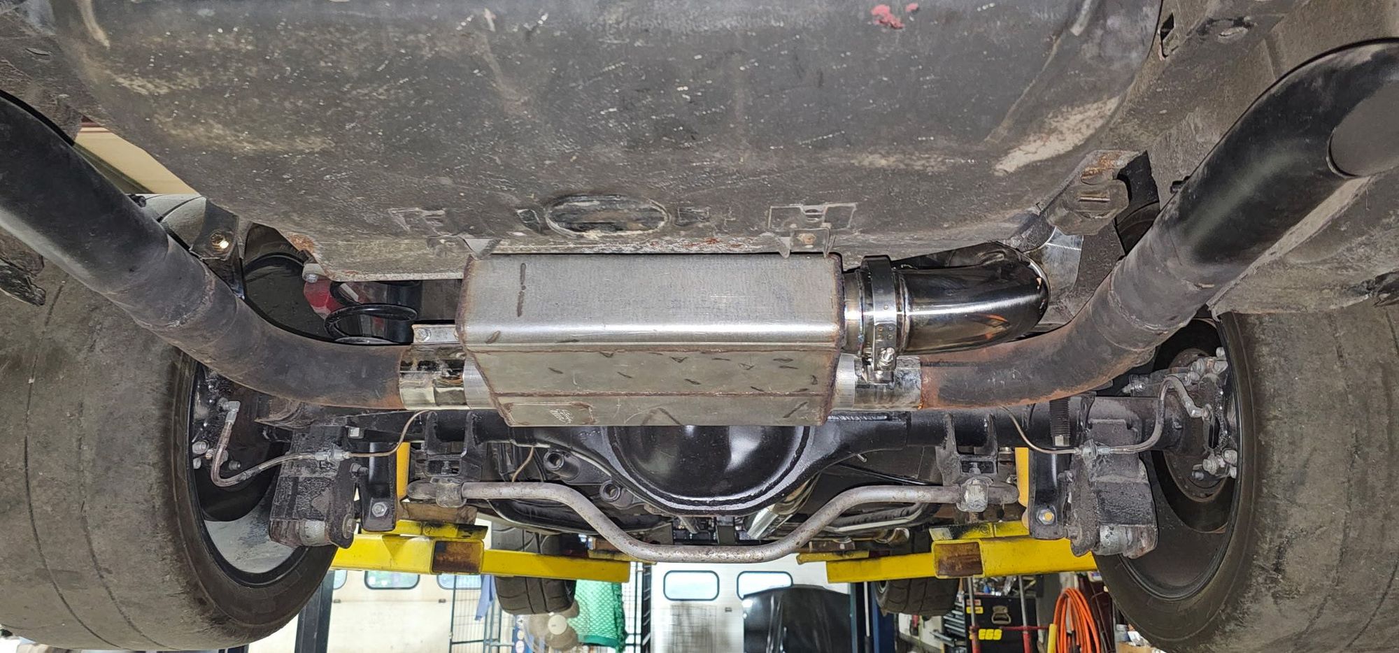

I thought about different mufflers. The truth is, I was so happy w the dyno numbers I'm content where it is. At least for now.

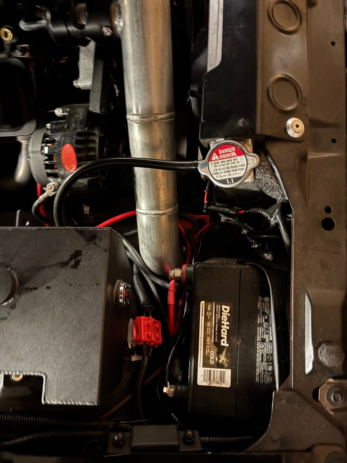

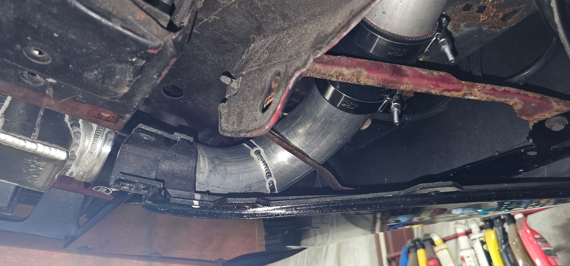

Run the ice pipes through battery and air box tray or through the fender?

Re: Finally tuned!
The battery trays (area) on both sides. And the battery is still in the stock spot. It all just fit really well.

Some more detailed pics would be great if the pipe routing. Excellent work.

I have a little more room than you DT no AC or smog stuff but there's easily enough room between my rad and IC to fit a condenser. Cooling it all may be a deal! I have 2 spal HD fans.
the pipe by my battery passes the a hole cut between the frame horn, wheel well and battery. The only material cut was the battery tray. There's a little "unused" area there. All of this fits under my stock 82 TA hood. The air filter sits up in the power bulge.
