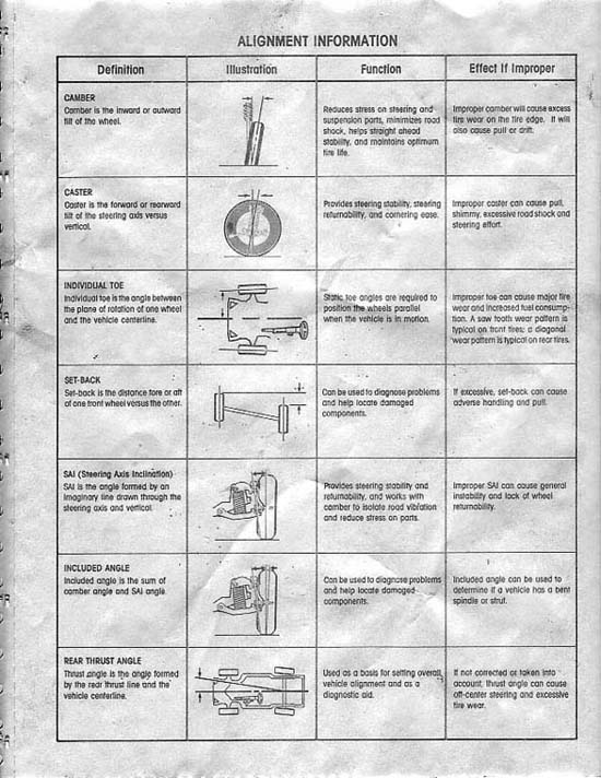

caster is equally as important if not more than camber. caster is a non wearing angle by itself. but has a lot to do with making a car go straight. it's hard to explain how it works. but has to do with the relationship of the upper strut mount to lower ball joint. with the upper part being behind the lower ball joint, you project the load ahead of the tire. also, you twist the spindle so to speak. with this in mind the weight of the car will make the spindle turn. or instance the left side will turn right and the right go left. due to road crown in most states, if all angles are equal, the car wil ldrift right. that is why you want the camber higher on the left and caster higher on the right. car will pull to the higher camber number and lower caster number. and yes, toe has no effect on pull. as toe is always equal on both sides.
here is some explanations of angles in alignments:

Equally important yes I agree. Caster is commonly overlooked by your tipical 'quick-shop' alignment. However, a cross-caster difference of 1 degree will have a smaller effect on a 'pull' than 1 degree of cross-camber. That is a good diagram of the alignment information--I might have to add that to my site(it really needs to be on this site). If you read the description, camber problems will cause pull or drift while caster 'can' cause pull or drift.
