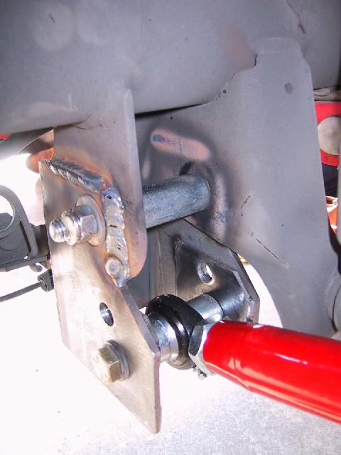

Here's a pic, not the greatest, but it's something....

heres a pic. that someone on the board posted. I saved it so i know how to install when get'em.
He'll probably jump in here and help ya out. he's a great help.

I opted for BMR bolt-on units and planned to weld them even before I bought them. Why? I felt they offered greater strength, safety and stability. Notice the extra bracket that runs to the shock mount and welded.

It looks like those relocation brackets are just a piece of 3/16 ( possibly 1/4) steel plate ....with to bends ...and a couple of holes ..........they want WHAT ?!?!?!?!?!
rip offfffffffff .........................it's not like we are driveing imports here ( raped on parts ....for NOOOOOO reason )
I think I will make my own ........I'll post a pic of a diagram ......I don't see why a shop wouldn't fabricate this for you for nothing

I would bite my lip if I were you. First off they aren't just bent steel. They have holes drilled in the correct places, come with welded in spacer on the inside of the bracket and new bolts/washers. Considering they're cut and bent, and welded, I would dare to find ANYONE that can have them made for the price Spohn sells his at.

The LCARB's improve traction by changing the way that the force applied by the tires pushing the car forward affects the lower control arms and thus traction. Here is a quick sketch to describe what it does.
Ric

By the way I made my brackets and will NEVER DO THAT AGAIN.
Although I am quite happy with how they turned out they took me 6 hours of flat out working to make them. 6 hours times 20$/hour pluss material totals up to about $200 cdn or about $150USD. I could have worked overtime instead purchased the Spohn brackets and still had money left over for beer and pizza while me and my buddys installed em. Doh
Here's a pic of what I made anyway
Don't try making these things the Spohn bracket is a fabulous deal.

I agree that if anyone is going to get these then they should get the Spohn ones.
First of all they are cheaper. $65.00 compared to $69.95
And 2nd the BMR weld in ones don't have the spacers welded into the inside of them so there not complete and you'r going to have to have some made if you dont have the meens to do it yourself. I dont think you would want to fill that gap with washers, so thats is going to cost you more money.
I got mine as a package deal from Thunder racing and didn't know that at the time so I had to make my own spacers.
I just think that BMR should say that somewere so people will know, and I have found nowere that tells people that, or they should make them with the spacers like spohn dose,, or,, they should lower there price.
Just something I thought everyone should know.

Originally posted by DAVECS1
If you do not like to measure I would get the BMR ones. It took alot of measuring to get the Spohn one exactly right
[IMG]
Like the man said....for eaze of installation...get the BMR's. You will thank us later

When you lower your car the angle of your LCAs alters for the worse. What the brackets do is correct the angle of the LCA so that more weight is transfered down onto the pavement. The brackets will also help to eliminate wheel hop that is very often a by-product from when you lower your car.
Robert
