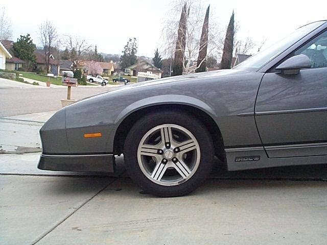

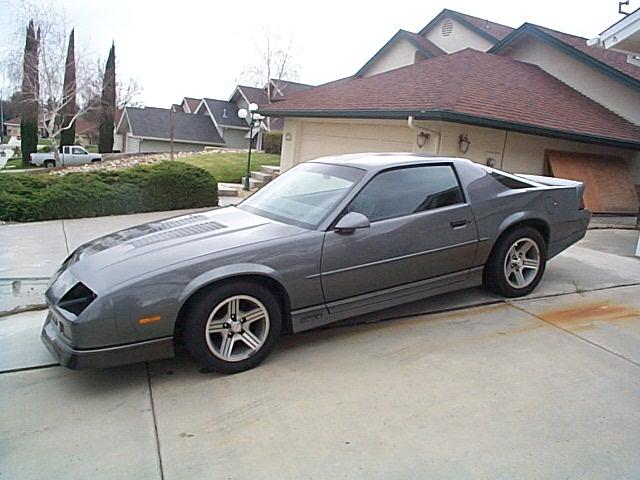

Here are pictures of the 88 IROC that I just installed the Pro- Kit springs on....

I did not take a tape measure with me when I went over to take these pictures... Sorry. The car is far from being too low, and it rides / handles very well.

RU -QUIK
Do know the tyre size he's got there.
Edit - so i can figuer out the wheel size - looks like it's less than a 26 inch wheel.
Thanx.

Those tires are 245/50/16 BFg's .... The rubber spring isolators were not replaced, so they are a little flatter than new ones would be.

25.6 inch wheel then - same height as my 275/40/17s
I hope my old isolators aren't trashed because they're going back in.
