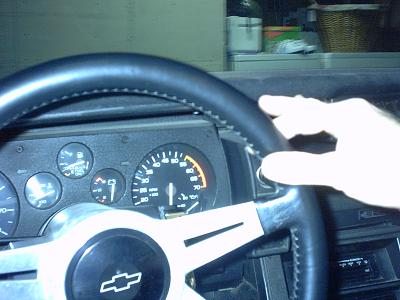

Originally posted by AGood2.8
..., I can drive it with a finger and thumb at all times.
No B.S.- I can literally drive the car with this much grip on the wheel on any road at normal traffic speeds- no matter what ruts, etc are in the road any slight pulling side to side is not voilent enough to grab any tighter. Racing is a different story- I like to hang on at speed. If turning sharper than a 1/4 turn of the wheel, which is sharp enough for any corner (I have a quick ratio box) then of course I have to grab it to pull it around faster. Usually only in a parking lot- And only the tightest lock do I feel the Ackerman angles slip.
Note: I don't drive like this (west Hollywood style )- but I can with this car. It has 245/50-16's Goodyear F1 GS-D3's.

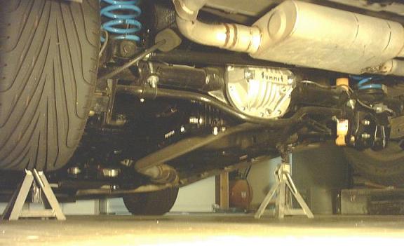

Here's a current rearend shot- There's a very lightweight Carbonfiber driveshaft up in there also that you can't see in the pic. You'll notice that the back axle is dropped out(not at ride height. I don't run the relocators on the bottom setting, but rather the middle- On this car with ride height, etc., My angles are best straight( favoring upward side just slightly at ride height) and then compressed upward for an inverted angle on the outside hard into a tight corner. That shortens the geometry of the arm on the outside tire and causes roll understeer under sway. Slightly turns the rear tire inward in a hard corner(rear wheel steer setting that can be used to your advantage- even only a 1/16" toe in will make a difference as opposed to a 1/16 toe out with the reverse setting. That can be a whole 1/8" difference in rear track through a corner- 1/8" in rear steering is quite noticable).
There's alot going on there that most won't pick up on- Notice the sway bar mounts- they are angled backwards. Why? to allow more freedom because the LCA's are shortened as much as possible for shorter wheelbase and greater affect of rear steer characteristic( the shorter the arm, the more geometry will change in movement)- again its all about geometry. Caution not to bind the tailshaft yoke, there must be adequate play still for movement.
