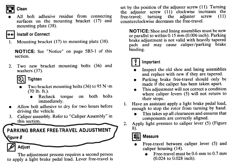

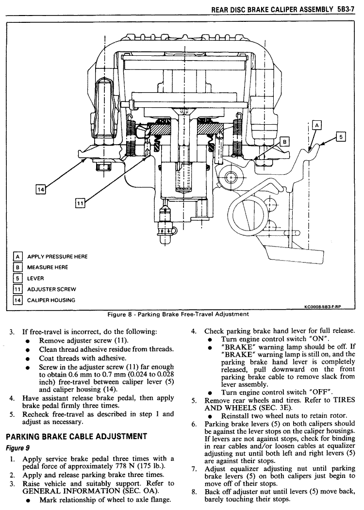

Here is some information that I had posted for another board member that might help you.
Old Jun 15, 2004 | 09:44 AM
Trickster's Avatar
Posts: 6,127
Likes: 12
From: conway, s.c.
Car: 1989 Iroc-Z
Engine: 5.7L TPI
page 2
