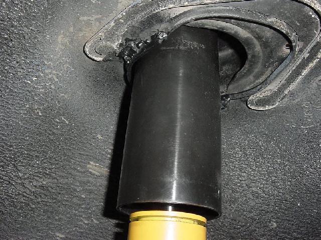

Well I finally got these in. Ran into a few issues but nothing that couldn't be fixed with a welder and a few beers. I just installed these along with a PA k-member and Spohn LCA's, so with the springs out I went ahead and mocked everything up. The strut clears the hole in the strut tower, but since my car is lowered I wanted to check the strut body, and sure enough it hits the hole about 1" before the tire would buzz the inner plastic fender (which I did once going over some rough train tracks ).

You can see from pics how it cuts the lip out of the hole, which weakens the top of the strut tower. The fix was a 3/8" wide piece of 1/8" plate the was bent to form a new lip and welded into place.

With new piece welded in strut clears fine and allows use of original dust boot. You can use the 4x4 rubber dust boots as long as you don't have to worry about the body of the strut hitting the hole in the strut tower. I will be getting the car aligned sometime this week and will post how much more it is adjustable when done.

Pic of fixed strut tower before grinding welds and paint:
