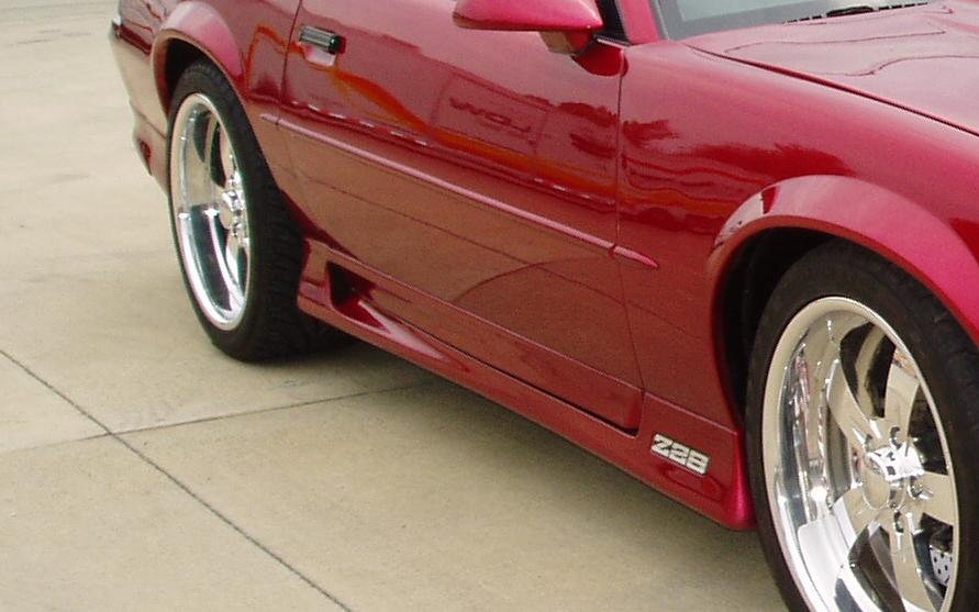

just so you know kandiedz had 18x10s on his 91 or 2 and had a bs of 6.75 , i know he had to do hammering and cut the bumpstop , the only good thing about going through all the work to fit them is that you could run an 11 inch wide rim .
Old Jan 24, 2005 | 12:05 AM
Kandied91z's Avatar
Joined: Nov 2000
Posts: 13,039
From: michigan
and they fit right lifted, lowered or ride height.. well a little bit of rubbing when lifted.
http://www.cardomain.com/member_page...&val=1&page=11
Attached Thumbnails 4.5"BS front 6" BS in the Back. Anyone have this wheel combo?-sideprofile.jpg

Old Jan 24, 2005 | 01:06 AM
Kandied91z's Avatar
Joined: Nov 2000
Posts: 13,039
From: michigan
Originally posted by CrazyHawaiian
Are you sure they dont come in a 9" or 9.5" wide width? Did you ask them directly? It may not be listed on the website, but when I asked them directly they pretty much said they could make any width I wanted with a $50 extra fee per wheel.
yep they can.

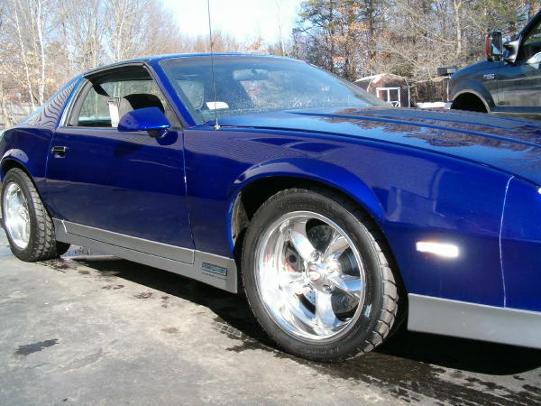

would a 6'' backspacing on the rear rims keep the rim in nicely or should i look at about 6.5''? im lookin to get a set of Foose rims 18x9 or 10'' for the rear and was just woundering. right now im tryin to get prices on the rims i want. i dont care if ill have to do a bit of trimming, i gotta fix some rust in the fenderwells anyway.
Old Feb 5, 2005 | 01:01 PM
JeffW's Avatar
Joined: Jun 2003
Posts: 1,985
From: Massachusetts
Car: candy blue 85 z28
Engine: 305 tpi LB9
Transmission: 700r4 crazy beefed up one
Axle/Gears: ones with teeth
i went 5.75 in the back and there was no fit problmes. 17 x 10's and i did the same as you on the fronts and i also got them from sport truck. only p[roblme i had with mine was finding short enough valve stems to clear the bear brakes on the fronts. they way the machine the valve holes does not leave alot of room. its so close i can;t run valve caps. other than that i love the look.
Jeff
Attached Thumbnails 4.5"BS front 6" BS in the Back. Anyone have this wheel combo?-c-documents-settings-jeff
