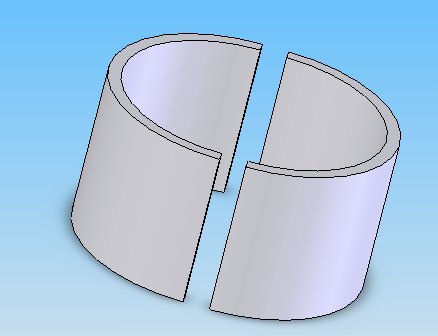

how do you mean a piece of steel? like the drawing I attached? or different?

He means between the 2 ears where the bushings go.
So when u hammer on them to put the bushings in or do it in a press(depending on size) u dont bend or collapse the ears on the control arm in.
Just put something between so it doesnt collpase when u install them.
Bushings are the {-} things in the pic I made(yeah me lol)

WOW WOW take it easy
These things almost fall in if you do it right.
Here's the secret take the ruber out of the new bushing shells then install the steel shells in the control arms first. once they are in grease the poly bushings and slide them in.

ratchet, I can't get the poly seperated from the shell....
3.8TA: I can't read ASCII pictures... but I think I get what you mean. I boxed these control arms, so I shouldn't have to worry about that right?
