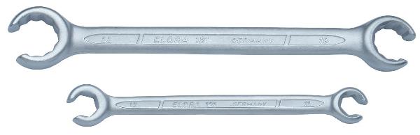

Get some PB Blaster and hit all the bolts with it. Use line wrenches on the fluid lines. It's really not hard at all. When I replaced mine, I had a pitman arm attached to the new box before I put it in, that way you don't need a puller.

Again pardon ignorance: line wrenches?

I suggest the six point ones.
And PB Blaster is your best friend on these older cars.
