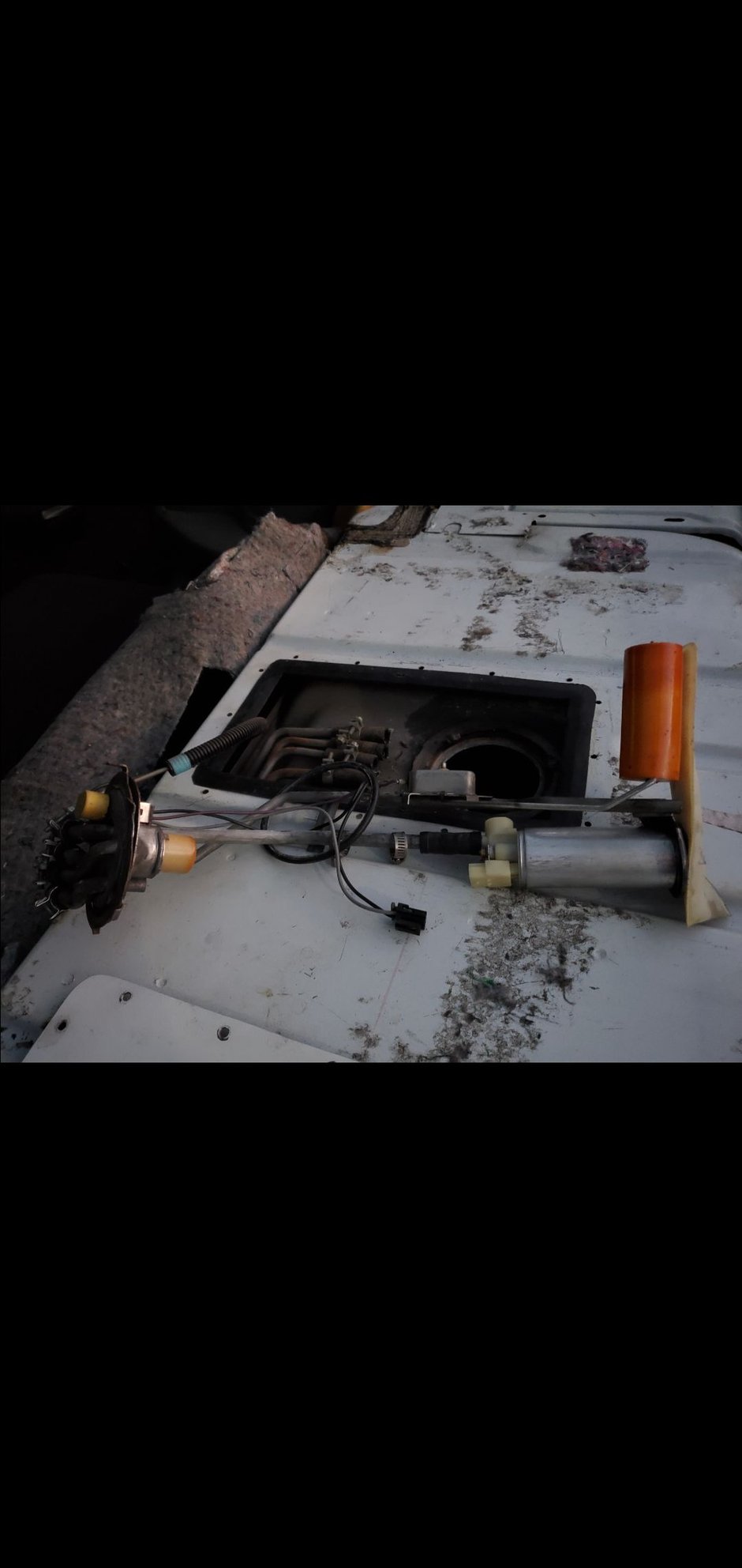

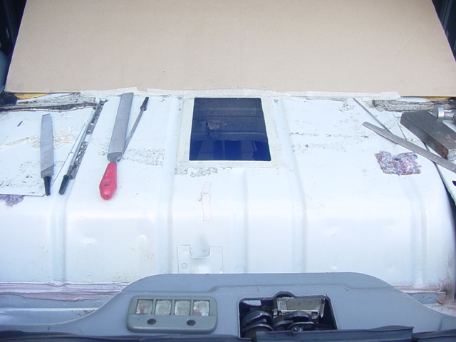

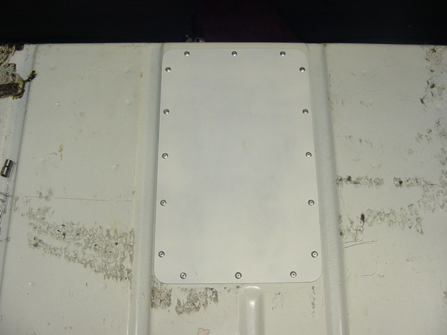

Well it's been a couple weeks and I finally finished what was needed to get my '88 on the road again. First I thought my fuel pump was bad so I did everything needed to drop the tank PITA, when I pulled out the pump I noticed the short hose on top of it had a split in it. That's probably what made my car start but not idle unless I kept on the gas, seems that it was pumping but not enough. Since I went thru all the trouble I just went ahead and put in a new pump (wish I had an access panel). This is what was done so far--new fuel filter, new fuel pump, 2" wheel adapters all around, C6 18" & 19" 5 spoke wheels, paint calipers and drums , paint rear axle, new rear sway bar end links, UMI adj. panhard bar, 3" after cat Flowmaster system, TBI injector spacer, TBI airflow mod. Next will be lowering, adj. LCA's, 4th gen console swap, carpet. Lastly, I always liked the idea of an access panel for the fuel pump, so since every thing was taken apart I put one in. For those who say the only (so called right way) to change a fuel pump is dropping your tank, well I did that once, now in the future when something isn't right with the fuel pump weather its dead or it's just a hose I have access from the top. I taped off area and cut with a jigsaw then filed the edges then cut a cover to overlap by 1" with 16 ga ,drilled holes all around made a foam gasket to seal opening, painted cover and riveted it in place. Later.

The fuel pump access panel looks well done!

Very nice job on that cover man! Drilling all those rivets out will be a pain in the butt...but I might be inclined to do the same. They look clean, and wont strip the holes out like screws.

the access panel look very nice, most ive seen here are totall hack jobs.
with that said, why do people do that? a couple weeks back i swapped out an intank pump the RIGHT way by dropping the tanks and all that yada-yada. Its not that hard, if i did it at home in my garage, i dont think it would take me more than 3 hours alone. Its really not the big deal that people make it out to be.
but anyways, good job, it came out very nice, though i would have used threaded inserts and bolts rather than rivets, just for ease later.

Thanks guys, I've seen the hack jobs too, so I figured I'd do something that could seem factory. I didn't mind dropping everything to get to the tank the first time around (for the experience) but I hate redoing things so drilling out 16 rivets if needed is way better for me. The threaded insert idea is a good one, I just couldn't locate any at the time. Later.

something else that came to mind a little while back, but i could not find this post
I have seen pics of this access door hole many times on several different 3rd gens, and the fuel lines are all spliced back together with the same rubber fuel line and gear clamps.
Now, how about this. If you have an intank pump, the car is going to be fuel injected right?
Now do you all realize that this rubber, parts store fuel hose is meant for carb application only? It is not rated or built for the pressure involved in a fuel injected application. Just look under the car where the flex lines attach to the fuel lines from the body to the tank, and from the body to the fuel rails, the hose is MUCH heavier and has a threaded connection.
This other hose could burst due to the pressure, and that could be catastrophic
Some food for thought
-Phil
-Phil

Good thought and I have seen that but I did use fuel inj. hose and fuel inj. clamps. Later.

Just want to make sure everyone that sees this is aware..
This on was done on a TBI car. Meaning a lower fuel pressure, MUCH closer to a carb setting than a port injection system (TPI/LT1/LS1).
So...Those single clamps on the fuel lines, will not hold up to higher higher #s of port systems. Especially LS1.
I think I've seen double clamps (per connection/hose end) hold the TPI pressures.

89IROC, I believe they were 5/16 F.I. hoses. I cut the hard lines with a metal band saw, and remember I had the tank out and the lines were all dry so no danger. Later.
I'll be lowering the back of the IMSA within the next few days. Since dropping the rear axle is also one of the major steps leading to tank removal, I might as well go ahead and take it out. The car sat at the farm for almost 10 years before I rescued it and I'm sure there will be interesting things to find inside the tank.
I will probably go with an oval hole and attach the cover with #6 machine screws and clip nuts. I'll also probably go with AN fittings to minimize rubber connections. That'll make it look like an aircraft installation and since I'm in the trade, it'll be just dandy!

If and when you do have to drill the rivets out, don't forget to use a drill stop.
Then again, if you do forget, you wouldn't be the first person to accidentally drill a hole in his fuel tank.

GLAD I DID THIS !
Well its been almost 8 yrs. since i changed out the dead fuel pump and now i had to do it again.
Firebird has been parked about 4 yrs. and was time to drive it again.
Ive started it up and drove it around the block every few months, but now that i wanted to drive it on a regular basis it just cranked but no start.
My first thought was the fuel pump so i ordered one, decided to do a little trouble shooting first to make sure.
Checked fuses, relay, connections, plug behind back seat, jumped power wire to pump wire and still no go so def. was fuel pump.
Changed out relay anyways since its cheap.
So******* glad i did this access panel, took 10 min to drill out rivets another 10 min to clean up area and in about an hour was done and ready to drive.
A fuel pump can be replaced in an hour on the side of the road with access panel.
There is no reason why this should not be done. Later.

Re: On the road again...fuel pump- access panel-C6 wheels
Here i go again, weak/dead fuel pump one more time.
Good for me i did the access panel mod years ago.
Doesnt seem to matter if i paid $50. or $15. for a fuel pump they go bad regardless. I think this is my 4th one so far.
