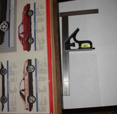

Fair enough. But the level of what constitutes "proper equipment", or rather "equipment of sufficient accuracy" is a whole lot less expensive than what the $$$$$ shop alignment racks imply is necessary. True, a rack can measure things like setback, but most times this isn't dealt with.
Anyway, here's some pictures of the equipment that I have actually used. The angle finder is good to the digital resolution of the tool (usually 0.1°), and the really basic thing is good to about ±0.15° if you're using a scale graduated to 32nds of an inch to measure the offset from the vertical. The one with the dial indicator is a DIY-fabricated tool and has better resolution than either of the others . . . somewhere under ±0.05°. I doubt that I've got $125 tied up in all three combined, including the dial indicator.
Two strings, four jackstands, and a steel tape or two to get the strings set parallel to each other (for checking toe) rounds out the measuring equipment list.
Norm

It's a Word file with the pictures shown above, and written somewhat generically. But since it's mostly about measuring, the only real difference might be specifically what mechanisms you have available to make the adjustments with (shims, eccentric fasteners, caster-camber plates, slotted strut attachment holes, etc.).
PM me with an e-mail to send it out to. I'll need to edit it a little, as there is currently a link in it to the Hunter (the alignment equipment people) website that no longer works (they moved/removed an SAE paper that had a bunch of mathematical equations).
