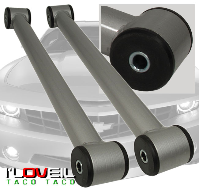

was wondering if any one has used these or know anything about these control arms
http://trendgears.com/ebay/TacoTacoN...RLCA-301SL.jpg

They will be better than stock. That is just another ebay company, I would advise against that you be nice and get them from Founders, Spohn, BMR or UMI since they are our sponsors. We know their quality is good and their prices are great, probably the same as that ebay company.

thanks i'am going with Founders just saw those and liked the grey powder coated version thanks
