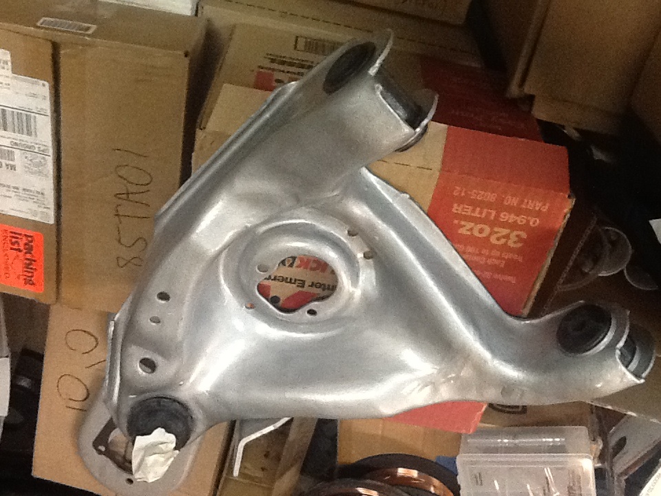

Good luck pressing out 30 year old bushing sleeves without mega press and heat. What appends when you apply adequate heat? The rubber burns.
I burned them out then cut up the sleeves so I could collapse them inwards.
Other posters are correct that the critical part of the pressing in or out is proper spacers and drivers or you will bend the arms, true for rear arms too.
Here's mine with new bushings pressed in.

Guess it depends how badly bent they were. Bending will fatigue the metal and possibly cause weakness, but it should be able to handle a little bending. Check for any distortion or stretched areas.
The right number of spacers is enough to keep the arms from moving. I have a bunch of random steel blocks and shims I use for my press. I just lightly jam them between the arms so there's no slack.
