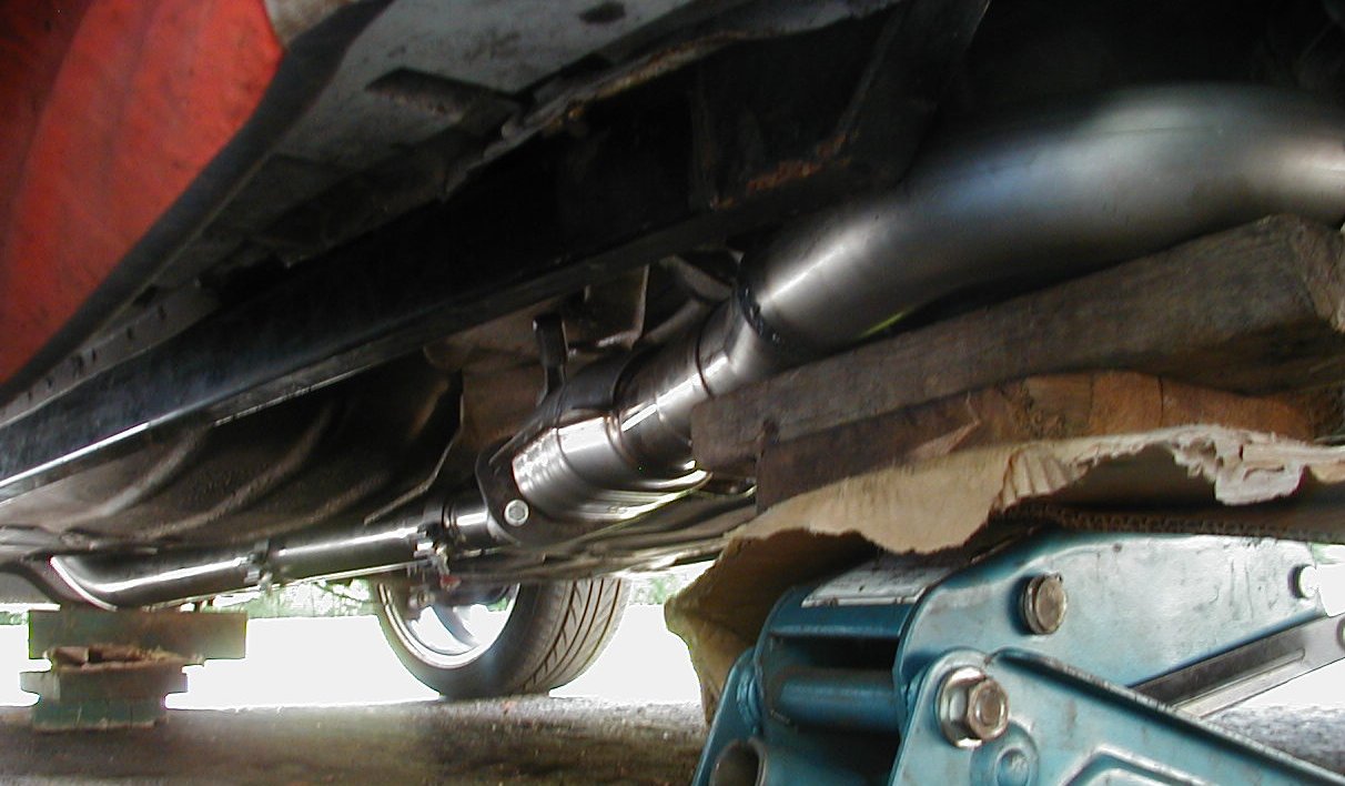

Installation requires drilling holes thru the floor.
Excuse the nasty mounting bolts. The pics were taken after a dozen or so years of use; many of those years it was a year-round car. Here's the only pic I could find of the pass side body rail / SFC.
That pic was taken after they were removed and re-installed. Before removing the SFC a couple years back I had considered laying an additional layer body sheet metal along the bolt holes,...... but once I had it apart I realized there was no need. I'll also add that after those dozen or so years there was NO elongation of the rear control arm bolt holes or the front holes. I might not 'race' my Berlinetta; but I drive pretty hard.

Here's a look @ Hotchkis Weld-In's. Notice how far BELOW the body rail/rocker panel that SFC fits when mounted.
In this pic the Y-Pipe is NOT attached to the headers yet....... I could NOT fit Don's Y-Pipe as delivered, it had to be cut and re-welded to clear the SFC. I doubt anything aftermarket would fit in there without modifications. I never tried factory TPI parts but I guess *maybe* a TBI/LG4 Y-Pipe *might* fit without hitting the SFC or the body. ( But who wants that !?!? )
