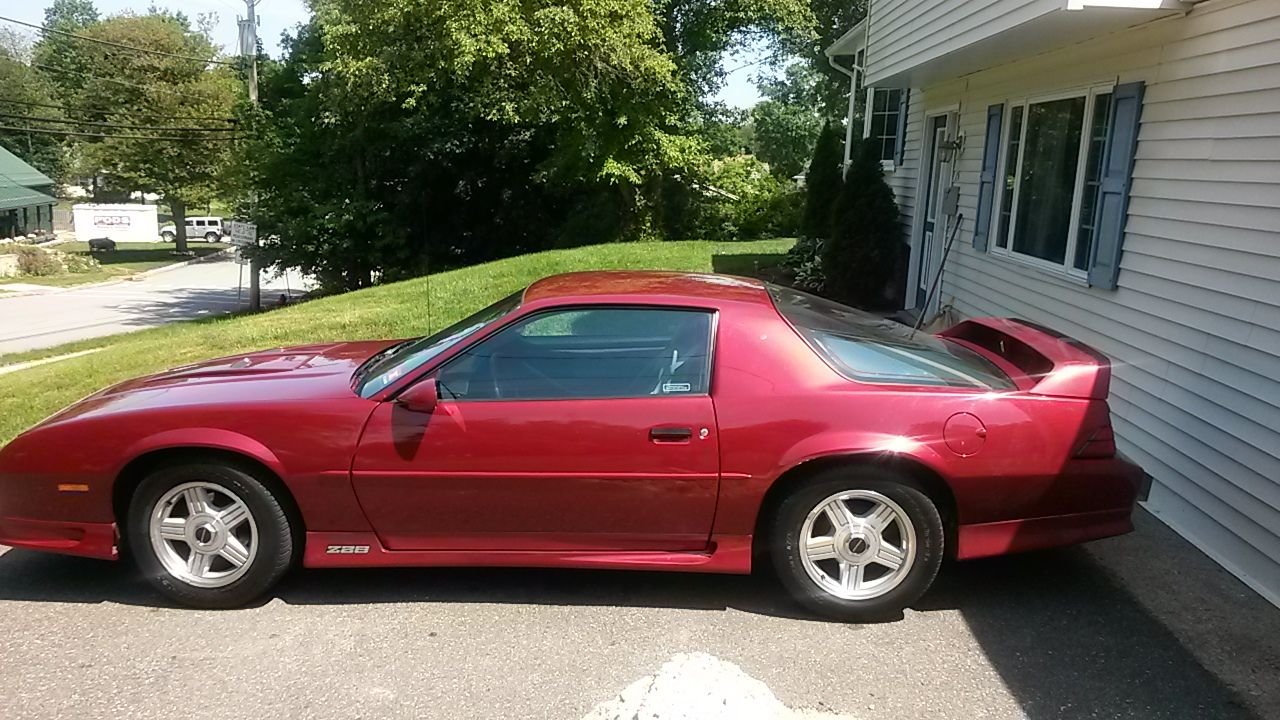

Best overall shock/strut/spring combo....
So... before everyone jumps on me.... "Yes" I did a search. (Maybe I just gave up after reading the 10th post)
There are so many opinions out there on which is the best combo. (some going back to 2001)
What I am looking for, is the BEST ride combo for everyday driving. Not looking for Autocross, Racing, etc.
My car is pretty much stock, down to the original shocks. I am just looking for a big upgrade so it doesnt feel like the car is going to fall apart when I hit a bump. I know these cars were not the best for street diving back in the 80s and 90s. But, technology has come a long way.
I hear Koni, Bilstein, KYB, etc. But they always include that they are "Great for XXXXX" I don't hear that they are the BEST for everyday.
Really could use some advice. Oh.. did I mention that it does not matter the cost? I am seriously looking for the best ride.
I really do not know anything about suspension, motor wise, Im good
Forgot to mention:
91 Z28 Hardtop
305 TPI
2.73 Auto
32k miles

Thanks for all the responses. I will be keeping the stock 16s for now. Was thinking about going to 17s in the future. Honestly, I dont hate the ride that the car has now. I was just thinking that there has to be something "smoother" then 25 year old technology. I still want the car to have good handling. I am leaning towards the Koni right now for the shocks. I am bot interested in changing the LCAs or any other parts.

This is the way it sits now. I am assuming it will settle a bit more. Gotta figure out the right rear, as it is sitting about 1" lower then the other corners.

Nice z28!
