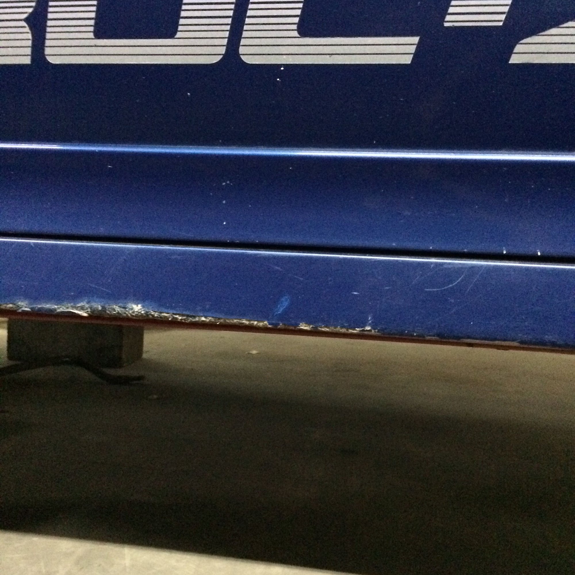

Are the UMI SFC visible from the side? I heard you can pinch weld them pretty much the entire length so that would seem to indicate they tuck up nicely, but I also heard that they are very similar to UMR and those have some gap. Spohn tubular hide the best IIRC but I don't want to weld round tubing. If you have a pic, please post it.

Our trusty IROC test car.
You have to look under to see them. They're about 98% hidden and tuck in nicely.

Looks nice, but who ever put that car on a cinder block needs to get hit in the head with that 4x4 block of wood.

Thanks UMI man! That's exactly what I was looking for. Ill be getting a set shortly.

I was going to post a pic of my Iroc with UMI SFCs, but their pic shows it perfectly. That's exactly how mine fit.

I went with a set of UMI because they looked like good pieces and also didn't show when looking at it from the side of the car.

Safety issue. The block will not withstand forward and backward movement as positioned in the photo. Also, if one block fails the rest will likely follow as the car drops and shifts.
Can be demonstrated by taking a single block and dropping it on a corner.

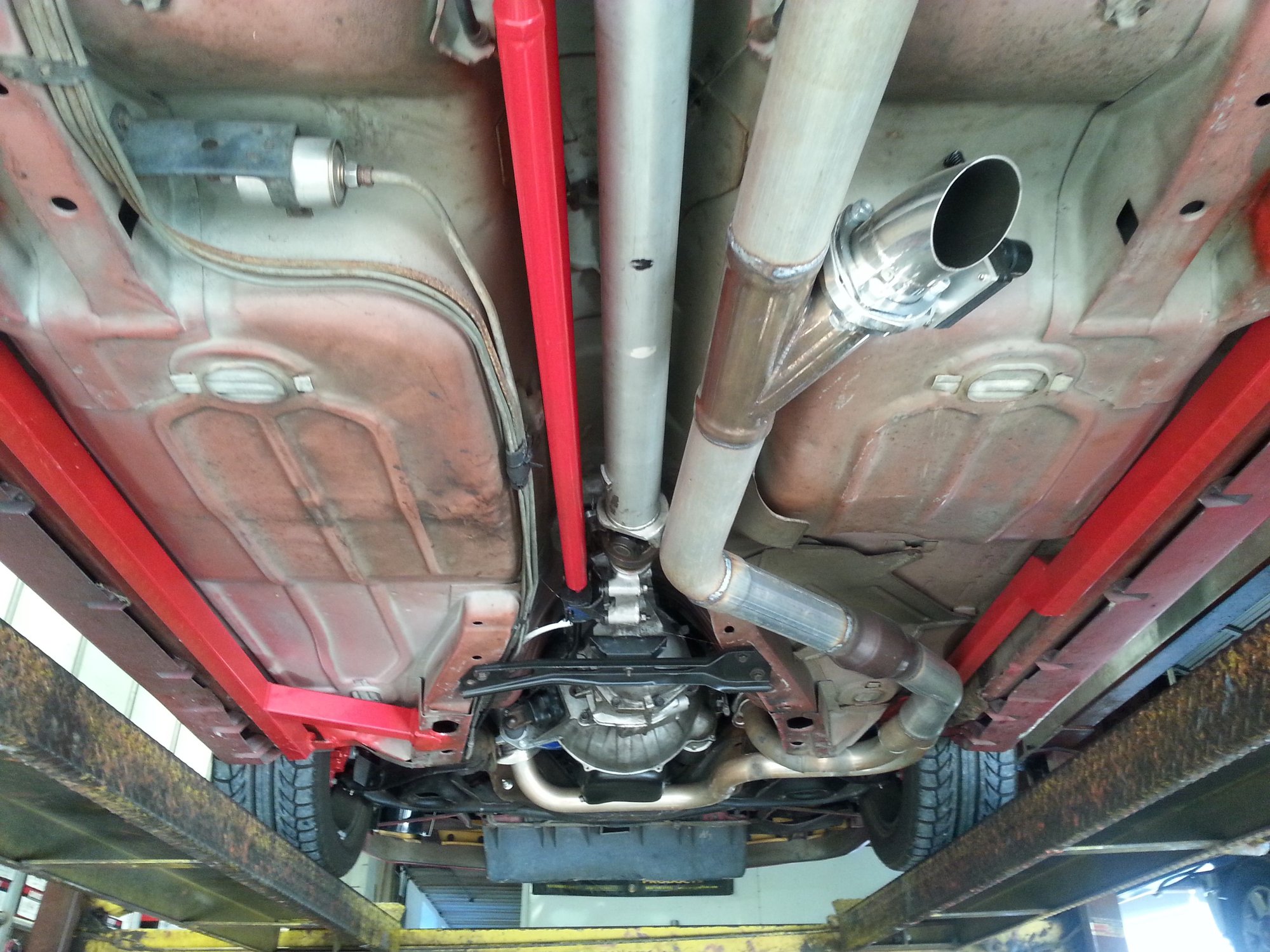

I also have UMI connectors and have been very happy with them. They are one of the brands that box in the body side of the rear lower control arm mount. They do not hang low but they can be seen when you get down to eye level with the bottom of the car/floorpan. However, when you are that low you can see the exhaust, A arms, differential and rear sway bar so I don't see why it matters if you can see an aftermarket SFC.
My only suggestion to UMI is to offer a version of these that is for guys that run an exhaust down the transmission tunnel, ie long tubes. It would just be a mirror of the drivers side connector. I question the effectiveness of that dinky little connector that is to be used in conjunction with the stock exhaust.
My exhaust isn't quite stock, and I couldn't use that connector. Can't really scientifically "test" what the effects of not having it are, but I know the car will teeter on speed bumps.

abubaca... your exhaust setup looks just like mine. I havd the dyno-dons hearders, to his ypipe, then a welded on magnaflow spun cat, to the : echaust with my electric cutout mounted in just the same spot. however, I do not have a turndown like you do on the end of it. I have wanted to, but never did. not sure if you ran the car around without it and then with it and noticed a difference of noise/tone/sound wave reverberating etc?? I should get one, a nice polished or stainless one like you have. what brand is that?
