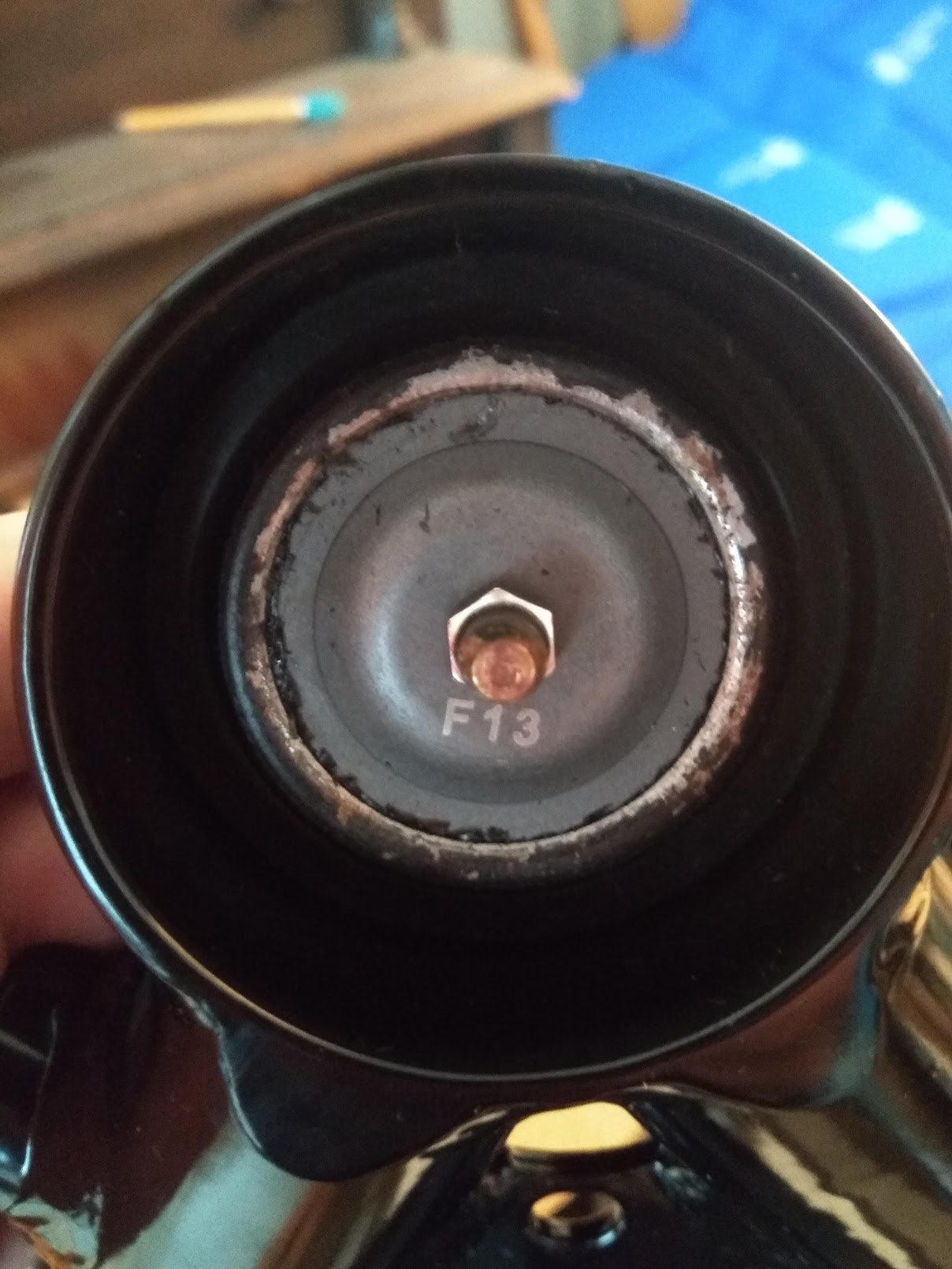

I bought a set of Howe 22429 +3/4" (4.16" total height) extended ball joints and a set of the Spohn BJB-1 ball joint boots to put in my UMI A-arms in place of their UMI factory piece. The Howe 22429 have been recommended several times in different threads, Here is the PDF of the print out they come with: http://howeracing.com/media/wysiwyg/...sPrecision.pdf
And here is are the specs as shown in the Howe catalog (Page 13 in the catalog): https://www.carid.com/images/howe-ra...ct-catalog.pdf
https://howeracing.com/media/wysiwyg...on_Catalog.pdf
Spohn Ball Joint boots: https://www.spohn.net/shop/1993-1997...oint-Boot.html
I went to install these last night but it seems that the stock (GM OE) ball joints are sized at 2" (maybe more exact is 2.080" ?)and the UMI A-arms have an ID that I measured at 2.1". Needless to say the Howe 22429 ball joints did not stay in as soon as you tried to compress the spring by putting the jack under spring pocket of the A-arm.
I found some "oversized" OE length ball joints but they are stock, not extended.
https://www.autozone.com/suspension-...1_45006_0_2940
https://shop.rareparts.com/MNFA3000-BALL-JOINT
Scrounging through Howe's online catalog it looks like a 22437 base or "ball joint -less stud" with a 2243810 would get me the 2.090 OD with a similar overall height of 4.15.
I came across a thread or two where members replaced the stock UMI ball joint with an extended ball joint
(https://www.thirdgen.org/forums/engi...ml#post5460399) but I can't find any posted part number for what they used. Anybody have experience with this?

Thanks, that helps. I was also just about to post that I measured everything out again and am leaning towards that.
Stock Ball joint from O'Reilly measured 2.105"
Ball joint that came on UMI A-arms measured 2.103-2.105"
The UMI A-arm ball joint opening was harder measure. I used a telescoping gauge on three places and got 2.105" and on my caliper I got 2.097"
The Howe Ball joints measured 2.090"
So it looks like I might have received a wrong part from Howe because again, Gman 3MT said he had these (22429) installed with no issues.

Spoke with a UMI employee on the technical assistance line and he confirmed that the ball joints they used are the ProForged standard height (101-10049) or the extended height (101-10048). Of interest was that he said that the engineers told him that the A-arms were made to be able to use a stock ball joint. I asked him how they arrived at that conclusion and he said they used a Moog ball joint when creating it, a K6145t. I had to explain to him that the Moog K6145t (2.105) ball joints are the slightly larger OD problem solver while the normal K6145 (2.090) is the normal OE dimensioned ball joint. I also suggested that UMI put the information about what ball joints they use on their website and possibly stock a few to sell. Nice guy to talk with, hope I didn't come off as rude. I'll give Moog and Howe and summit a call now.
EDIT: The plot is thickening.
I was able to contact Moog and they claim that the K6145 and K6145T are the same dimensions but he no longer had information on the 6145 as it had been out of production for a while. He continually said it's the same thing just the enhanced version. At any rate he said the current offering has an OD of 2.0975"
I also contacted Proforged and was told that the 10049 and 10048 also measure 2.0984" OD

I finally got hold of Summit and found out that they do not have dimensional information for their Summit branded ball joint SUM-77-1130003. The guy did tell me that he believes that they are manufactured by AFCO with a normal K6145t cup and an extended stud. I'll call Afco to confirm now.
EDIT: I had been wondering if UMI made their own ball joint sleeves or just boring the Ball joint hole to a certain spec, I might call and ask tomorrow. Here is a sleeve set for a K6145: https://www.speedwaymotors.com/Steel...yle,49397.html
I would still wonder if they are using this sleeve which shows an ID of 2.09 and has powder coat on it (which should make it smaller yet) why am I repeatedly measuring >2.1"?

So now you have me wondering, what ball joints did you pull out of your UMI control arms?
I ended up digging mine out first thing in the morning and taking a look at them. Every other set that I've seen have had a part number on the bottom of them, these only have an F13 label on them:
I have no idea how to identify them otherwise, they really look like a generic normal ball joint, but since some of the listings seem to show a "total height" I measured as close as I could (they are inset somewhat in the sleave making it hard to measure assembled quickly) and got roughly 3-3/4" from the bottom of the housing to the top of the stud.

Ok, yea, wow, these things are made wrong.
I just took one of mine and "pressed" it apart. The reason that "pressed" is in quotes is that I put it on the press, put a little pressure on it to line things up, accidentally twisted the back side of the control arm down and the ball joint fell out. I didn't have to "press" at all.
If you look at these pictures you can see that the knurling on the BJ was only contacting in 2 places, and if you look carefully at the bore in the control arm you can see that it was only digging into the powder coat on the R/L (the way the picture is oriented) of the bore, not on the top/bottom. Measured, the BJ measures 2.093", and the powdercoated bore measured 2.094" R/L (where the knurling dug into the powerdercoat) and 2.105" top/bottom WITH the powdercoat. Essentially the only thing that is holding the BJ in is the powdercoat at 2 points.
Old Jul 24, 2018 | 07:13 PM
83 Crossfire TA's Avatar
Joined: Jun 2001
Posts: 8,028
Likes: 93
From: DC Metro Area
Re: installing Ball Joints on UMI A-arms
I don't know what to make of this.
It's not like they even sized this for the problem solver joints as best as I can tell. WITH the powdercoating it looks like the bore was right around 2.100" before welding and got distorted when welded. With an average polyester powedercoat thickness of .003-.005", that means the bore was about 2.108", which is about .006" too big for the "problem solver" OD of 2.105 (assuming you're shooting for about a .003" interference fit.
How much does it matter? I don't know. The spring pressure should keep the ball joint pulled up tight against the shoulder, but the fact that the problem solver joints existed seems to imply that play in there could wallow it out and if that's the case you definitely need a positive press fit (around .003" would be about normal). It seems like Howe expects about that tight a press fit, and I would say that is consistent with what I've seen pressing stock assemblies apart and back together again.
Assuming you want the press fit, how do you fix it? Again, I don't know.
That sleeve is too thin to bore it out and make an insert to make the thing fit correctly.
If you used a BJ with a smooth outer shell you could probably get away with dropping it in there with some Loctite sleeve adhesive, but that will then be bonded to the powedercoat.
If you trust the powdercoat the ugly way to do it would be to use about a .010" shim, or if you clean the powdercoat off and leave a bare steel bore you could re-measure, I suspect that you'll need around .018" (if you try to make the shim go the whole way around the BJ then it would be half that thickness but I suspect that would be a bear to assemble).
Is there anyone that works at UMI on this board or does anyone know someone that you can point at my last post and this one? I'd love to hear their input on this. I can't believe that they don't know this is a problem. OTOH, they may have fixed it, mine have sat in a box for a couple of years.
Vindication! I'm not crazy or measuring wrong after all. I remeasured with three different calipers last night and got the same measurements of 2.105. I even measured the calipers with the micrometer and got the same measurements. I had the same thoughts that the powder coating is what is causing the interference fit.
You asked about the size of the Howe 4.16 measurement, that's just the length of the stud. You can put any length stud in as long as the ball is the correct size. I called Moog and they said that unfortunately for me they do not have a master catalog of ball joints by dimension for me. Someday I might just ask to see every ball joint at O'Rielly. I ordered the ProForged extended ball joints that are only 1/2". Should be here Thursday or Wednesday. If they don't have a real interference fit I'll have to call UMI and ask what they are willing to do to help me cure this. I'm not averse to machining down a Howe ball joint but when this began I didn't plan on sinking $200 on ball joints that I'd still have to machine.
I've only done one side, I wonder if the other side will press out if I simply jack the car up under the spring pocket.

FWIW, yours looks A LOT better than mine. You look to have marks in the powder coat most of the way around, where I only have them in 2, roughly 1" long patches, the rest is untouched.

Agree actually. That F13 ball joint does not look familiar to me. It’s most likely before we started using Proforged. That’s why I posted the comment about various sizes and design history through the years.
Also during manufacturing we manufacture the cups (in-house as mentioned above) to a nominal size. Of course they may pull out of round during welding - not an excuse, just how metal behaves. We don’t post-bore the housings at all.
It's obviously distorted from welding, but welding would make it shrink if anything, and if the press fit was correct it would be pulled back round. I see no reason why you should have to post-bore anything if it was close to start with, but this appears to be a case where the bore was way off before you started.
The problem isn't that any of the ball joints have measured undersize, but that the cup is oversized.

The ProForged extended ball joints came in today and they measure 2.103
With powder coat the ID of the hole is 2.105 so the ProForged joints you recommend would have no interference fit.
The parts store normal ball joints also measured the same, 2.103.
I'd like to know what UMI's solution to this is now that we know the ball joints do not or will not allow a proper interference fit. For me, spot welding a perishable suspension joint in place is not an option. The best option might be for UMI to offer a return shipping label so they then be sent back for the ball joint sleeve to be bored out and a new one of the appropriate size welded in and then the ID checked before mailing back.

My Summit Racing, 1" extended BJ's just showed up:
  • These things are Made in the USA and BEAUTIFULLY machined. They are really doing these things a disservice by not having the correct picture up and not labeling them Made in the USA. I'm guessing a small shop somewhere also, they came in a proper box but wrapped in newspaper
  • the OD of the seat measures spot on spec- 2.093"- I can push them in with my hands upside down.
  • Why upside down? Well the shoulder that it's supposed to seat against is 2.366", the bottom wide side of the step in the cup measures 2.377" most of the way around, but there is one spot next to where the rear tube is welded onto it that is distorted down to 2.360, so I can't just push it in the pocket. Not really a big deal since that difference is less than the thickness of the powder coat, but I don't want to start removing powder coat till I know what is happening with the rest of this.
  • FWIW, if anyone cares the OD of the top of the housing is 1.874", so if you want to run a rubber boot with these you'll have to find one that will go over that. I measured the boot seat surface on the mystery ball joint that came in the UMI arms and that's 1.600" so I doubt any amount of grunting and swearing won't make that go.
So again, not a problem with aftermarket parts, these are spot on spec. The cups in the UMI A-Arms are just wrong.

That's what I've been saying. I'm not even sure that we have evidence of a ball joint that is out of spec, I haven't seen one. Heck, the one that came in my control arms is dead on and fell out of my A-arm.
