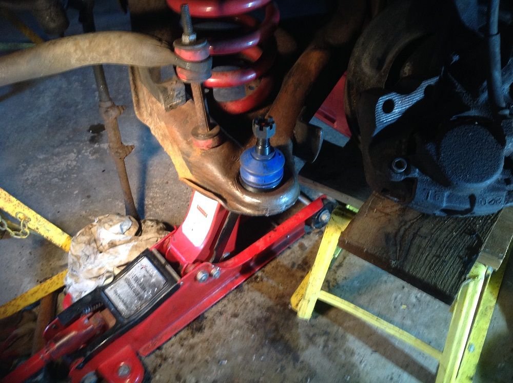

Thanks Guys for the advice, as you can see one fitted, just got put strut back in now
