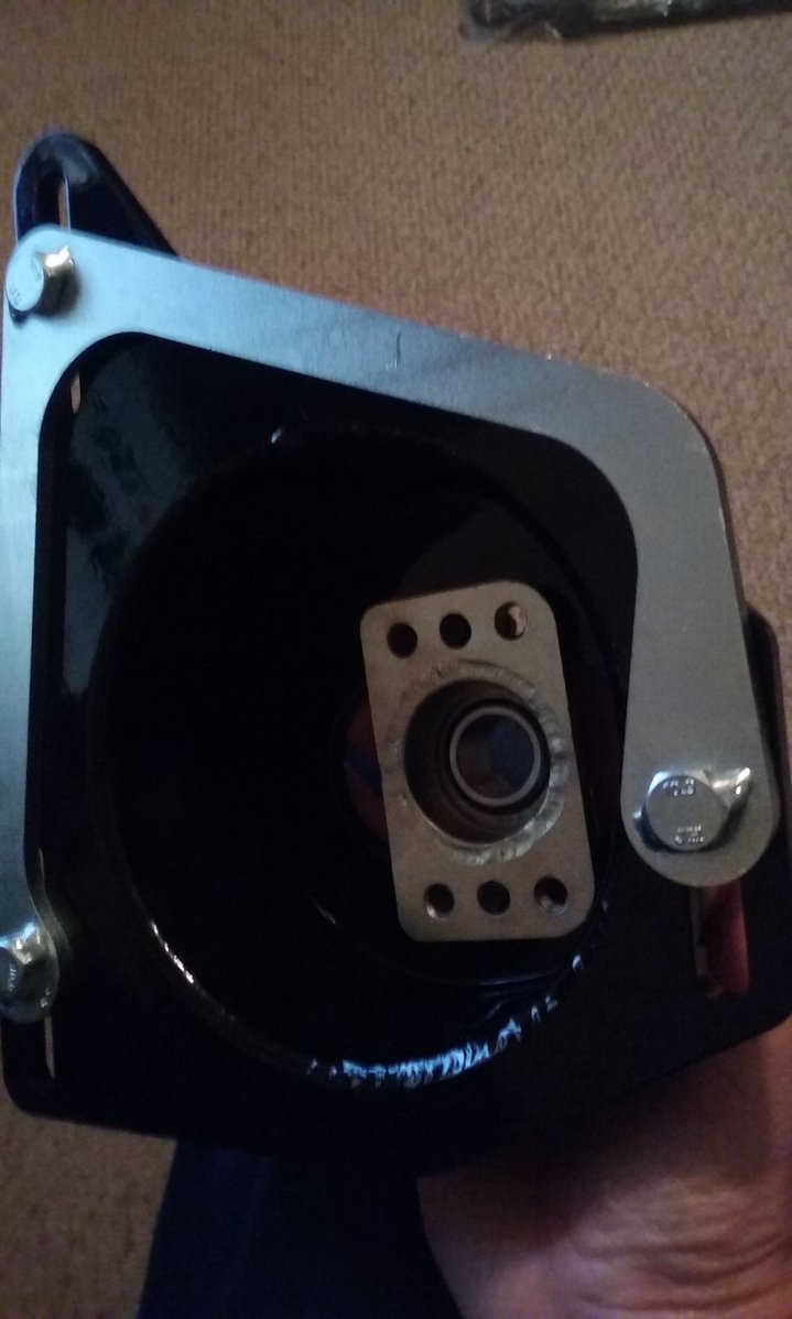

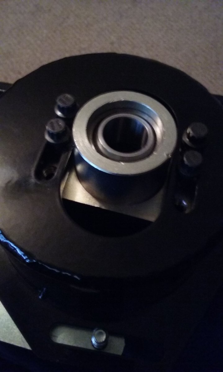

Old Mar 24, 2020 | 06:33 PM
Tidan's Avatar
Joined: Jun 2009
Posts: 231
Likes: 38
Re: upper strut mount
I have the UMI's sitting in front of me....looks like the bearing is easily replaceble and appears to have a semi spherical inner race allowing it to pivot.
