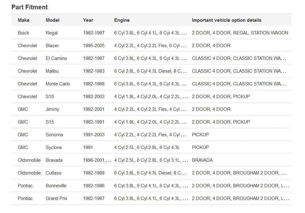

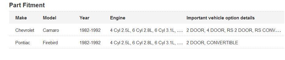

Originally Posted by chrias
Or you can get 82-03 S10 2WD control arms with new bushings and ball joint from Rockauto. I bought control arms for mine for when I do my air suspension.
How closely have you compared the light truck control arms to thirdgen control arms? They look similar, but the part numbers aren't the same. Just in thirdgens the steering stops vary, and there are three different part numbers. How did you reach the conclusion they interchange?
According to GM, The S10 arms crossover to G body cars. Thirdgen arms only crossover to thirdgens.
