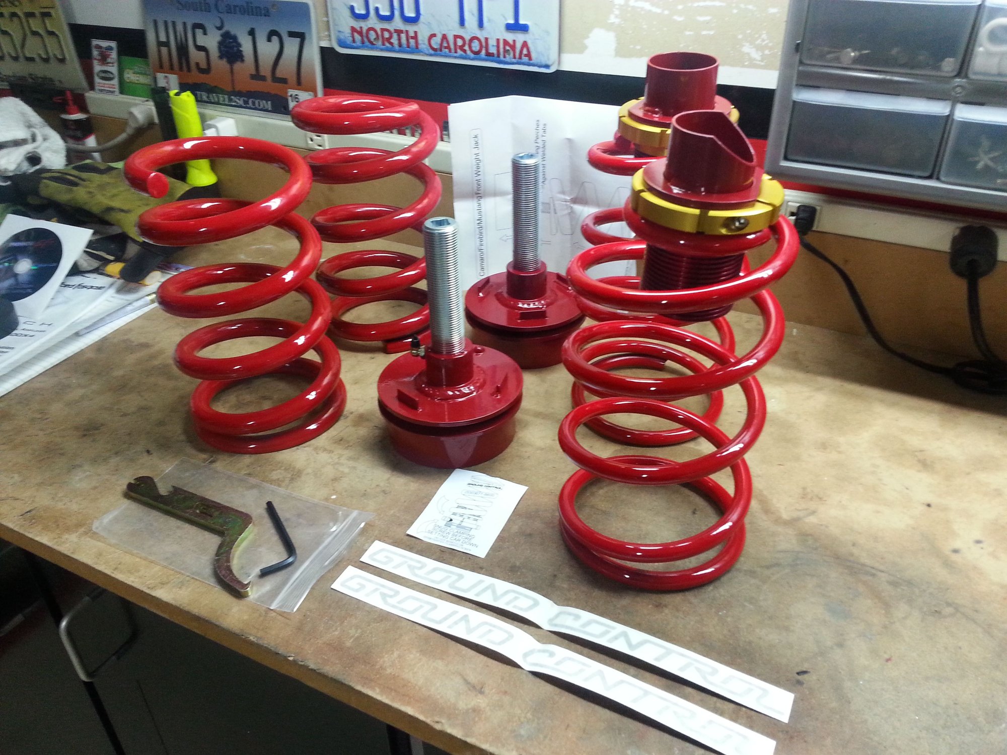

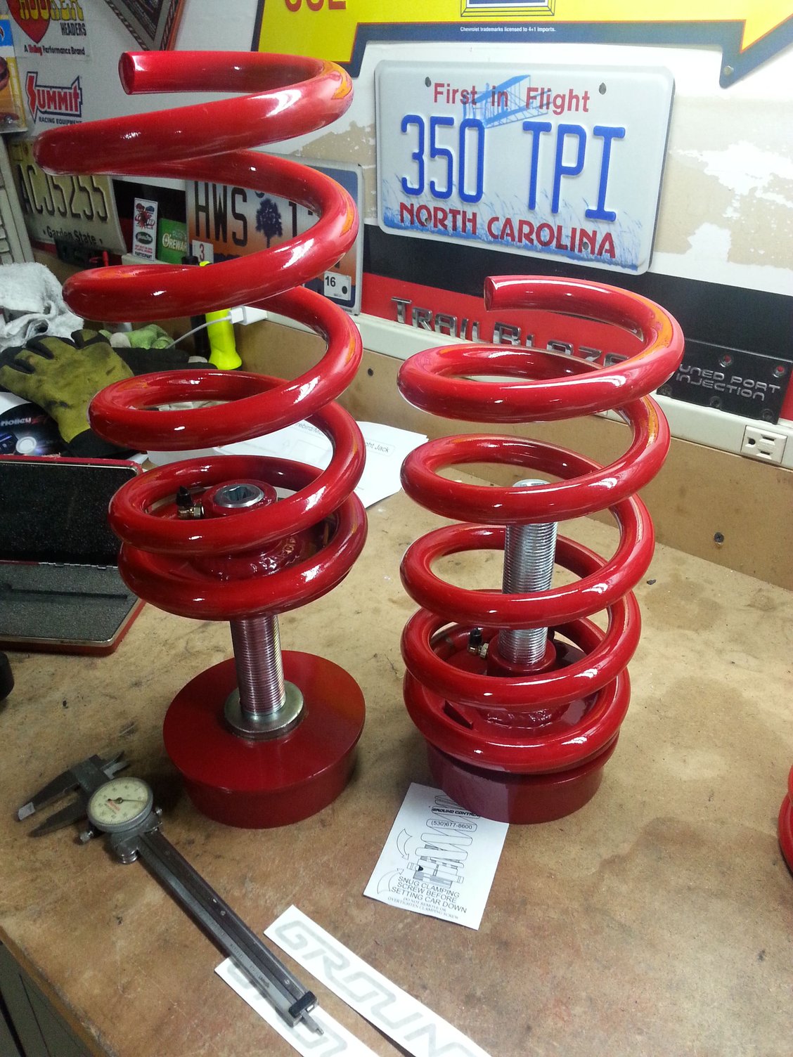

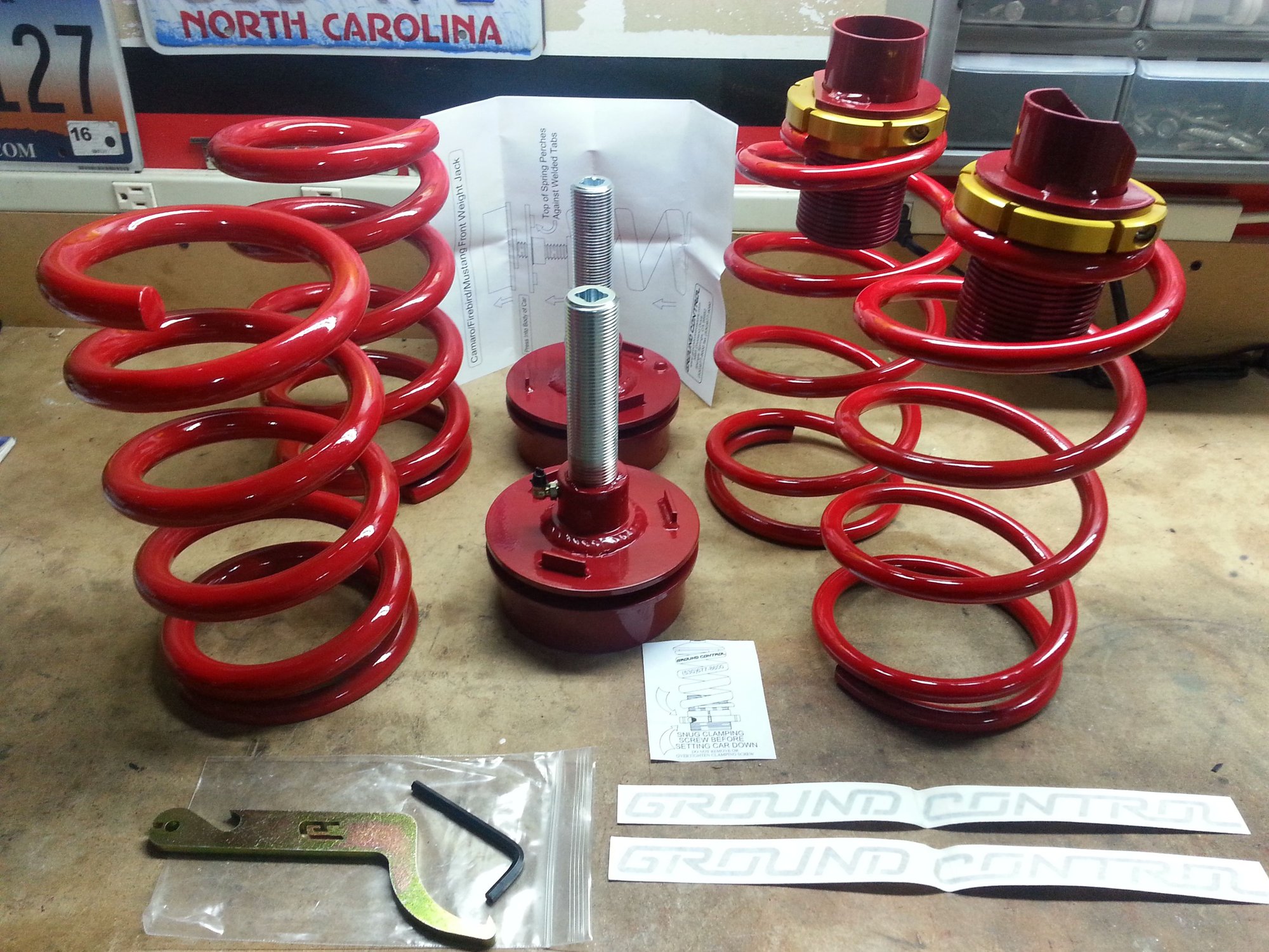

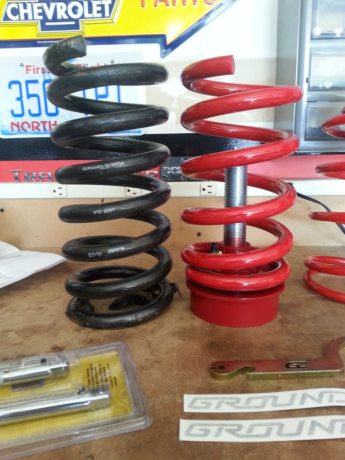

I have the Ground Control weight jacks. They come with all four corners. Different spring rates are available. If you go this route, give 'em a call and ask for Donovan. This was my first set GC weight jacks. The black spring was the Eibach prokit front spring. GC spring is shorter, but of course the jack isn't in that photo. It really does help you dial in. Cost as of my last kit, ordered a month ago, was just under $600.

Not my BEST picture of my 89, but arguably my favorite. Front fender sitting right at about 25 and 5/8".
