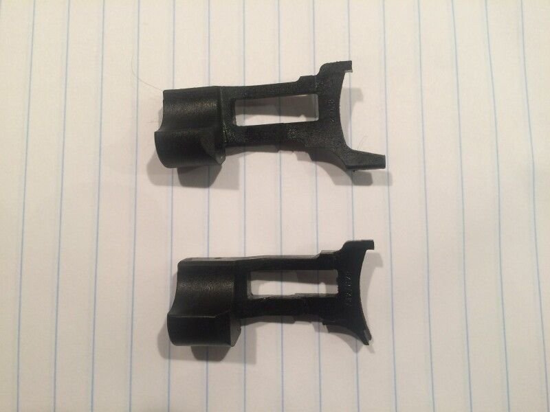

New after market actuator on the top in the pic and the factory original on the bottom. Notice the extra tab on the bottom right corner of the new one.

Never even seen one that wasn't factory out of an original column. Must be a revision to help hold the push rod better
