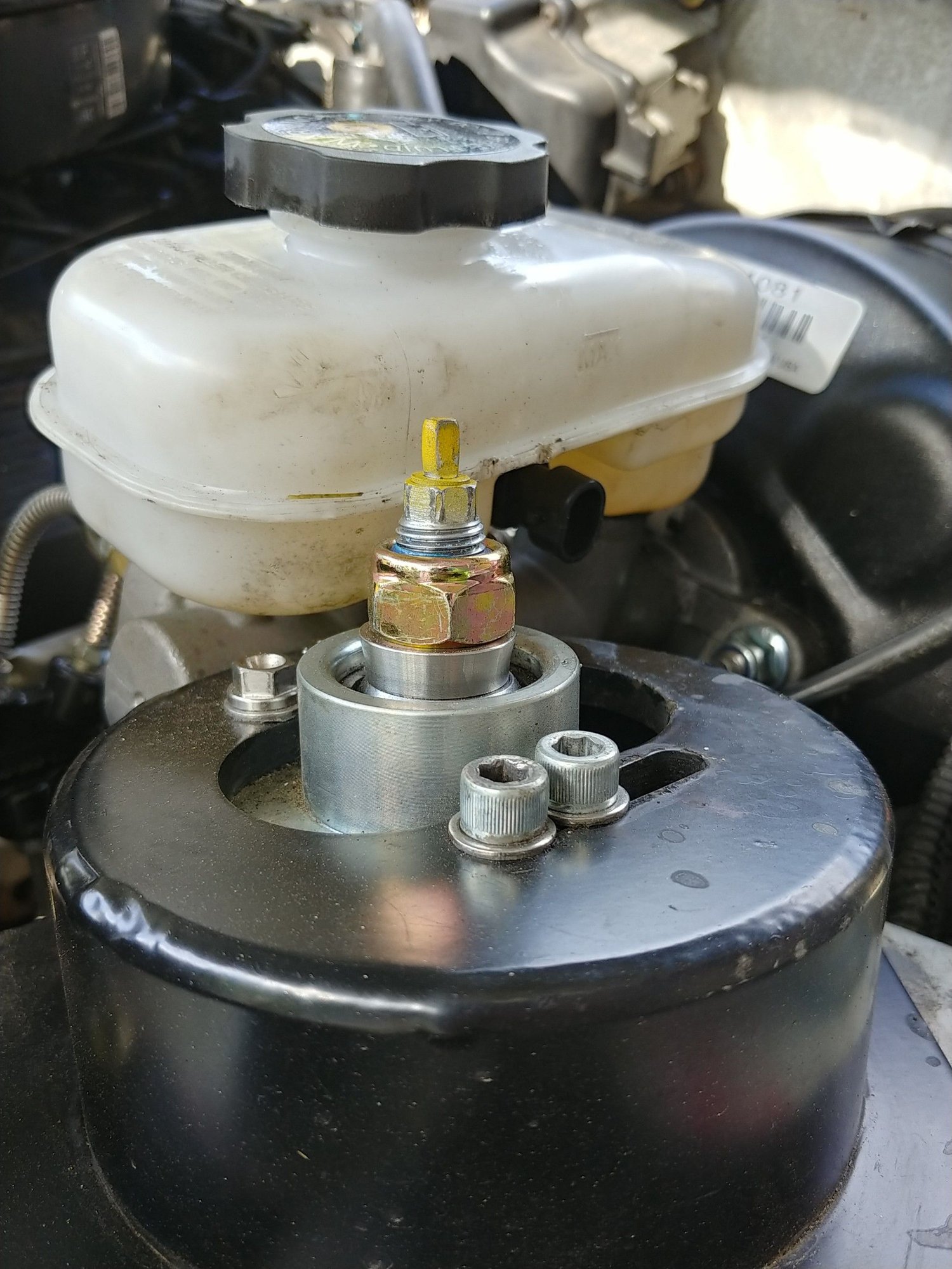

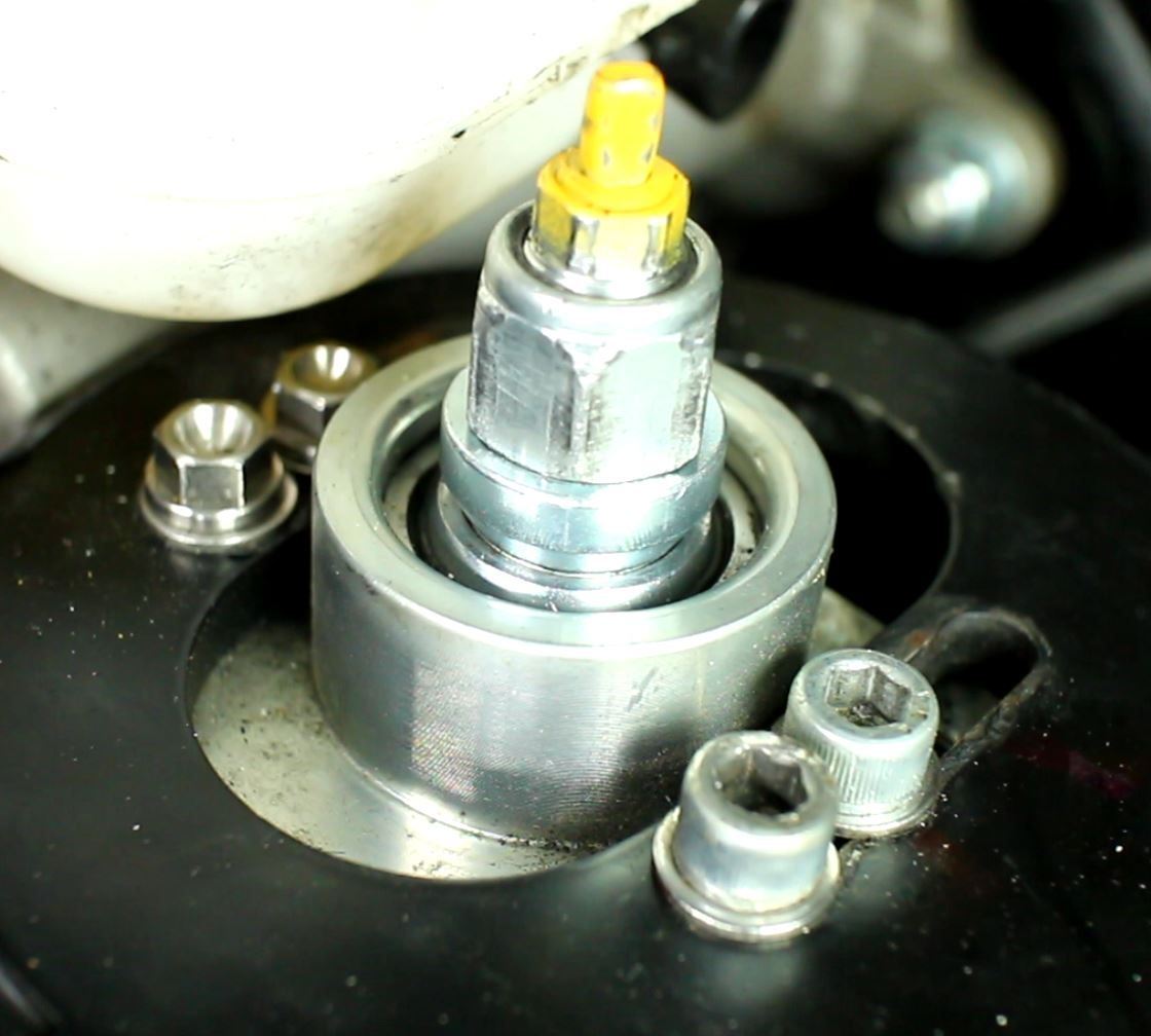

KONI also recommended running a tapered rod end Spacer on the top of the strut mounts.
Ground Control strut housing and the old insert
Shock Dyno Plot of the KONI RACE Double ADJ 8611-1259
DIY 14mm (9/16in) tapered rod end spacer

On the closeup of the bearing mount it looks like you are capturing the reducer sleeve but not the actual bearing with the tapered spacer. I would make sure you are on the ball of the bearing itself before that sleeve starts to move on you.
Old Feb 8, 2021 | 05:00 PM
McLovin1181's Avatar
Joined: Jan 2014
Posts: 387
Likes: 143
Re: Ground Control Koni Strut insert replacements
The pic is a crappy rod spacer I made on a wood lathe ha ha.
I wasn't able to fully engage the flat ends if the mono ball.
Although the taper isn't inside the mono ball hole.
I have a nice tapered spacer being machined from 316 stainless as we speak.
A 3d printed model before it's machined from stainless. Fits the mono ball perfectly without hindering travel.

McLovin, didn't you post the dimensions of this spacer somewhere, I'm wanting to do this when I finally get my Koni's.
Old Mar 18, 2022 | 03:42 AM
Joined: Jan 2014
Posts: 387
Likes: 143
I have the F3d. file, I can email it to you.
you can contact me on Instagram easily or a private message here.(although I'm not very active here)
some quick ghetto numbers:
inside diameter: 0.555in
larger outside diameter: 1.0in
smaller outside diameter: 0.9in
overall height: 0.3in
I think the taper was 7 degrees, but don't quote me on that
it was set up for the KONI RACE struts that have a 14mm threaded strut shaft.
IDK what threads the normal Koni yellows use.
Pic of the finished 325-stainless mono ball spacer
