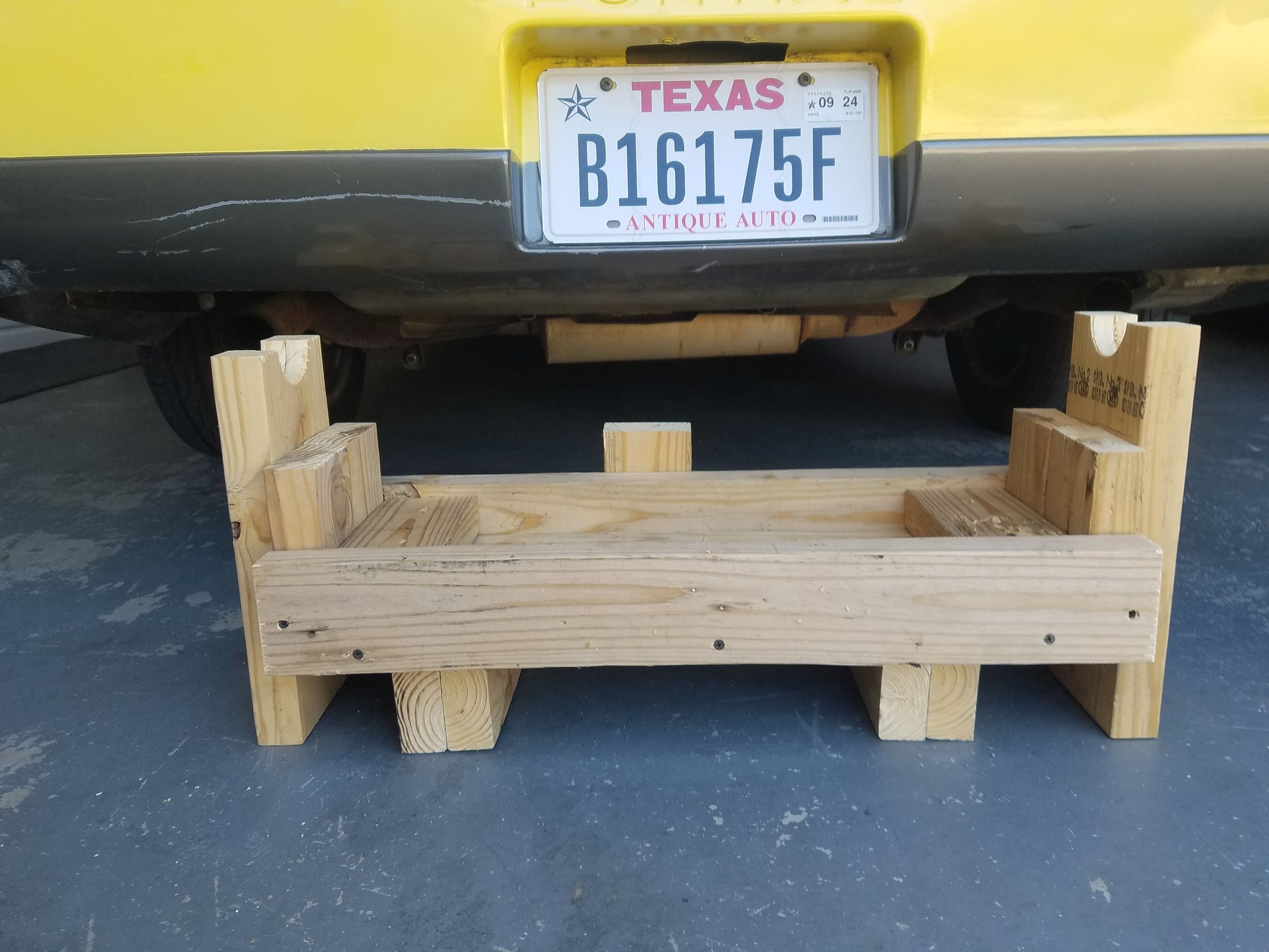

The one item I spent a bit of time thinking about was a way to move the rear end around once I got it out of the car. It was going to be moved in and out of the garage to the driveway for cleaning, plus suspended from my engine hoist for painting. After taking some measurements, on the back of a scrap piece of paper, I designed up a cradle to support the rear. With all the new home construction in the neighborhood, I hit the jobsites for some scrap 2x4s and through this together:
Rear end cradle. Was very proud of the hole I drilled into the top that would support the tube. It ended up being just a shade too small, so when I had it on the hoist for paint, I cut the holes into a shallow V-shape. Worked much better. I also screwed on longer 1x4 boards to make it more stable in front to back motion. The stubby pieces that were the only supports made it easy to tip forward.
Picture of it in action after removing the rear from the car. To ease transportation, I got it hoisted onto a regular furniture dolly purchased years ago from Harbor Freight.

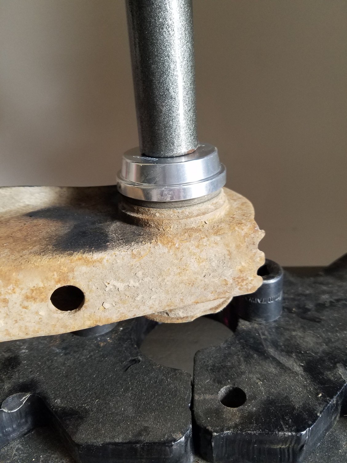

The only other part that required a bit of work was removing the bushings from the lower control arms. For the front suspension, I had cut apart some pipe and made sleeves to keep the arms from getting crushed while pressing the bushings in and out. That seemed like a lot of work, so on the rears I first tried jamming some sockets between the walls of the LCAs. That ended up working fine.
Some strategically placed sockets on the base and inside the LCAs helped keep everything in shape while pressing out the bushings.

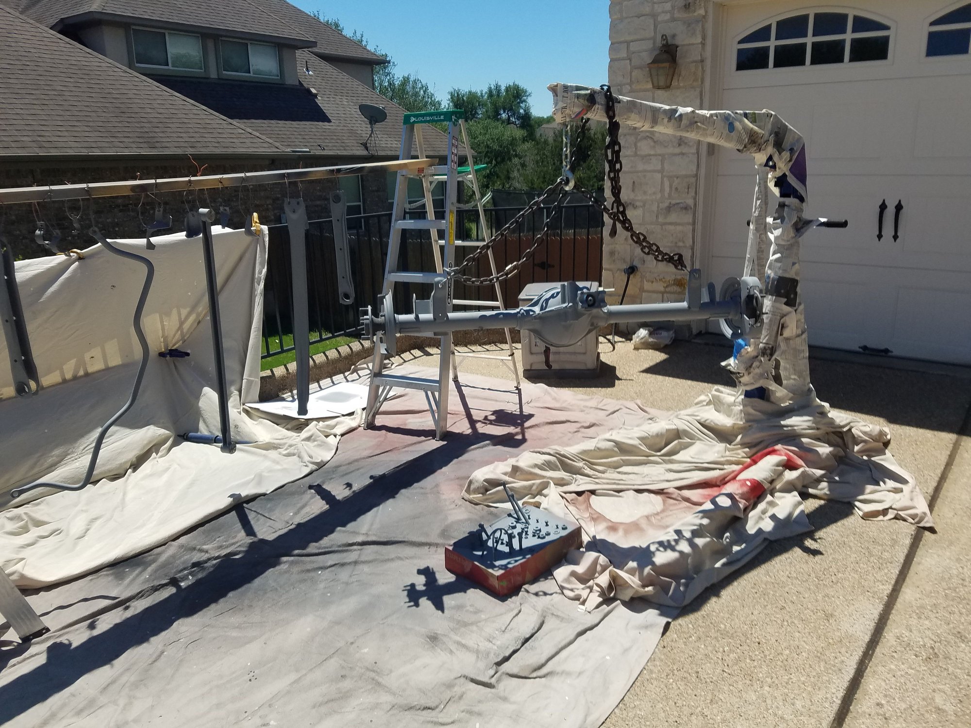

Won't bore the group with pics of the parts cleanup, nothing to learn there! Here is a pic right after primer. Outdoor paintbooth - good for suspension parts, but wouldn't want to use it for anything anyone would actually be able to see!
For paint, I used the same material I had on the front. Majic oil-based enamel from Tractor Supply, plus matching primer. This time, I mixed hardener in with the two top coats. These parts turned out a bit better than the fronts, I think. Wish I'd used the hardener then. Sprayed it with my cheapo HF HVLP gun. Wish I knew how to paint better, but this gun works fine for hidden parts like suspension.

Better picture of the sockets on the inside. For installation, I rented the Ball Joint tool from OReillys. It had the right-sized cup to fit on the outer, metal edge of the bushing.

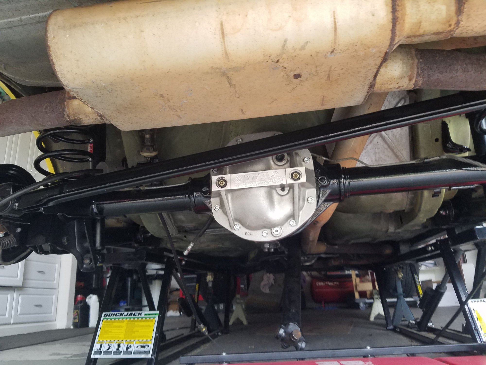

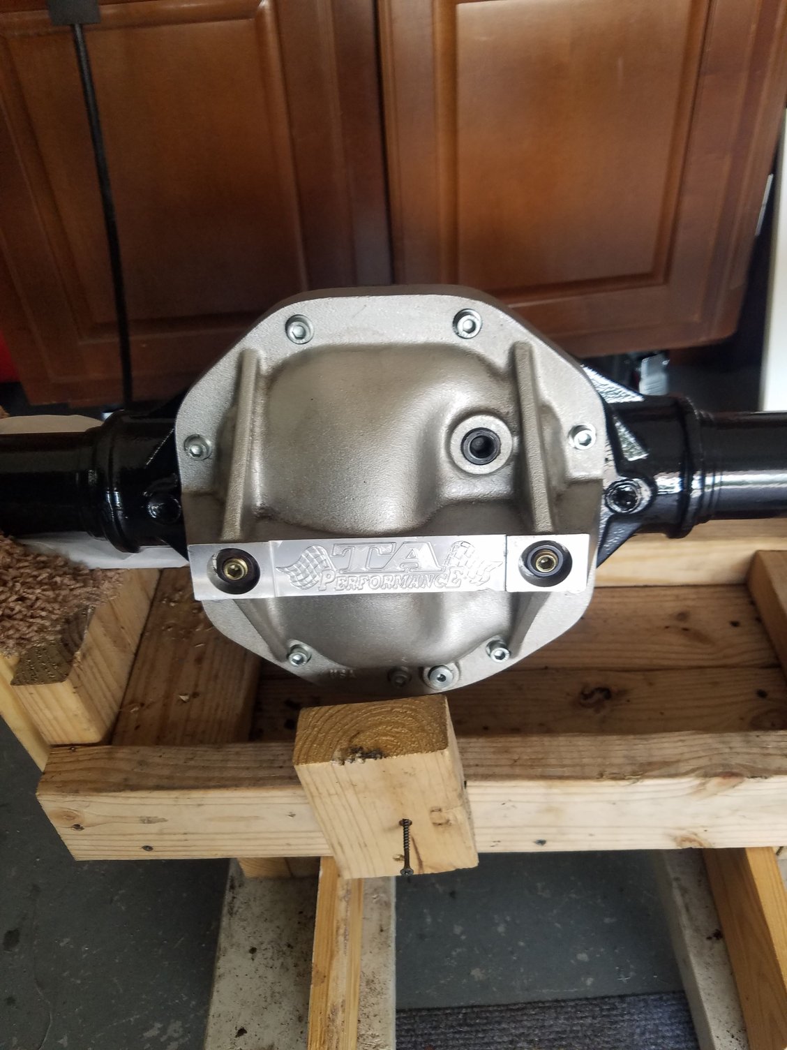

One of the parts I have had waiting on the shelf for almost a year was a girdle from TA Performance (PN 1802) for my 9-bolt. Since the car isn't driven hard, this is vast overkill, but the price was low enough that I picked it up to add some bling. My old cover was a little dented on the bottom, but worked fine.
Oooh, shiny!
Here is everything mostly installed. Sway bar still had to go on and brakes bled.
