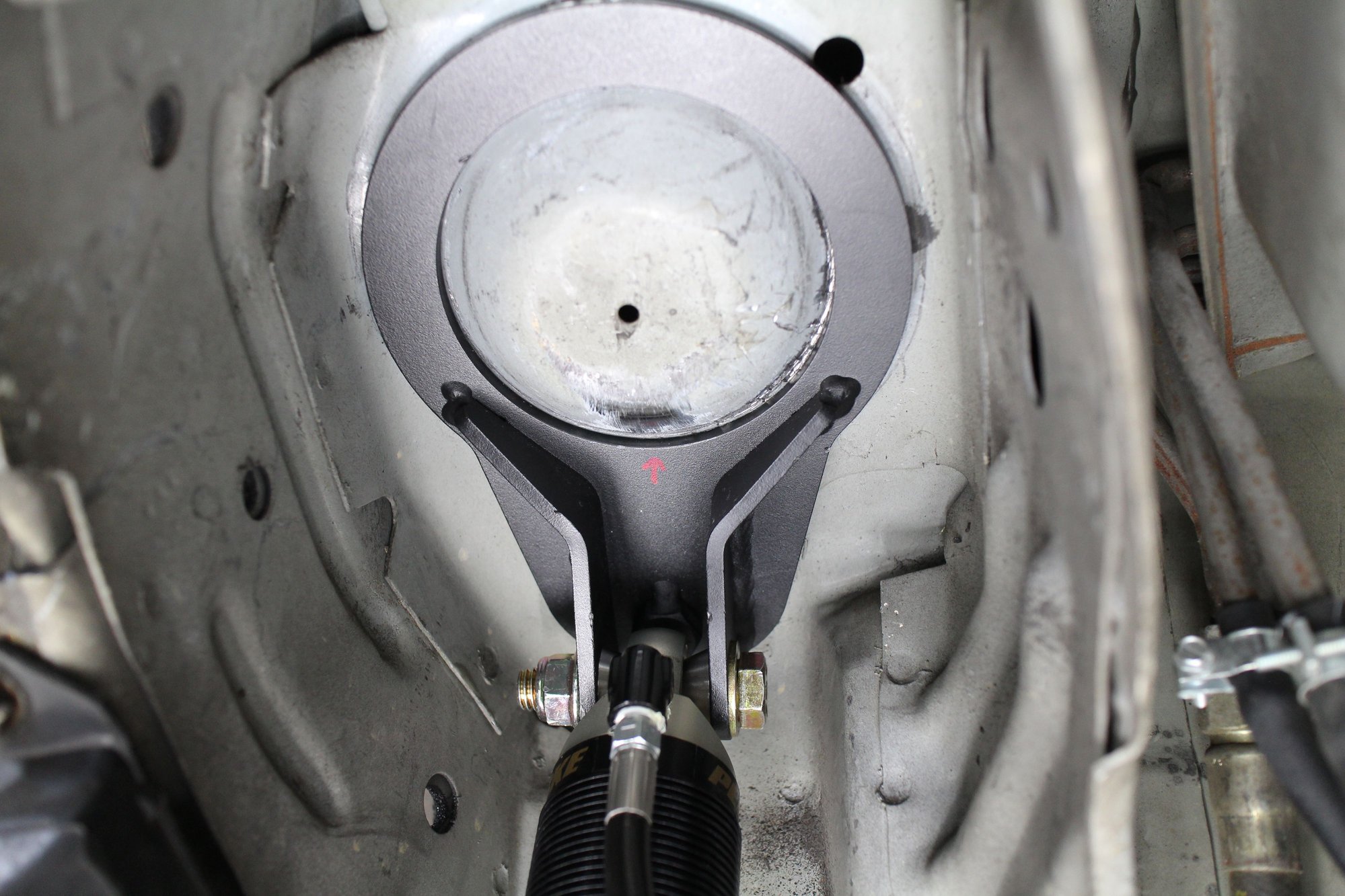

Originally Posted by 83 Crossfire TA
OK, but the coilover kits that I mention come with brackets to transfer the load to the spring pocket.
It uses the Original Shock hole and an additional hole as well as a place that goes into the pocket.
https://www.umiperformance.com/home/...hocks-bolt-in/
Its like the 4th picture.

You know, I've never taken a hard look at that area/the way they're mounting.
  1. I'm not sure that that ring in the spring pocket is adding anything significant unless you do something like weld it in, and even then I'm not sure how much it will do
  2. it looks like the spring pocket and the shock mount use the same lower sheetmetal, the shock mount has multiple layers in it above it, where the spring pocket has those same layers separated. I wouldn't be surprised if the shock mount is actually stronger than the spring pocket.

400# springs? Is that a typo? What kind of car is it?
both of the thirdgens run 400 lb springs on the rear coilovers. Yes, it's a stiff ride. Yes, it sticks in the corners.

Originally Posted by McLovin1181
The #1 mistake I see people make for road race an AutoX cars is not using enough rear spring. Depending on if your panhard bar is relocated, it's usually north of 275+lbs even more of you get real serious.
Agreed. For street I'd say 250+, but your definitely in the ballpark here.
The improved angle of the rear coil-over is a help, but probably minimal. With strong brackets, definitely an improvement. Don't think twice or over think it. Adapt to the new tech and take advantage of its adjustability! Just buy with knowledge of operating range.
