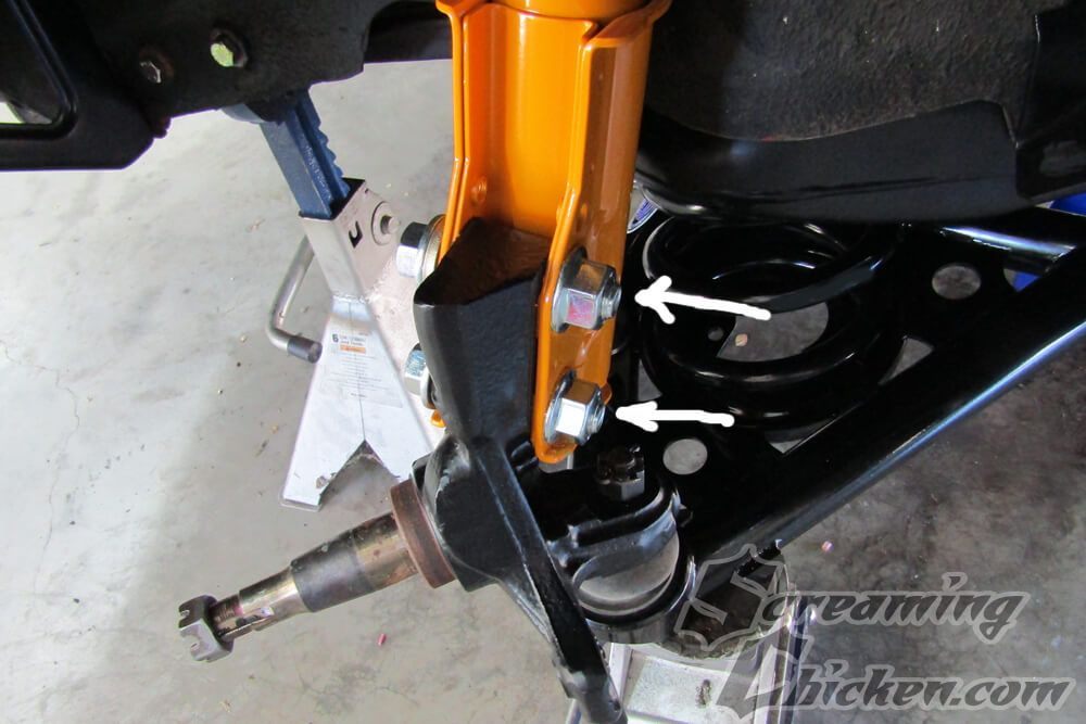

I am in the process of buying my first 3rd Gen still and starting to pick up little stuff here and there for it. I am wanting to order some bolts for my Jeep anyway so I thought I'd grab the spindle to strut bolts too. The best I can tell is they are M16 x 2.00 x 70mm. Does that sound about right on the length? My choices are 65mm, 70mm or 75mm

16mm x 75 grade 10.9. Don't know the thread pitch

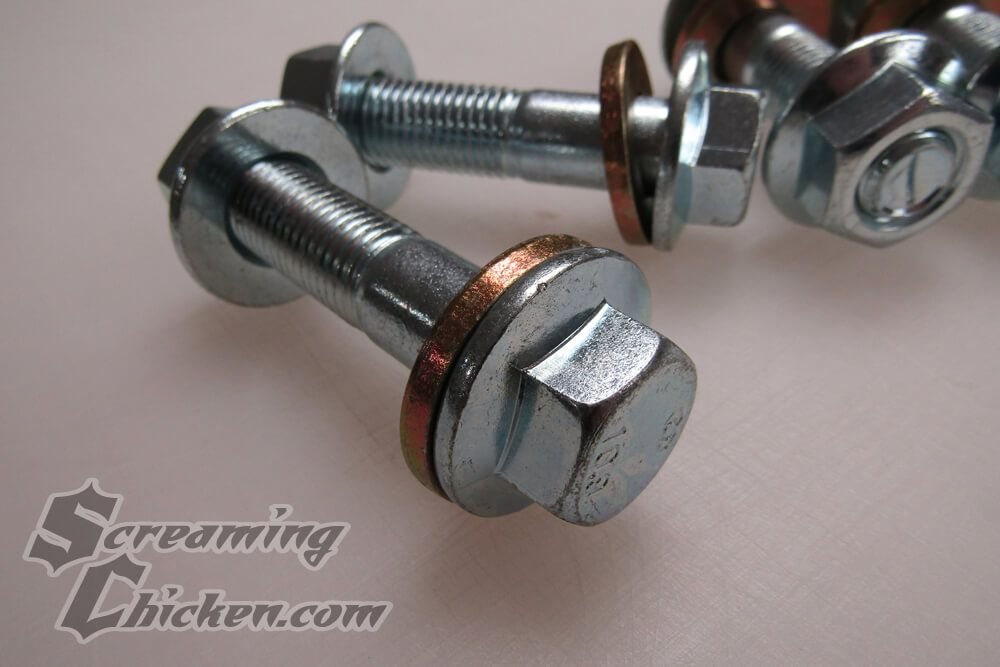

We sell a Strut to Spindle Hardware Kit. The hardware in the kit is an upgrade over stock, we have tested them past the 195 ft lb. torque rating with not issues.
1982-92 Camaro/Firebird Strut to Spindle Hardware (screamingchicken.com)
I didn't know you were a sponsor here, though honestly I haven't been active in a while. You guys have a lot of good stuff, ive ordered a few things from you online recently and will be back for some more!
