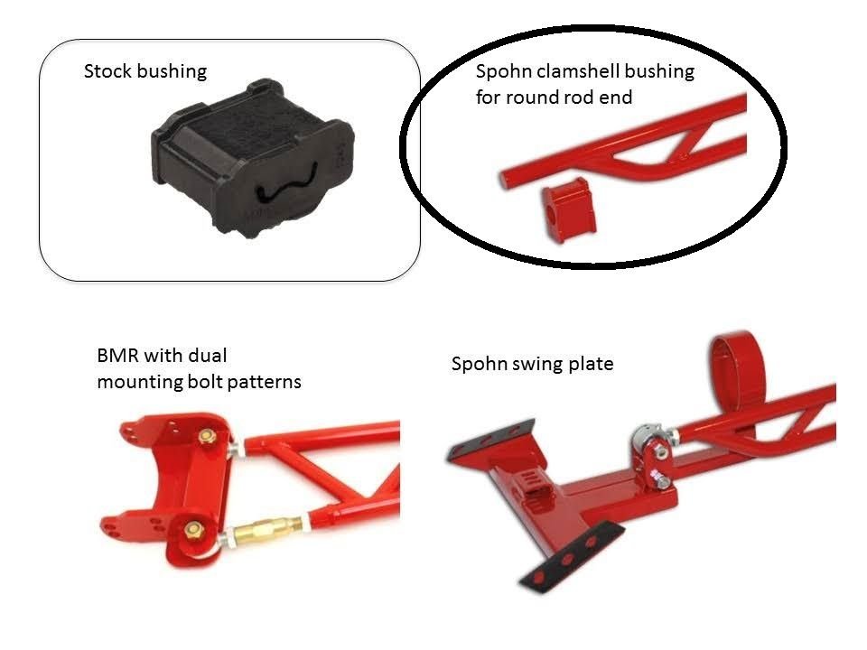

Traditionally a tunnel mounted TA has it's own crossmember that's fitted roughly mid way between the trans and differential. It's shorter than the OEM version and as such will impart different characteristics on the suspension. Think instant centre.
I do see though that there are some that incorporate the transmission crossmember and then relocate the the front TA attachment further down the the tunnel.
The pictures above are UMI's with an independent crossmember. They also make a trans crossmember type with they also call tunnel mount. That is kind of confusing and somewhat misleading.
As for the Hawk's version posted above, seeing that there's a transmission crossmember in the picture, it's a safe bet that's it's not a true tunnel mount. They do divorce the TA from the transmission though.
That said, the shackle style front pivot tend to problematic on the street. Evidence points to them being noisy and having a tendency to bind. @QwkTrip
An excellent torque arm thread by Mr. Q is linked below.
https://www.thirdgen.org/forums/ltx-...s-3rd-gen.html
From some of the high powered third gen racers I've talked with, the preferred front attachment is tubular. @vorteciroc
This would also be transmission crossmember mounted.

Seems to be the case. But they're not alone. UMI does the same thing. They offer two styles both called "tunnel mount". One comes off of the transmission crossmember with a TA mount extension rearward. The other has it's own crossmember (as pictured above).
That's something I've learned today!
With respect to the forward bushing or shackle, you have to consider that the arm not only moves for and aft but also radially. I can see where the tubular style bushing would be functionally the best if you had to turn as well as going straight.

EDIT: Digging deeper, I see the picture of the separate torque arm crossmember and TA is actually for a 4th gen.
That said, there are real tunnel mounted TAs available for our cars. I've seen them.

So that UMI I posted, is that considered a shackle mount? Maybe this is the way to go https://www.hawksmotorsports.com/82-...i-performance/ as I don't want to hear clunking and banging. I believe this setup just moved the TA off the tail shaft and uses the factory style mount.
Yes, the UMI first posted is a shackle style.
The crossmember just linked is a relocation crossmember as you believe it is. It'll require the bushing that's specific to the TA you get. I've Holley/Hooker's version of that crossmember. I've a torque arm that has the "W" shaped end with a bushing to match and the bushing fits into the clamshell hardware provided. Might even be that the Spohn round ended TA (top pick in this camp) and bushing would work as I think all of the bushing have the same dimension regardless of style ("W" left and right orientation and round).

Now it all makes sense. BMR and UMI have the setups I'm looking for. Thanks for clearing that up. Strange though that the adjustable ones are cheaper than the fixed ones. You'd think that would be the other way around.
Seems to me I may have made it even more confusing!
But it appears that all "tunnel mounted" torque arms are not created equally. I think a better definition of the categories would be: transmission mounted, crossmember mounted and lastly tunnel mounted. The latter having it's own crossmember. Placement of the crossmember however is brand/model specific.
I've a modified OEM transmission crossmember made to provide maximum clearance for my Y-pipe (from long tube headers). If all goes to plan, it'll be another trip to my favourite chassis shop to have that trans support further modified to accept the torque arm.

UMI's terminology is causing confusion because there really are "tunnel mounted" torque arms that are completely different from what they are selling. When words fail, just look at the pictures.
The only true bolt-on products (regardless of manufacturer) are arms that mount to stock location on transmission, or a "relocated" mount that is fixed to a new transmission crossmember that comes with the kit. All other styles of torque arms will require you to weld or drill holes in your car to make provisions for the front mount.
If the front mount has a 2-piece clamshell bushing, then it is a slider type (similar to stock). This is preferred.
If the front mount has a round bushing for a thru-bolt, then it is a shackle mount (swing plate).
If mounting to stock location on transmission, it will always be a 2-piece clamshell bushing. If mounting to a "relocated" position on the transmission crossmember, the mount style will vary depending on what the manufacturer chooses to sell.
Sometimes manufacturers (but not the case with UMI) offer weaker and stronger versions of torque arms. If you get an adjustable torque arm (meaning there is adjuster to tilt the axle pinion angle up and down), and there is a choice of weaker rod ends versus stronger rod ends.... then ALWAYS get the stronger version with the bigger, stronger, higher quality rod ends.

Thanks for the info. Definitely going with the cross member relocation mount vs the shackle. I'll lose my mind with the banging and I'm not racing the car.
Indeed!
I very much feel that a Tubular-End for the Torque-Arm, is the way to go.
The Shackle Style End Torque-Arms have been problematic, even with lower powered Vehicles.
I have found that there are many situations where the Shackle will get into a bind...
Rendering the Rear Suspension into a position of Traction Loss.
Unfortunately there is NO Perfect Design for the Front Mount of the Torque-Arm...
They all have issues, but I find the Tubular-End to be the least Problematic.
The Transmission Cross-Member mounted Torque-Arms provide a solution for those that can not Fabricate (themselves), or have Sub-Frame Connectors.
That's all I really think about them, as they are acceptable... just not ideal.
Ideally, I would more so prefer a dedicated Cross-Member for the Torque-Arm.
However, the dedicated Cross-Member should be close to the Transmission Cross-Member.
Trying to keep the Torque-Arm as long as possible (the Leverage here is the Main Benefit of this Design Rear Suspension)...
Is very important!
Having proper Sub-Frame Connections and a Uni-Body/ Frame that is tied together into a harmonious structure is critical.
I would like to have the Drive-Shaft Safety Loop attached to the Transmission Cross-Member, but that's it.
Some Racing Classes will want to see Dual Drive-Shaft Safety Loops...
In this situation, I would attach the Rear Drive-Shaft Safety Loop to the Torque-Arm.
