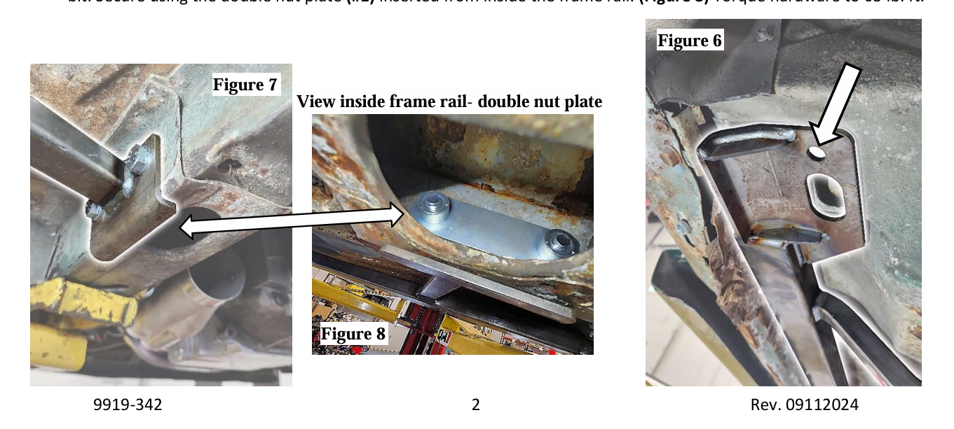

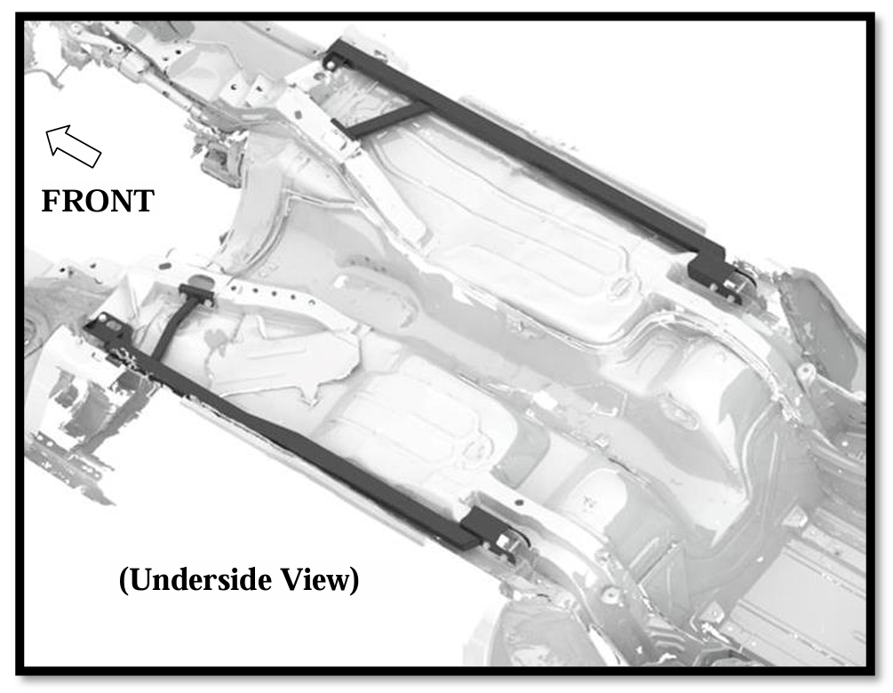

I really like the way the new QA1 SFCs look, and I'm doing crazy mental gymnastics on whether or not I should pick them up. They look very substantial and are probably the best bolt-in SFCs that we've ever had available for these cars.
Has anyone had the chance to try these yet? I've liked every QA1 product I've used for my other car, but I've never used any of their F-body stuff.
I've already got a set of UMI weld-in SFCs I've been procrastinating getting installed for years, still in their box leaning against the garage wall where they're not much use. If I didn't already own that set, picking up QA1's would be a no-brainer.
I'm mostly just curious to see what TGO thinks of these new SFC offerings. Here are some images from the installation manual .pdf, their attachment points look very good.

i think they look great and would likely use them on a next build, i would though likely add some welding on them as well as the bolts especially on the connections towards the front

I have to agree with you, I feel that while the connection at the rear and by the transmission crossmember look very substantial, the front connection only being 1 bolt on each side doesn't. And with how large the contact point is on the passenger side, it's almost like it should be welded on.

My car was the one used for scanning and fitting prototype and first-run products from the new line. The subframe connectors are great. They were designed to be bolt in but could easily be welded as well. With control arms the kit can get expensive but there is also no welding required if that's something you're searching for.
