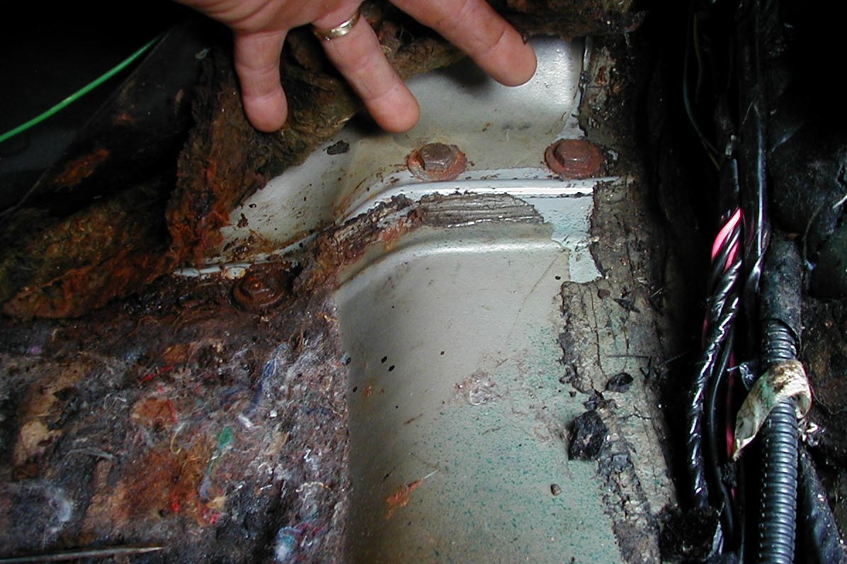

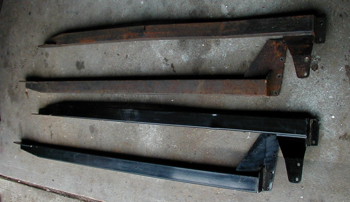

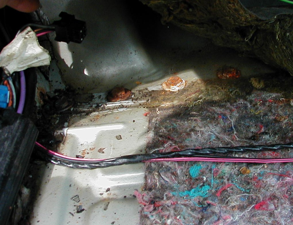

I've had them installed for over 25 years and highly recommend them. The car was a daily driver for years after they were first installed around 98' till they were removed / replaced in 2011 for a second new set.
Bolt in only; there was no bolt-hole elongation - anywhere. My ride is also a T-Top car that's had more than 1 well-built (325 & 350 HP) engines installed and I also found no cracks on the body pillars when I brought it to bare metal around 2013'. While I will never claim to be a racer, but I'll admit to driving 'hard' from time to time...........
The pictures are from when I was about to replace set 1 and install set 2.
Here's how the second set looked a few years ago.....
The 4 tires MUST be on the ground when you final torque the bolts ( Suspension must be loaded ) !!!
Install the SFC at the rear of the car first,........ snug the rear control arm bolt; then raise the SCF on each side and mark the front holes. Regain access, drill, drop bolts in front / snug nuts, torque rear bolts, torque front bolts, enjoy.
They will stiffen up your ride - a lot ( IMO ).
