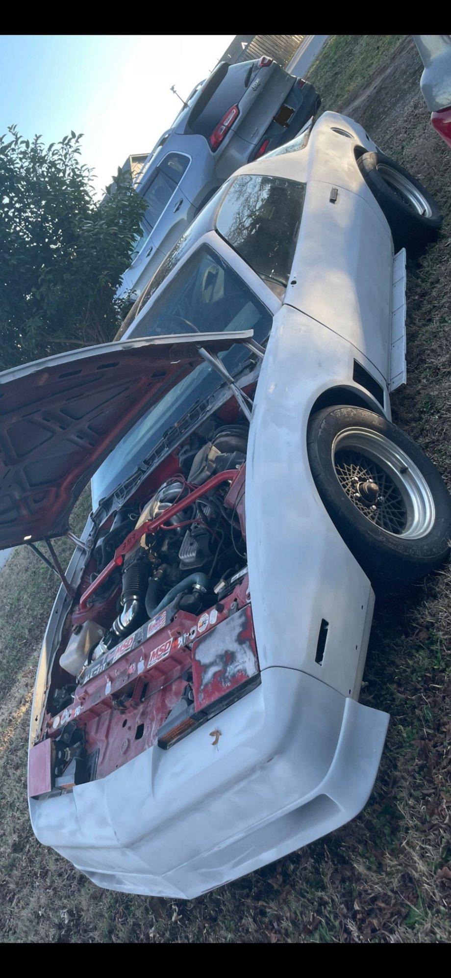

So, I just picked up my first 3rd Gen that's got a straight body almost ready for paint, t tops with no rust and a bunch of suspension upgrades and bolt ons for cheap. Still has the 5.0 that idle like it has a crazy cam in it. Not because it does, something's wrong, but that's for another time unless you already know lol. I'm here because previous owner slapped in a 4th gen rear with discs and seemed to like how it looked, I however am not a big fan. My question to yous guys is what are my cheapest options to get back to 3rd Gen width so I can keep the gta wheels? Is there an aftermarket 4th gen gta that would have correct backspace (can't find any without buying an entire set and even then idk how the front would look with them)? Kinda thinking finding an old 3rd Gen rear and stealing the discs off the current 4th gen might be the cheapest route to go unless you gurus have any better ideas. I'm not completely opposed to something like a set of boss style rims or ridler 695s if I can get them to fit correctly but I kinda like the GTAs, just want em tucked back in properly

That does look kinda like cold leftover yesterday's BUTT doesn't it?
Since there were no "4th gen GTAs" made, there are no such wheels, from GM. There might be aftermarket imitations though, iunno about that. IMO locating such a wheel would be your best option, if it exists. People on the Wheel & Tire forum on this site might know more about that than most of the rest of us.
I think there are also people that can cut the centers out of the wheels and weld on new rims with any arbitrary backspacing. Not sure how much of a tab that would run up though. Again, people on that other forum might be more familiar with such things.
While it would certainly be "possible" to put the 4th gen brakes on a 3rd gen rear, to avoid downgrading to the even weeeeenier early-model (88-back) axles, you'd need to come up with a 89-up disc rear to do that to. There aren't awholehelluvalotta those just laying around waiting to be given away or anything. It's probably possible to convert a drum rear to discs butt it's not a bolt-up. Some fabrication (not all that much, butt hay, it's BRAKES) will be required.

Sir, I take great offense at the amount of fun you had with the double XL posterior of my poor plucked chicken! I'd have to challenge you to a duel if I wasn't so sad you had equally as much bad news 😭
I'm not opposed to a little fabrication. There's a really good video on YouTube about stealing 4th gen brakes for older drum cars but like you said, I'd still have the scrawny old rear. I do plan on LS/4l60 swapping the car, but I'm not gonna go crazy with it. Mild cam and be done. That said, how weak are the older rears in these cars? Would it die a quick painful death with mild LS guts?
