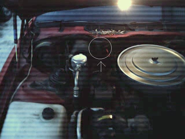

Ok. Where is the map sensor?

You can't see it real good in this picture but it's in the circle so at least you'll know where to look.
Steve

Make sure the sensor is hooked up properly and that the map sensors vacuum hose has its own vacuum port on the tbi before you replace it. No sense in buying a part you dont need because something wasnt hooked up right.

Bill, check if that MAP sensor is connected, I honestly don't remember re-connecting that. That would definitely cause problems. Its the square sensor in the picture with a vacuum fitting on the UNDERSIDE of it , and it should go directly to the throttle body.

On the rear of the TBI there's one last port, this one runs to the MAP sensor which is mounted on the firewall lip where it's illustrated in that picture above.
