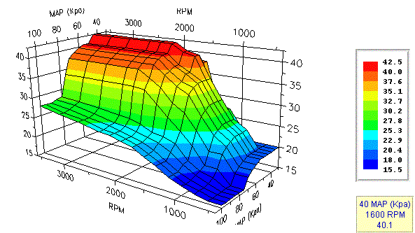

Getting a WB would be a good idea. If your AFRs are correct, you have the right ammount of timing (id take a stab at around 28-32 degrees of total advance all in by about 3600 rpm), and there are no mechanical issues, then the engine has no choice but to make power. Of course, getting to this point is usually the hard part.
I was looking at the ADS bin and it looks like theyre really agressive with how fast they bring in timing. ~27 some odd degrees by 2200 rpm. Way too early to bring it in. Id have the curve start at around 10 degrees or so at 400-600 rpm and have it linearly come up to its peak by 3200-3600 rpm. Too much timing will kill your power, regardless of whether detonation is present or not. Youll be lighting up the mixture too early and youll loose work to compression losses.

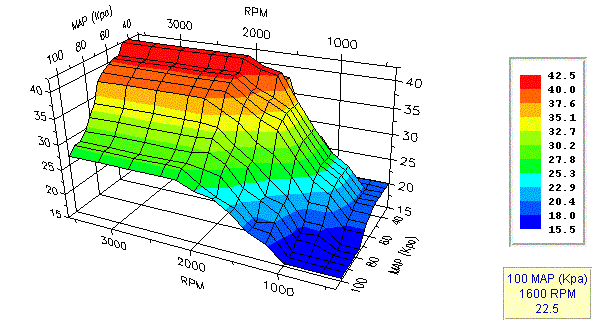

This is merely my opinion but my impressions are that its too much, too fast, too early, too soon for an engine with reasonable compression. They have peak timing in by 2k and the rest of the table looks like it came out of a plastic extrusion machine. Doesnt really look like they took the time to properly tune the car. F-...
John did a good deal for you by helping with the P/T stuff. Thats really an art form so having his help was probably invaluable for that. But, as he said, he didnt touch much on the WOT tuning. The car may run great around town but itll turn back into little miss piggy when you step on it.
First off, Id try toning down the timing a bit. Have it gradually slope up to around your desired max timing at high rpms. In the ADS table, they have the timing sloping up fast as a ****. Something like 2-3 degrees per 100 rpm in some spots.
Heres what Id propose as a sanity check (see graph). Have the table start at around 8-10 degrees at lower rpms and smoothly slope up to around 28-30 degrees at 3600 rpm adn see how it does. Try to get your 0-60 time in winaldl datalog with the ADS table and your modified table. It wont be accurate, but it should still show you a general trend.
Some WB-O2s offer basic datalogging capabilities so in the future you could datalog your speed and use it to calculate acceleration. From there, you can overlay the charts of each run and have an instant indicator of how the cars power compares to before.

Timing is only half of the battle, you still have the VE to deal with. But, I think if your thorough and make small changes/document effects, you should be able to get it tuned in nicely.

Also, I dont know if Jon changed your BPWc (Im assuming he did, but Ill ask anyway) but if its at the stock value, youll be pig rich with the stock commanded AFRs. It should be ~109 with those injectors. Confirm this, though. I just did it off the top of my head.
Edit: Also make sure your base timing matches whats in your prom. And, if the BPW has not yet been set, back the timing off first before you reduce the BPWc as a precaution.

Dim, you're forgetting a few things.
Take a look at the ads PE SA. It's still 8, then look at their initial SA, it's 0. The cts and tcc sa tables are stock and 0.
So at WOT, he's got 27+8+6 = 41 degrees of timing under PE. I've eliminated PE SA and fixed the initial SA. There is no reason on Earth that he should be slower in the 1/4 now that it's just 2 degrees shy of tickling the knock sensor.
