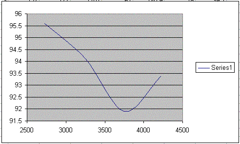

I also found the following in the one log I looked at... Below in the table, I plotted out the absolute pressure in the intake vs. rpm at high load. The lower the pressure, the higher the airflow. One thing I can say is that the stock tbi and to some extent the air cleaner are building some vacuum so theres a restriction there. Its like running at altitude.
More importantly is the shape. Your airflow is peaking really low. I would think it would be safe to say that as the pressure rises up at higher rpms, your making less power there and the lowest pressure probably ocurs around peak horsepower output. This means that your peak power output is likely below 4000 rpms. A tad low for your setup. Theres definatly something up. Something like a problem with overadjusted lash allowing the lifters to pump up (they WILL pump up at lower speeds if too tight), parts you got not what they where advertised to be, drowing the engine in fuel, etc.

OK, so too much fuel, not enough air and check the valve lash.
Well I can adjust the fuel, I can go to an open element and take off the dual snorkel, and I will check the valve lash.

as for the airflow, Id probably say its the small tbi more then anyhing else. People have run 13's through the dual snorkel to it flows ok.

That proves that something in the intake is restricting the airflow. 91kpa when baro was 99.
Also, you'll notice the SA is a little funny, it's because he's getting some knock retard with 33 degrees of timing. We need to take out more timing and DEFINATLY lean it out. The narrow band mv is pegged which is a good indicator of being too rich.

azvolfan, was a dyno graph ever posted? I don't recall one. The MAP vs. RPM graph that Dimented posted is quite interesting. I checked the ALDL stream and the MAP and RPM are output next to each other. This is important as there would be little delay between the two values.

Originally posted by 90RS305
click on it
click on it
Jon, didn't know you had a Lockers setup on Bill's car. All the difference in the world. At the initial pedal mash the O2 goes a little rich then drops lean. If using a '8746 (correct?) will need to add to the MAP AE duration. Decrease the MAP AE filter value at the coolant temperature in use. This will extend the MAP AE duration. If a '747 then can also extend the TPS AE duration. I prefer to work with the TPS AE before the MAP AE. Too easy to drown an engine with delta MAP terms (think low RPM). Don't have the same TPS AE cal's on the '8746 as on the '7747 ECM.
Tying into Dimented'd graph of MAP vs. RPM, the same can be seen in this graph. At about 3,500 RPM in first gear the MAP starts getting pulled down. This can also be seen by the RPM nosing over. Something bad is happening. I'd also check to see if maybe the air cleaner duct work isn't collapsing. Or maybe the duct scoops are being blocked by the hood structure (I don't recall how this is setup).
LIttle wheel spin on the 1-2 shift, cool, followed by a steady rise in MPH/RPM. Then again the MAP starts to drop off. I believe that Dimented24x7 is on to something here. For some reason the MAP starts to rise again. This doesn't make sense. First gear didn't do that. (And I don't want to hear from anyone that thinks Bill needs a 2" 2bbl TBI on this '305'
).I am thinking that the engine is all out by the 3,600 RPM mark. Either the cam isn't what it is supposed to be, or it is timed incorrectly. The Edelbrock TBI intake doesn't help either. Can always swap off to the stock one.
With the MAP increasing after 3,600 or so, that means the engine stopped pulling air. Find out why and you have the answer. Hopefully this helps.
RBob.

Ive found that with the stock tc, it flashes around 1850-1900 rpm behind a decent motor. The stock TC is alot better then my junk TCI staturday night special. That one stalls higher, but feels like crap and wastes power. The difference is profound when the TCC locks up at 90 MPH+. The stocker should do ok with that cam. A better one would help the response, but at this point, figuring out why the motor is doing what its doing is way more important.
I was looking at the lockers and the plot of the rpms in first gear. It seems like after 3000 rpm, the rate of acceleration suddenly changes. The slope suddenly reduces. It reminds me of when I first got my 'Hecho en Mexico' 350. They way overadjusted the lash and at 3000+ it would nose over and get this awful roaring 'WHOOOOSSHHH' sound in the exaust as the charge rushed out during the compression/power strokes. Incidentally, I suspect it burned at least one valve. I have a loud pop/tick exhaust noise at the same speed as a single cylinder firing and the #6 exhaust primary will glow at the drop of a hat whenever something is amiss. Doesnt matter much to me, though, as there is a set of new vortecs due to arive at my doorstep soon.
Im not saying that the valve lash is the problem, but it rises pretty high up on the list of suspects when seeing the lockers data.
