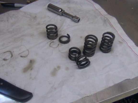

I thought that this would be a good time to remind everyone to stay away from the K-Motion junk valve springs. I bought these and installed them before I heard anything about the troubles with them. (Installed 1999)
Amen to that. You are just another person that got screwed with them. I was alomst about to buy them until I saw a few pictures like yours.

I'd stay away from cheap valvsprings in general. My machine shop told me that his suppliers says all the cheaper "z-28" springs out there come from the same factory overseas and don't get put into their respective boxes till they get here in the states (read: they are all the same). I had the same thing happen with a set of no name springs. I got the correct comp springs and actually picked up quite a bit of top end by just having the right spring pressure.
