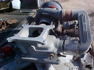

I do not own the kit yet. I will probably have to fabricat alot of the pieces to make it fit. I was just saying that I plan to model the final product after some 70s designs with newer parts. I've got some pictures from several Ebay auctions that I looked at. Don't worry they are not linked to the auction, but rather I saved them and will upload them.
Keep in mind that neither of the kits shown will fit my application.
This is what I am trying to achieve. There is atleast one Turbo van.
PS- I plan to use the nitrous control on the EBL to select between a normal around town boost setting and a RACE mode. I am thinking about maybe setting it up to run at 5 PSI, then have a solenoid control a second boost controller to go to say 10 PSI.
