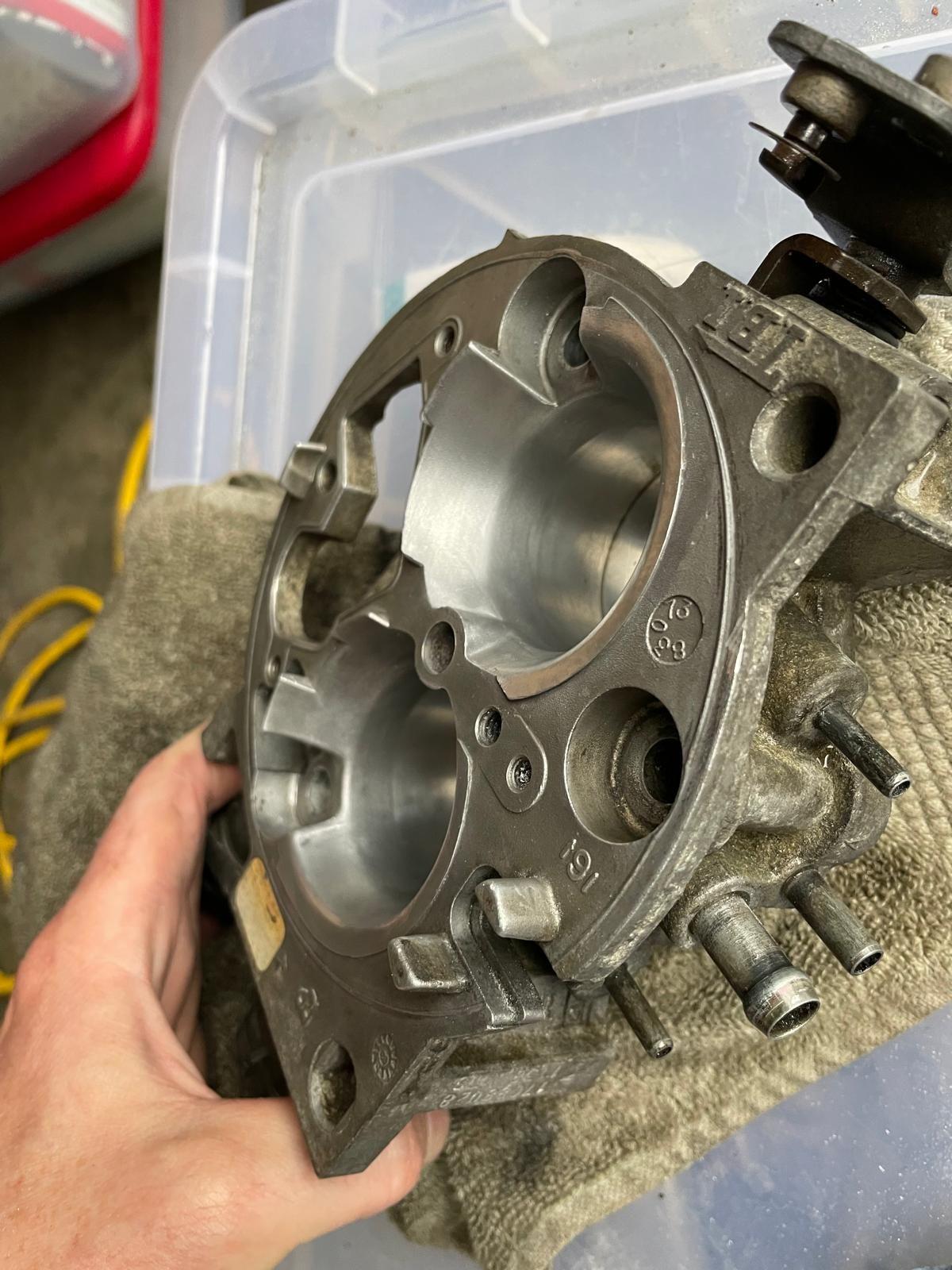

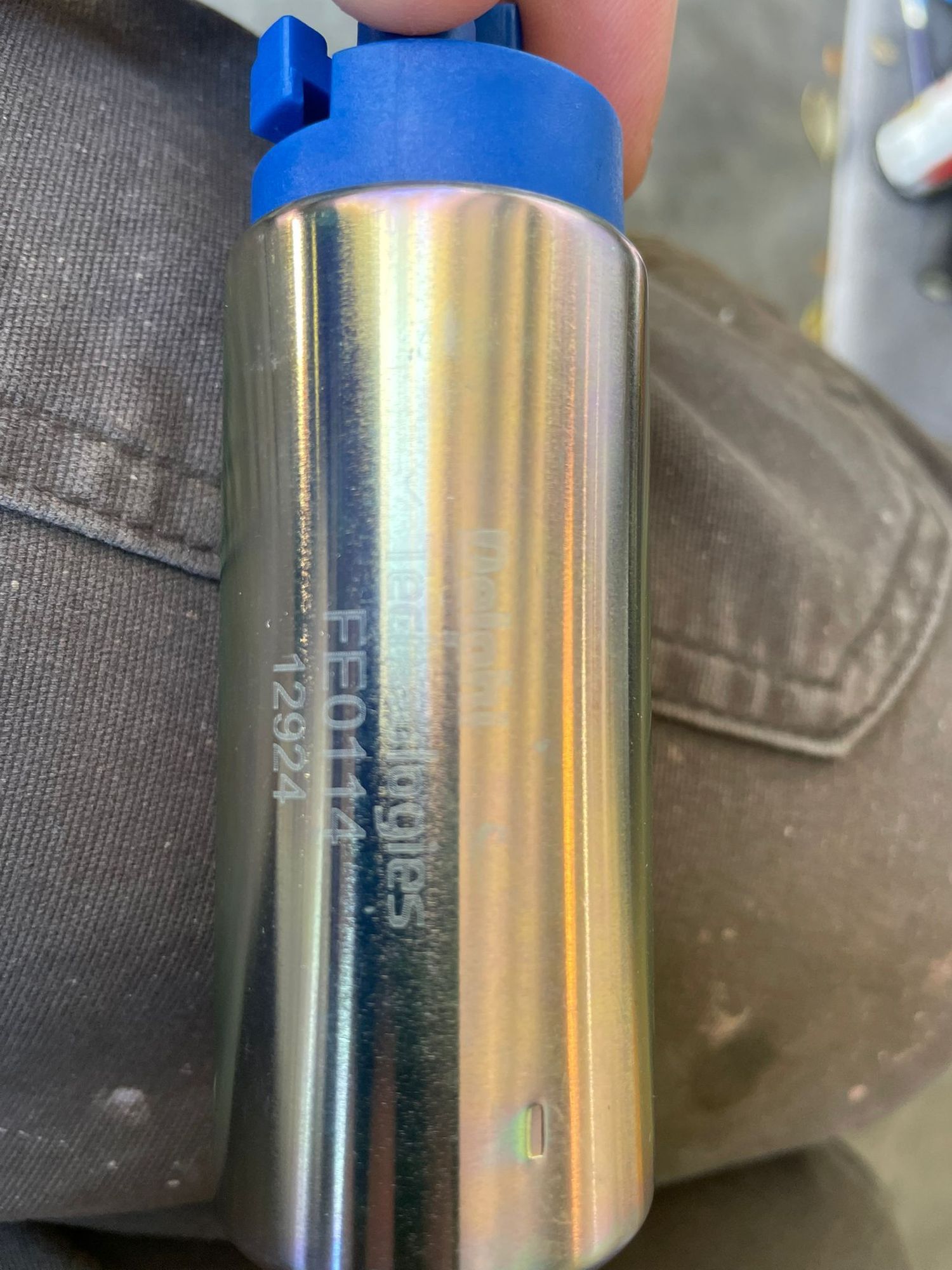

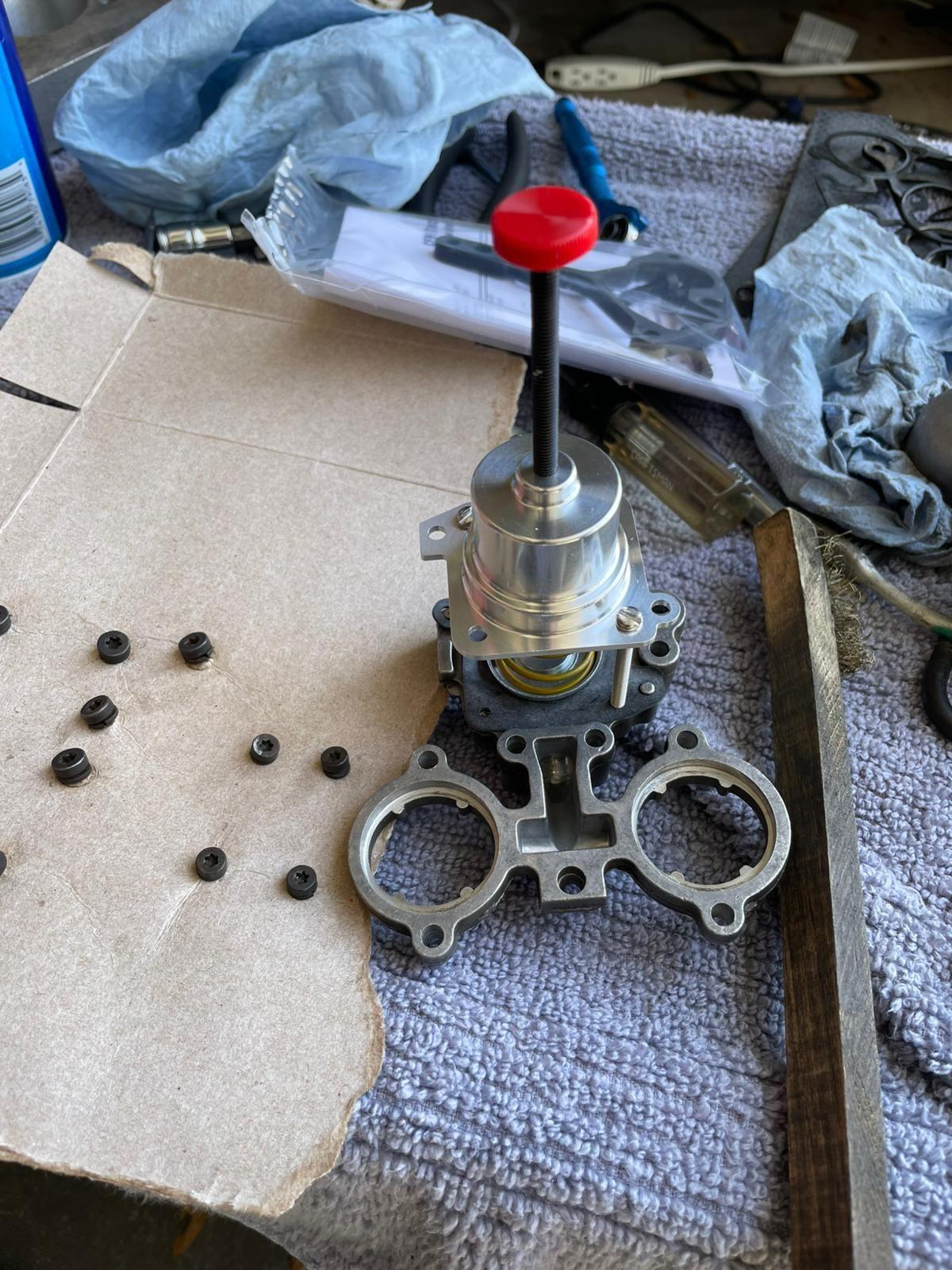

Thanks @Schurkey for the breakdown. Ended up being a restriction in the fuel filter and a failing fuel pump. After connecting the Moates ALDL cable and running Tunerpro RT I was able to see the BLM's and INT shooting way hi.
After rebuilding the TBI, completing the TBI mods to include an adjustable fuel regulator, injector pod spacer, replacing the fuel sending unit, fuel pump and fuel filter and adding a fuel pressure gauge this problem was more than resolved and finally running nicely again.
